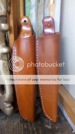

I tried my hand at a new style of sheath with a horizontal carry
Turn out I just dont like it.So I made a bushcrapt style sheath for it
It is just like all my other sheaths
But it works for me
Whats your go to sheath?

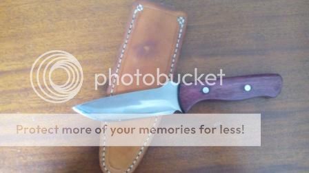

Ok help me out with that first sheath. It looks like one piece of leather that you then cut a slot for the blade? I really like the design.

@ THATSAKNIFE...That sheath is just a sandwich construction hopefully the pics will explain it.... note the retaining strap is recessed into the back leather and the back of the sheath and the belt loop is one piece of leather. (The Knife is home-made based on a design by a US Maker - Don Davis)
Thanks Brumby. I really like that folder sheath with the Bulldog knife. Cool concept.
Cool sheath idea brumby... I might have to try that out as well. Like the way you use the button strap over the piece of leather...
