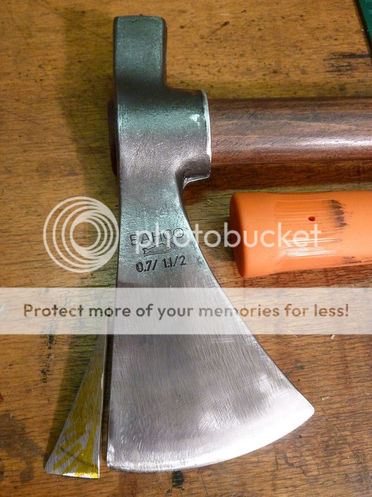

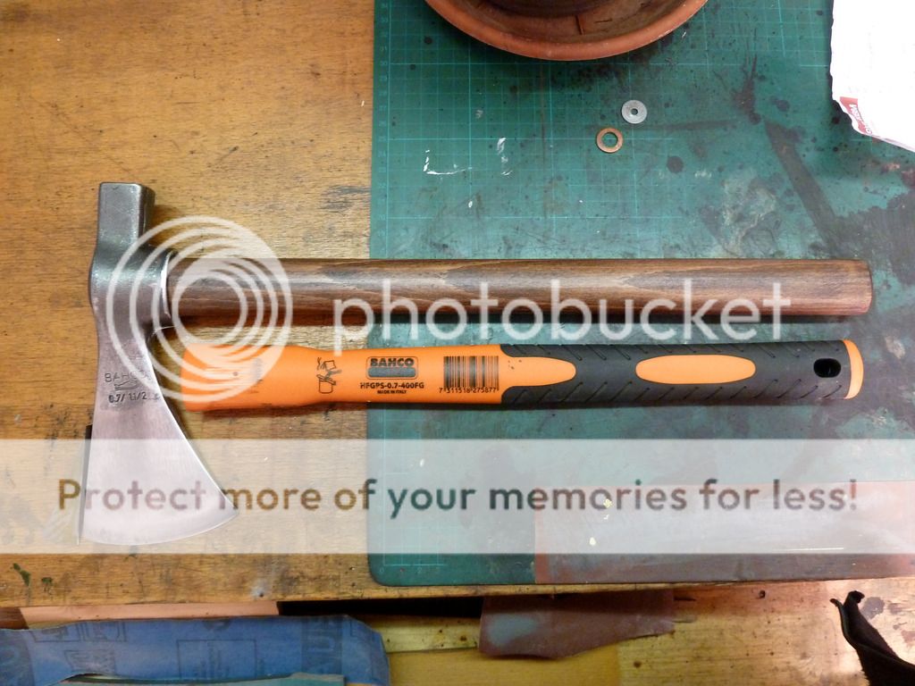

Bahco tomahawk customized

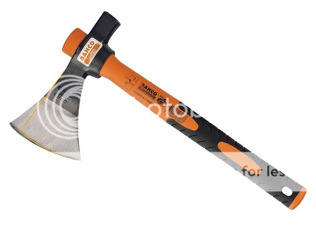

Very nice! You may also find it a nice touch to remove the forging die seam along the bit/eye collar transition zone using a chainsaw file. Improves the comfort a little when choking up under the head. The factory handle looks the same as the poly-jacketed fiberglass handles that Rinaldi uses, just a different color scheme. That particular hatchet pattern is French, but a lot of Italian manufacturers produce for the French market. Not sure who's making the heads, but I bet it could be figured out without too much digging. Should be a nice tool.

well, looks cast so i'd imagine the soft steel issue with the other hatchet they made doesnt apply. i think i need one now
Not cast--definitely forged. What you're seeing is flash from the dies.
If I had to guess, I'd figure that Prandi is making them. They produce a French hatchet of identical pattern and size, and the look of the tooling marks is the same.
