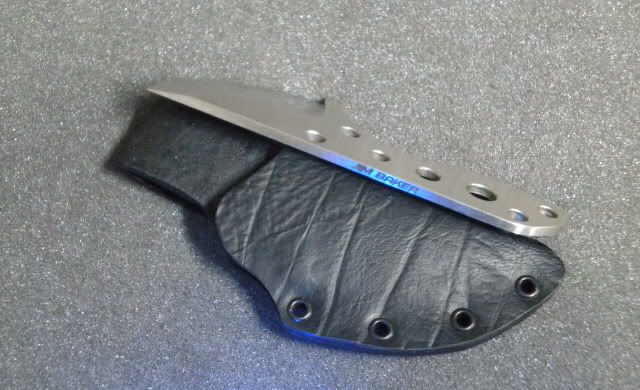

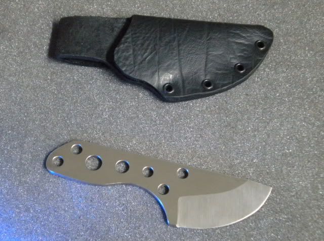

A simple, sturdy, and effective blade; this knife is inspired by a Jensen design. The zero ground chisel edge is given a very slight secondary bevel to increase edge strength- and is very sharp! The handle can also be cord- wrapped. A simple but effective leather belt sheath completes the package.
SPECS:
Thanks for looking!
SPECS:
- 2 1/2" blade, 5 1/2" overall
- 1.5 " wide (max.); 1/8" thick full tang build
- 440C blade steel; Paul Bos heat treat at 59-61rc
- Curved cutting edge is great for skinning
- Chamfered holes for cord wrapping, lanyards, or securing blade to a pole or stick
- Black leather belt sheath
Thanks for looking!
