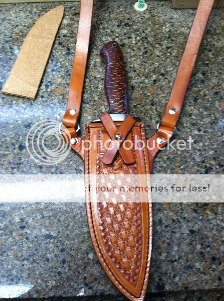

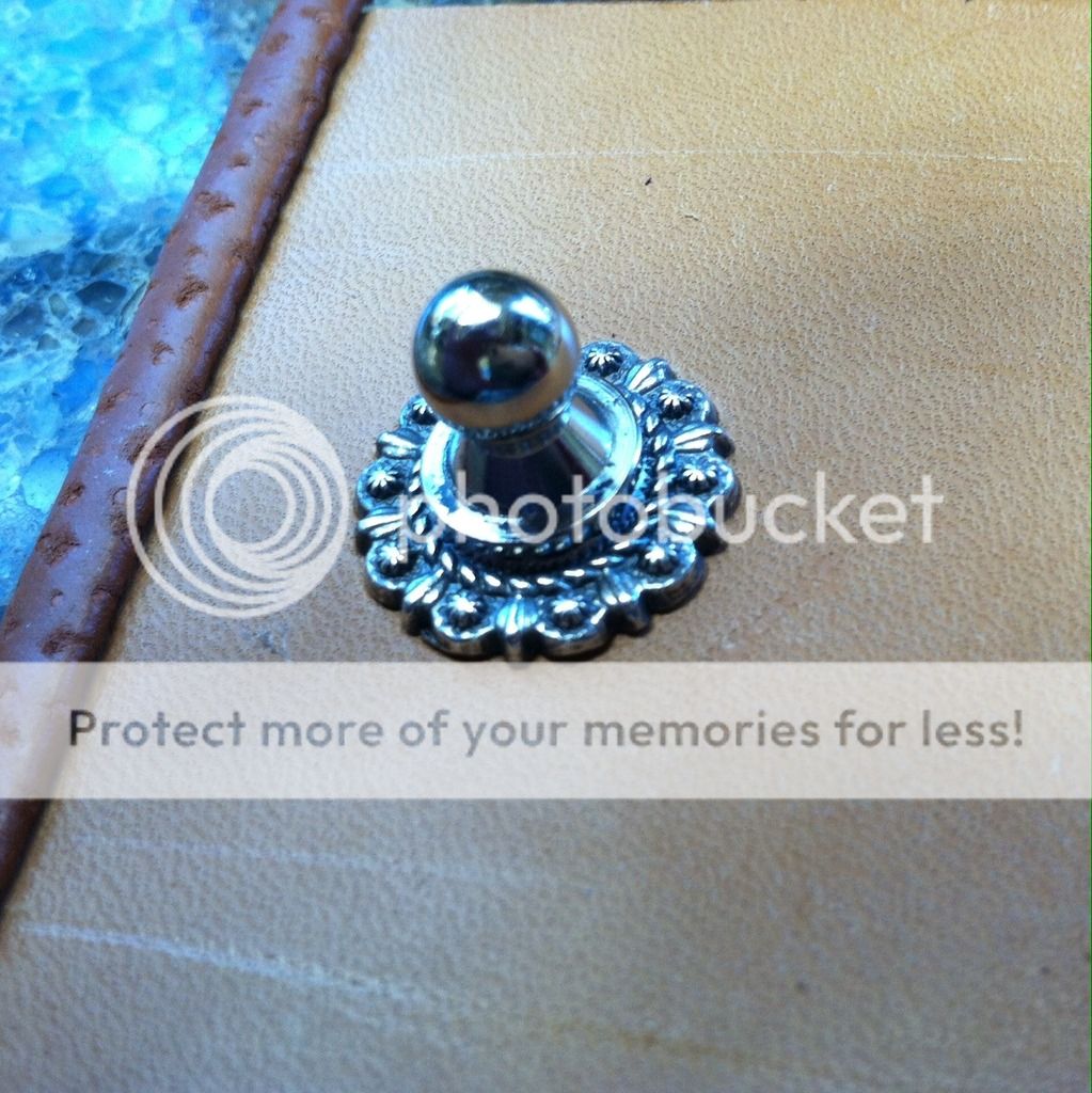

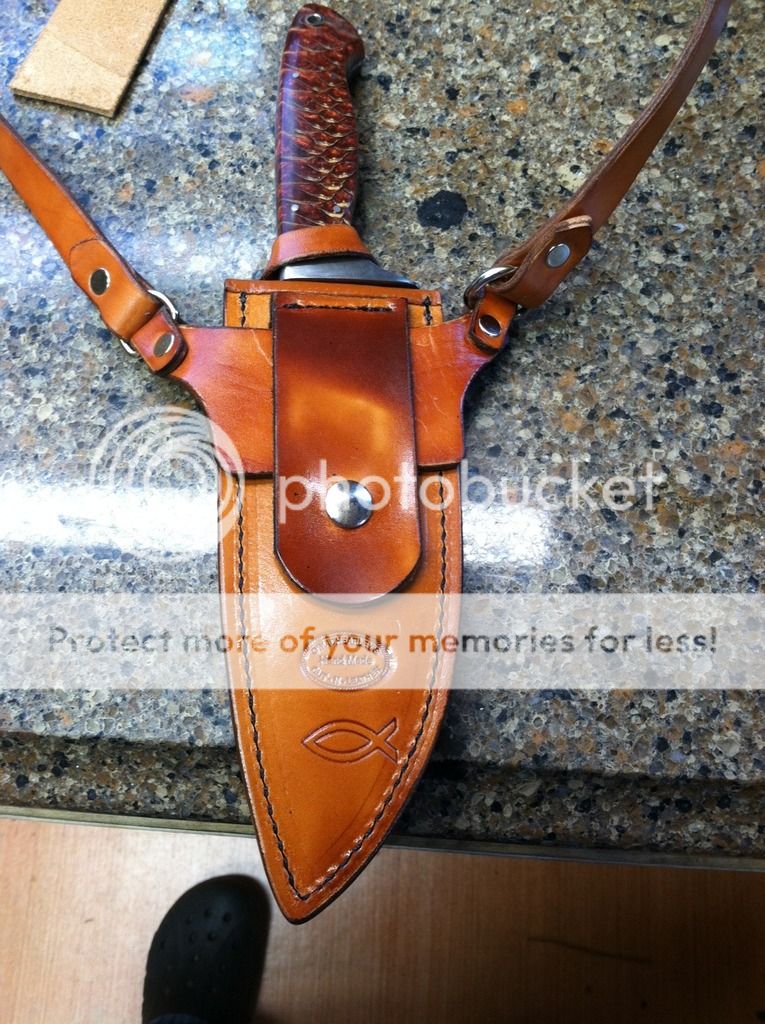

[Here is my version of a Baldric Carry rig. You can shoulder carry it, or use as a conventional belt carry. Also a neat wat to dress up a button stud. It is a concho under the stud. You can use the new themed studs also. Just take a French edger to the underside of your punched hole to relief it a bit.URL=http://s1273.photobucket.com/user/omachearleycustomknives/media/IMG_4571_zpsx9uzyvfu.jpg.html]

missing a square bracket and some line breaks on the first picture ;)
but seriously, this is awesome. don't you nee some kind of retention on the lower tip for the draw in should carry?
really like the sheath, it looks great. btw, are the grip scales resin cast tree cones?
That's a sweet rig!
I was thinking of making a sheath for baldric and belt carry for a bit now, but still tweaking the design.
Pine cone scales? Wow. I missed that at first look but those are exquisite!
