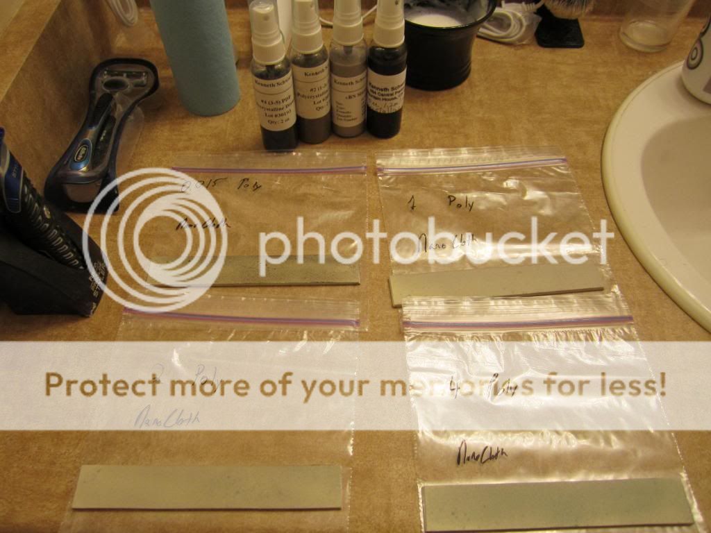

When I get in a batch of strops I am loading 5+ strops at a time typically , so care needs to be taken in order to not cross contaminate coarser abrasives onto finer strops , an irreversible error.
-I start by cleaning the work area , wipe down everything with a clean damp rag.
-Then lay everything out and labeling it all (strops , and individual baggies)
-I then wash my hands and arms , and put on clean clothes.
-Then wearing gloves I start with my finest strops and move onwards to my coarsest. That way any cross contamination is of a non issue. I handle the strops only by their edges , never the stropping surface itself.
-Allow to air dry
-Put each strop in its corresponding plastic baggie.
This is solely to stop large abrasives from contaminating finer strops ,however I doubt there are 15u particles floating around the air in my apartment. Even if there were , would they be hard enough/abrasive enough to scratch steel? I guess not as all my strops would be leaving 15u scratches instead of the much finer scratches they do leave.
