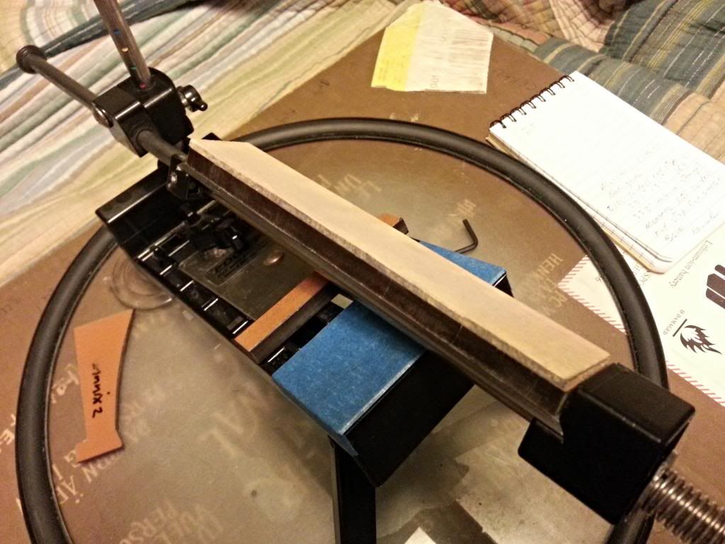

Well today was almost a success. I was sanding the back of the strop to make sure all was good an flat. Then the piece of balsa came off, literally just slid off.
Got all the glue off and straightened the blank as much as possible. I'll mill it dead flat tomorrow, but I'm going to leave the glue side a little rough for extra grip. Then two part epoxy it all back together.
Actually doing this to both balsa strops. A little heat the other one lifted right off. Probably going to do the new one when it gets here. Whatever glue CKTG uses is not all that good. (I've had chosera stones lift before too.)

Just make your own. That's what I did, blanks included.
Take a 1/8"x1" aluminum strip from lowes or home depot (if you can find a metal supply place it will be cheaper, but for one piece it's not bad). Then get you some 1/16"x1" balsa strips from Hobby Lobby or some other hobby store (ones that cater to the R/C hobbies and crafts usually have good selections, art supply stores too but they can be more expensive). Cut the aluminum in to 6.25" to 6.375" pieces (measure your EP's to get exact), then file or grind a chamfered edge at about a 45deg angle half way through the small edges, same side. Don't grind to a point, leave a blunt flat edge. Then cut 6" pieces of balsa. Lay over top the aluminum, chamfer side = balsa side. Use CA, super glue (same stufff), etc to bond together.

I am a machinist and was eyeballing some materials today. Found some slightly magnetic stainless 1-1/8 x 1/4 that I think I'm going to use.
I rescued one strop today. Got the base flat within .002 and mounted a piece of 1/4" phenolic sheet to it and the balsa to that. Re-machined the 45° end cuts of the stainless base. Epoxy everything together, did some cutting and the final product is .001" parallel and .0006 flat.
