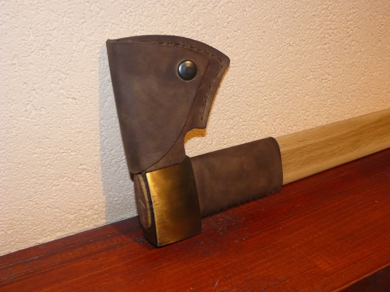

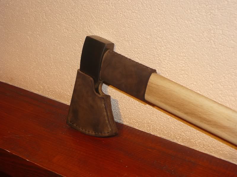

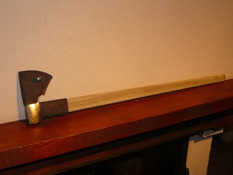

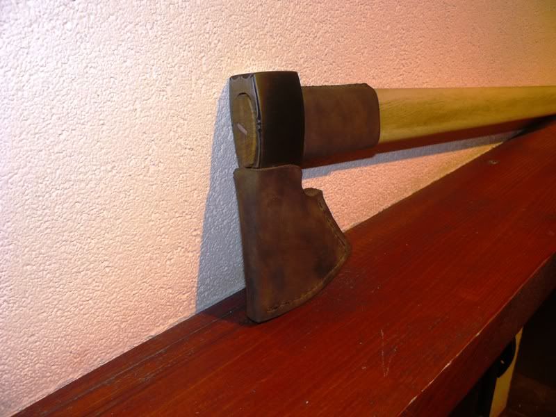

Another small, long haft hiking companion.
Here are some pict before heat treatement and final assembly.
I`ll be back when I finish it!

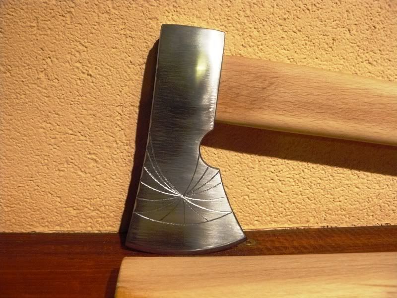

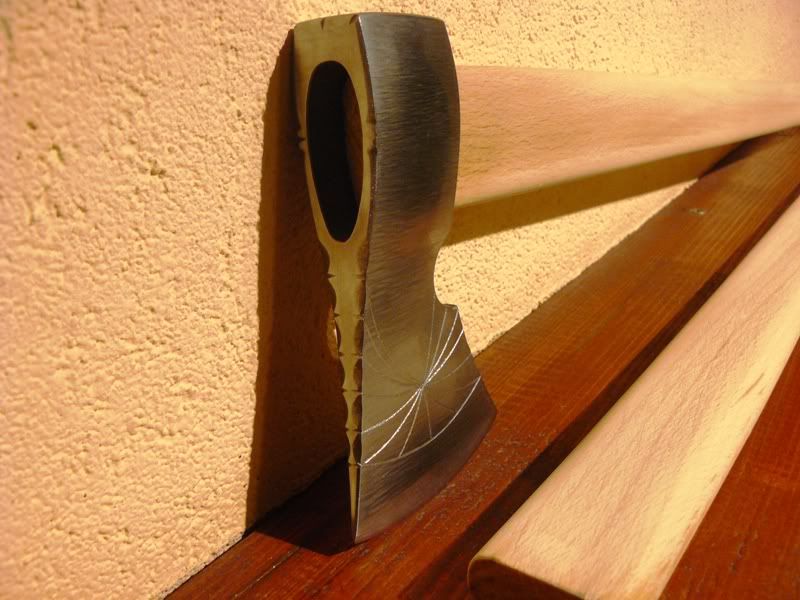

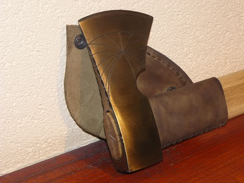

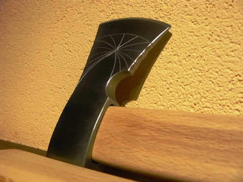

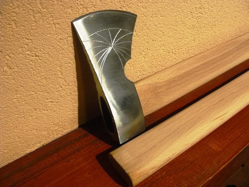

I love the 'spider webbing'. How did you do that? Milling machine or just clamp it to a turn table and use an engraver?
Sorry for late response (I have a day job:( ).
In order:
Thanks for feedback.
I used an engraver (diamond coated 1 mm point milling tool) and filework.

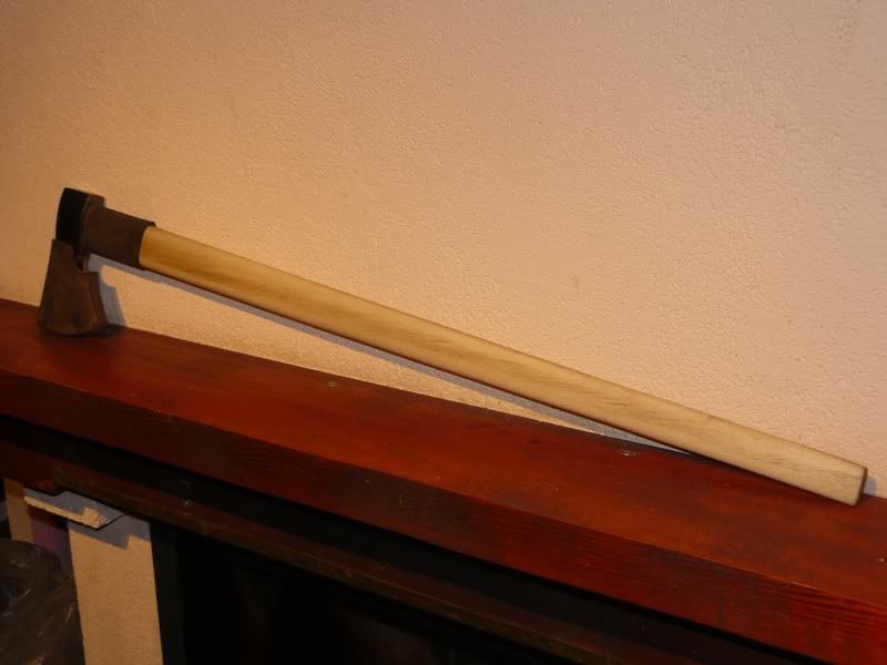

Is a combinatin of axe/hatchet/walking stick, the haft is 33 inch long (can be cut down if is necessary).
The head is 5,5 inch with a 3 inch cutting edge and about 16 oz.
They are made from good quality axe (made of tool steel) that I forge again (I keep only the eye).
After that I grind, engrave and make a new heat treatement.
