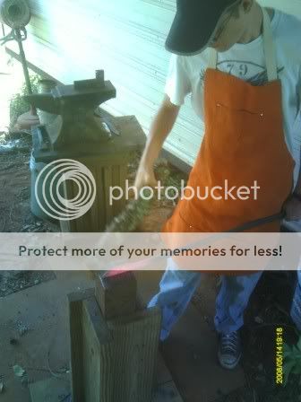

Yeppers, use the "whomping stick" to correct banana blade syndrome. Just grab a piece of wood that will stand up to the abuse. I use pecan logs, I've used part of a pick handle, wooden bat, I've seen 4x4 with a handle cut into the end. Here's a picture of my student using one to correct the blade.
