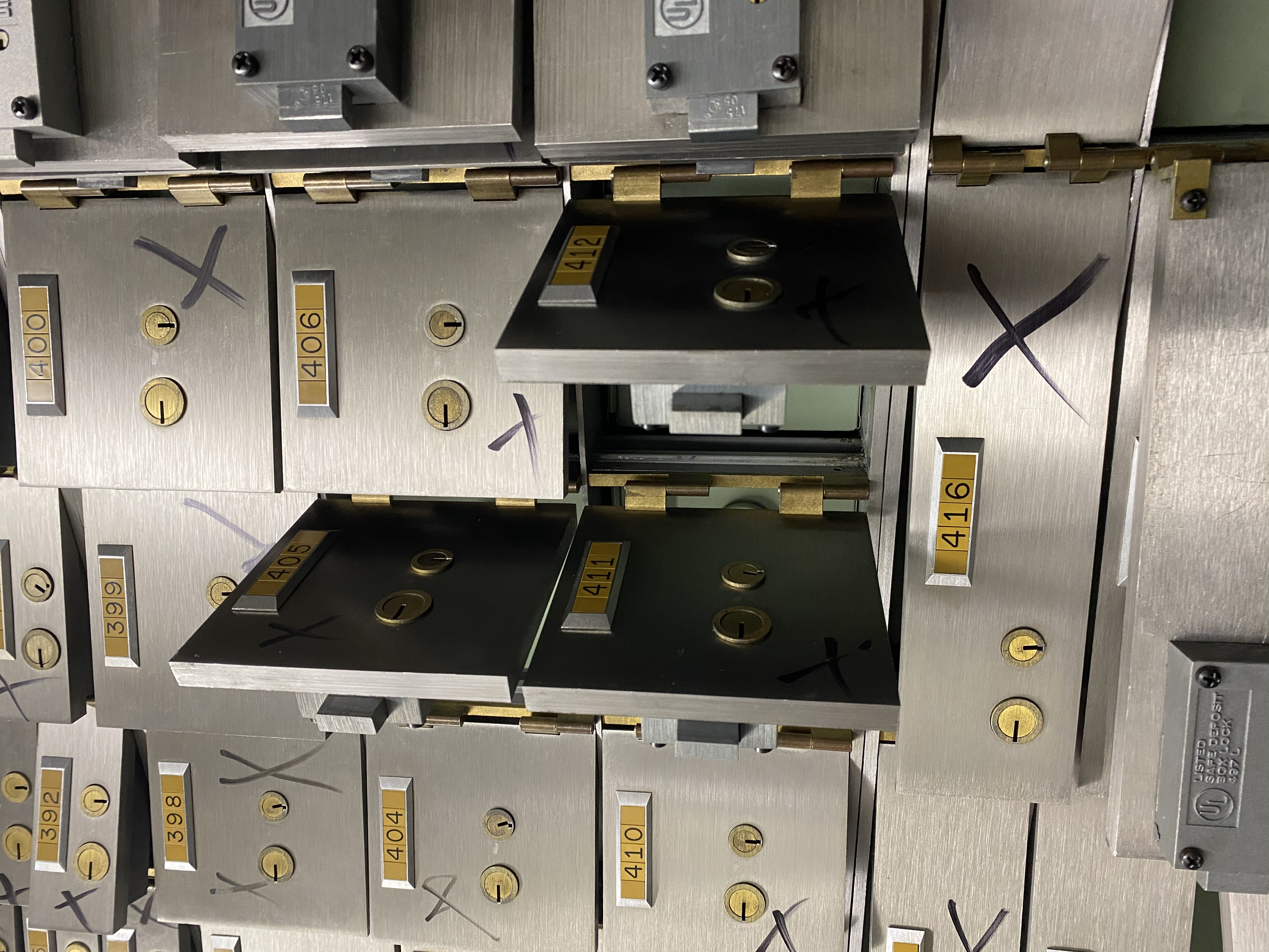

Gooday all,
I am demolishing a bank vault and the safety deposit box doors look like nice portions of steel. Any insight as to the variety of steels that could be used here? Is this salvageable to any degree desire?
(obviously I’m aware of the lack of data as to contents of elements) cheers
Probably a low carbon high alloy steel, maybe similar to AR500. Not really usable for knives. You can spark test some pieces and see if they have much carbon.
It could be used for fittings - guards, bolsters, butt caps, etc.
As a final suggestion, layer it with W1/W2/1095'52100 and make damascus.
Sam may be right about modern vaults. However, I have a vault here at the store, and had one in a previous store. Both are steel with concrete filling.
I asked my safe guy and he says they are just plain steel with concrete. He had no idea what type steel.
I have watched the alarm folks drill into several safes and the two vaults and it seems to drill like mild steel. Certainly nothing extra hard.

Can you stick a magnet to it?
I shall see tomorrow morning! Re:Magnet
Sorry it took so long to get a photo.
I'd remove that all carefully and try to resell to locksmiths on a wholesale level.
Each lock is worth $ intact.
they are probably quite modular in how they stack up and mount.
or remove in sections if possible and sell a few to the hipsters!
