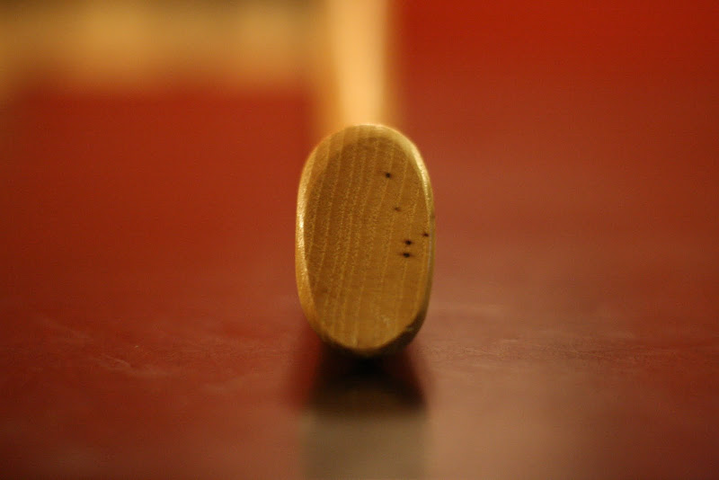

The handle is 36 inches in length, and has nearly perfect grain. It has been a long time since I have seen a full size handle that is such high quality.
