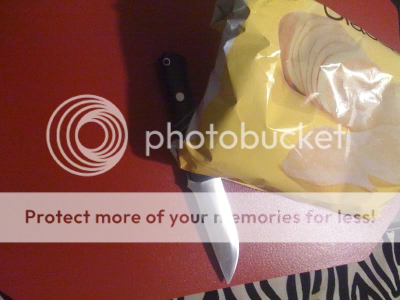

These are the only chips I have on my Bravo 1 A2
but all joking aside, the A2 Bravo IS hard to beat!
