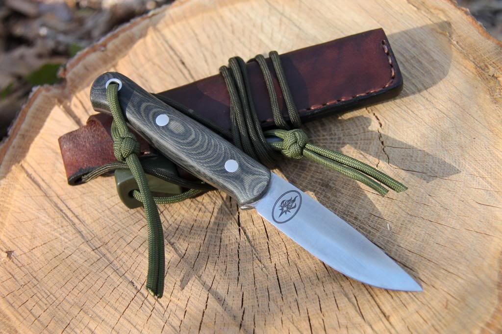

In February 2013, I received a sample of a Bark River Knife and Tool Ultra Light Bushcrafter (ULB) to use. Mine came with a Great Lakes Leather Works Sheath and Matte Green and Black Micarta Handle.

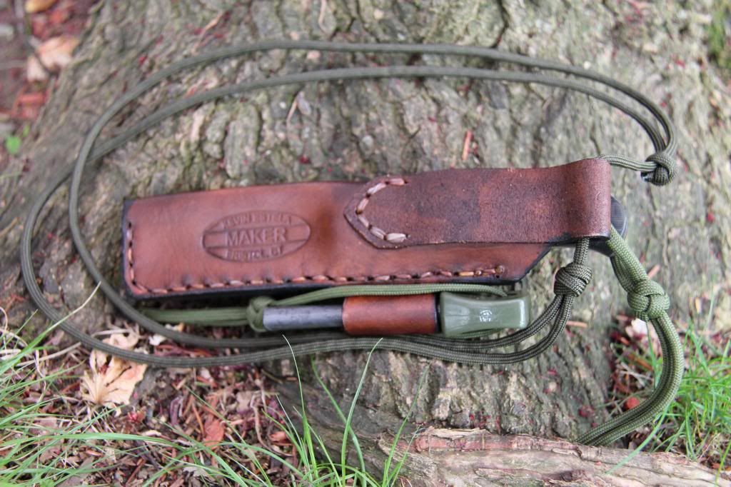

As with most of my knives, I made my own leather sheath for it that has a firesteel loop and a deep pouch for maximum protection while carrying it. Once I had my knife, sheath and firesteel combination set up, I began the testing process. I refuse to write a review for a knife I do not put ample time in working it out. This knife was carried regularly for approximately 3 months at the point this review was written and has been used in place of my usual folding knife carried around the clock. It was carried while teaching a weekend long emergency overnight survival course in winter conditions. It was carried in my car for occasional tasks and while on short hikes in the woods with my camera.

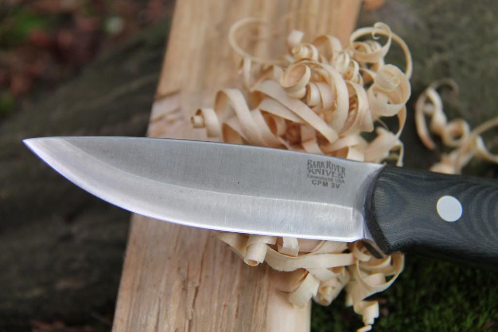

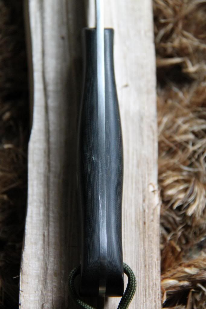

I’ve been asked how this knife compares to other popular knives meant for light and ultra light use. I can’t place the ULB and a Mora Clipper (perhaps one of the most popular models of this brand and extremely common in Bushcrafting/Outdoor community circles) in the same category but I can make comparisons between them. One is full exposed tang and the other is hidden partial tang and one has the BRKT “Scandivex” grind and the other the Scandi flat grind. The ULB has a deceptively light feel to it much like many of the Mora models. This is accomplished through skeletonizing of the handle. It is a scant handful of ounces but retains the strength of a full-exposed tang knife. While teaching survival courses and while attending seminars, I’ve seen many Mora knives break at the tang through the composite handle when improperly used. I put more confidence in using a full-exposed tang knife like the ULB over a hidden tang. Both can be destroyed with improper use but one is more resistant to accidental or negligent abuse. The ULB has a head up on the competition with the incorporation of 3V steel that is proving to be much more wear resistant than A2 or any of the steels in the Mora lineup.

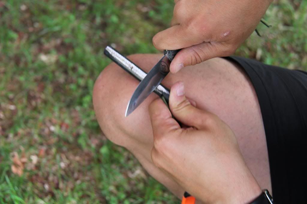

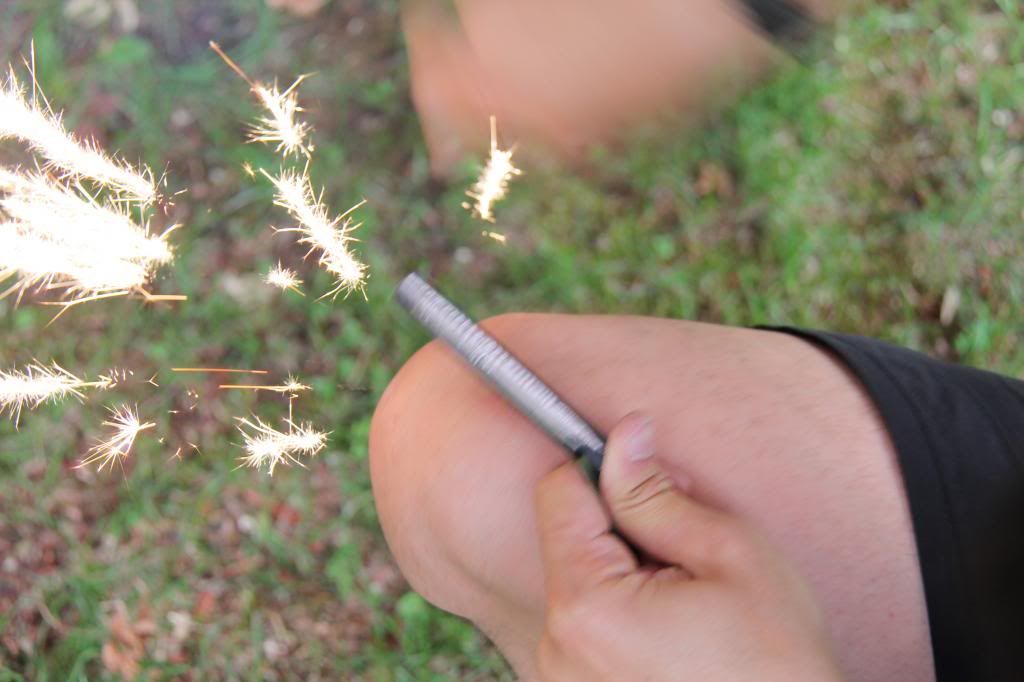

I used it for food prep on the occasional hike and for fire steel scraping with the nice near 90 degree spine. I must say the 3V steel throws a great spark and especially on my preferred SOLKOA ferro rods.

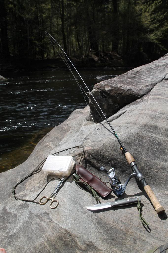

During the spring months, I used the knife while fishing. I found my hemostats clipped nicely to the neck lanyard and it took no time to remove the blade, clip a line and resheath it.

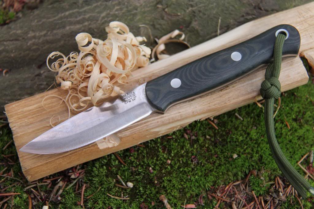

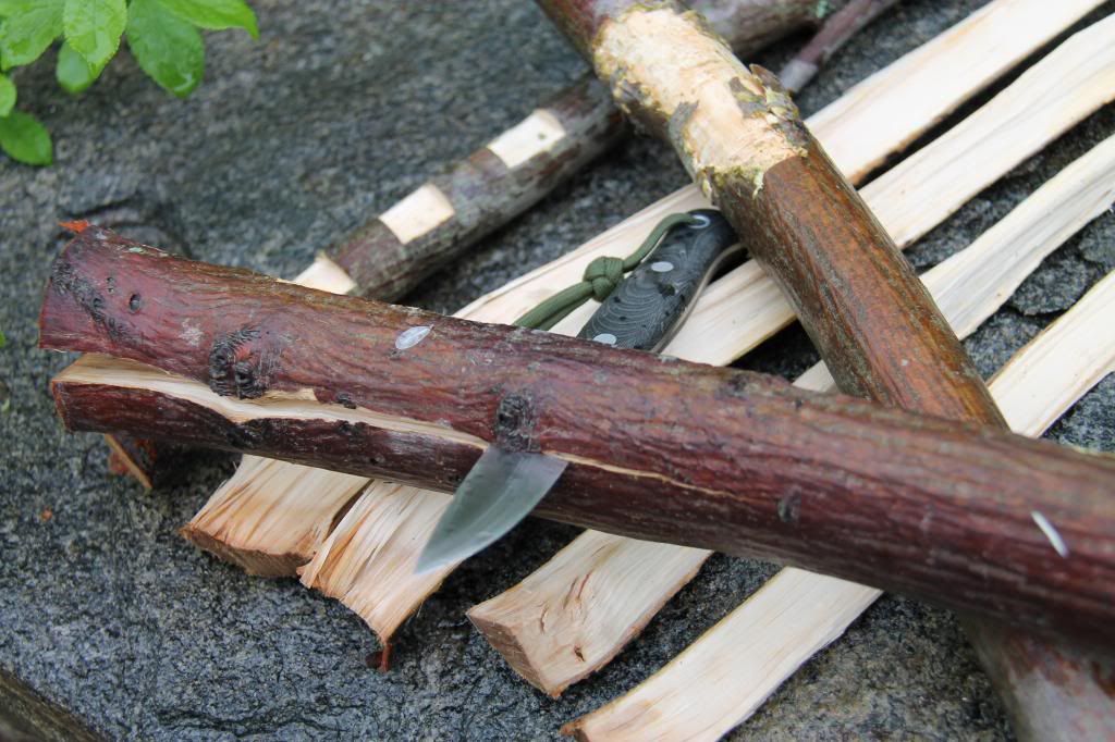

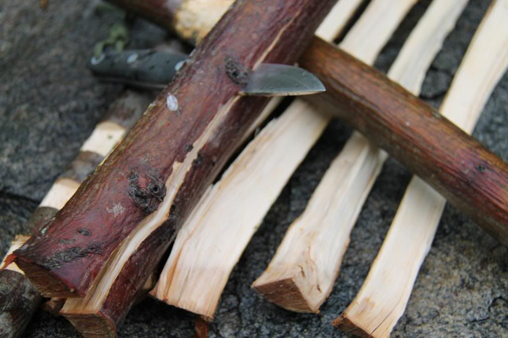

I used it for batoning cross grain in wood as well as with the grain. Splitting wood with tip first batoning was also no problem as micarta is harder than the baton I was using and at no risk of being damaged. Generally speaking, this knife is capable of 99.9% of the tasks out there. The last .1% are the tasks basement bushcrafters are going to claim should be possible. I haven’t seen too many metal vices or concrete blocks in the woods so I’ll just dismiss these so called tests…again.

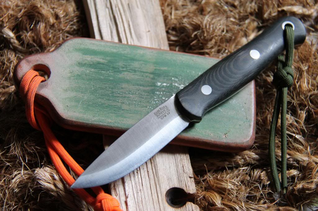

An added bonus of this little blade is the ease of sharpening it. Let’s face it, big knives are fun to use but a pain to bring back up to a good edge with a field sharpening kit. With a smaller blade and thinner stock, there is less material to remove to achieve the desired sharpness.
I was able to use the BRKT pocket hone with some wet/dry sandpaper (800/1000/1500/2000 grit) then finish the edge with the black and green compound.

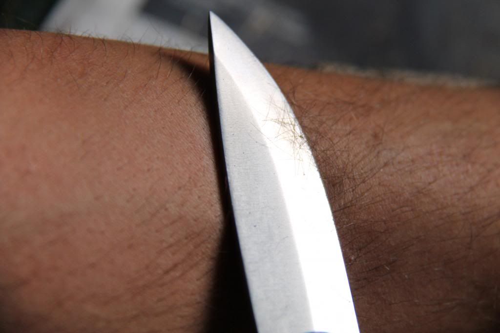

It went from working edge to hair popping edge quickly. I know a review of a knife will be thorough when I need to sharpen it and hone it regularly. This knife was a real treat to use and the pocket honing kit was just the right size to keep it running flawlessly.

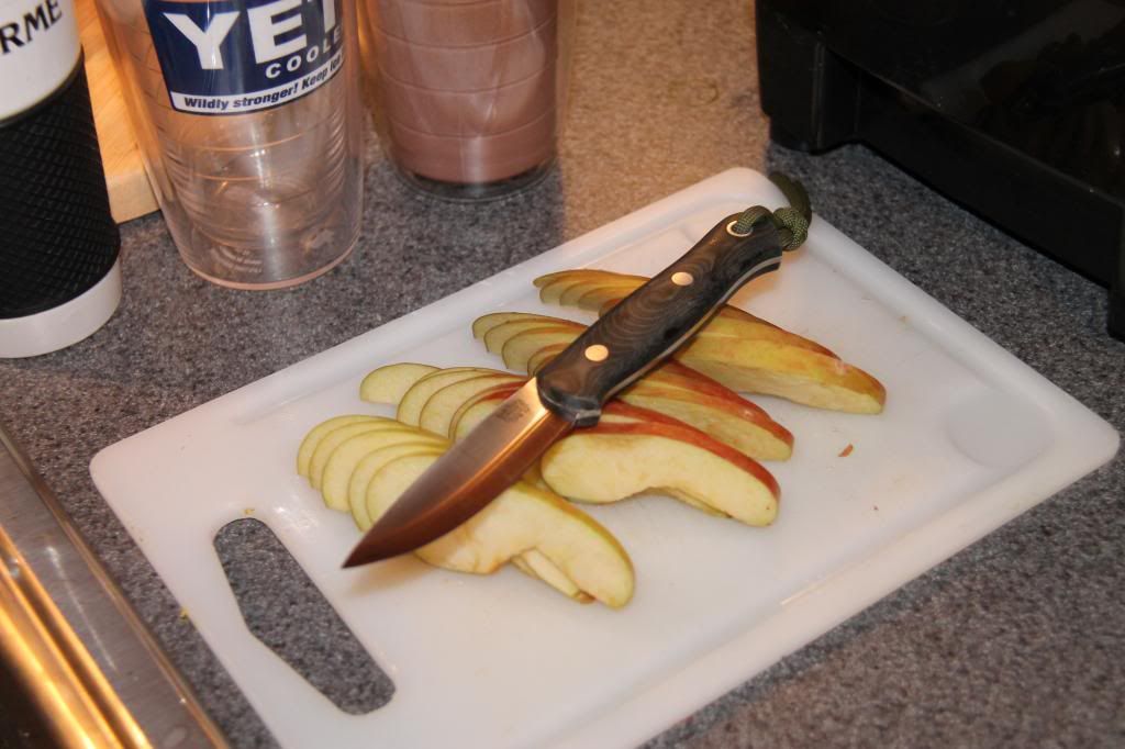

Rounding out my test of the knife was general kitchen use. Rather than reaching for my Global Knives, I used this little guy for cutting up avocados, pears, apples, lettuce and various meats. CPM 3V takes a nice patina with use and my ULB is now a light battleship gray color from contact with acidic foods. Of course at less than 3.5”, the knife worked better as a paring blade than a main kitchen knife. The blade’s attributes contributed to the pleasure in using it. I found the handle comfortable in extended use and the generous belly of the blade allowed for my hand to be out of the way when slicing through food.

What's the Logo I spy on the obverse side of the Blade?

I've been pretty close with the Bark River Company for some time now. I have been to the shop to make knives, over to the owners house to have dinner on numerous occasions and have been out to Michigan to teach survival courses/clinics at company sponsored events. They send me knives to evaluate. With the various contacts I have in the knife industry and connections with a handful of companies, I recommend BRKT above all others for the quality of their knives, customer service and performance. I'm affiliated with them in the sense that they often ask for me to give them an honest review. Most of the time, I like the knives, once in a blue moon I have some suggestions to improve the design.
BRKT will be producing a knife this summer for my charity fund I established. Those knives will have my logo as well. Whenever BRKT sends me a sample, they put the logo on it.
As far as the scandivex to full-height, it won't cut as efficiently as the full height grind because of the shoulder. It is still stronger than a standard flat grind "Scandi" and will not bind as much in wood. It slices well regardless and is pretty easy to learn the feel of it when making fuzz sticks, doing fine work, etc.

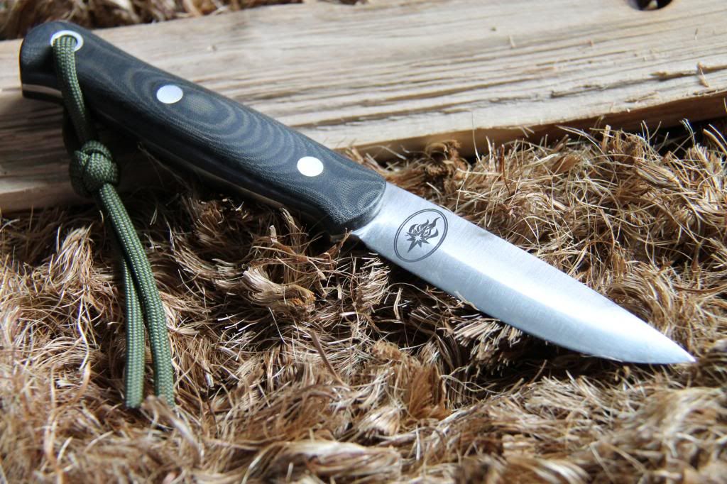

I've been eyeing this one for a long time now, been squirreling away pennies to pick one up this year. Can you tell me if my eyes are deceiving me, or is there a little belly/recurve to the blade? It looks flat to me in your pictures, but in others, the blades seem to have a little recurve going on.
The blade is definitely flat but it does have a nice belly to it. Unlike the original woodlore knife, this knife has attributes which allow for better use as a skinning blade and better slicing too. It really is a great all around blade.
Not much I could add to this, but thought I'd post a couple of thoughts. My older son, who lives in OKC, bought one of these and had it shipped here, so I've had a chance to handle it a little (but haven't cut anything with it). I have a Liten Bror, which I like a lot. As you'd expect, the balance on the ULB is very different, given the thin stock and the shorter blade. The balance is definitely centered in the hand. I expect it would be very lively in the hand, and that would be reinforced by the relatively thin bladestock. This one is probably a very respectable slider, in addition to being a good light bushcraft knife. The handle is nicely proportioned and gives up nothing to comfort relative to the Liten Bror. A very nice knife. :thumbup:
