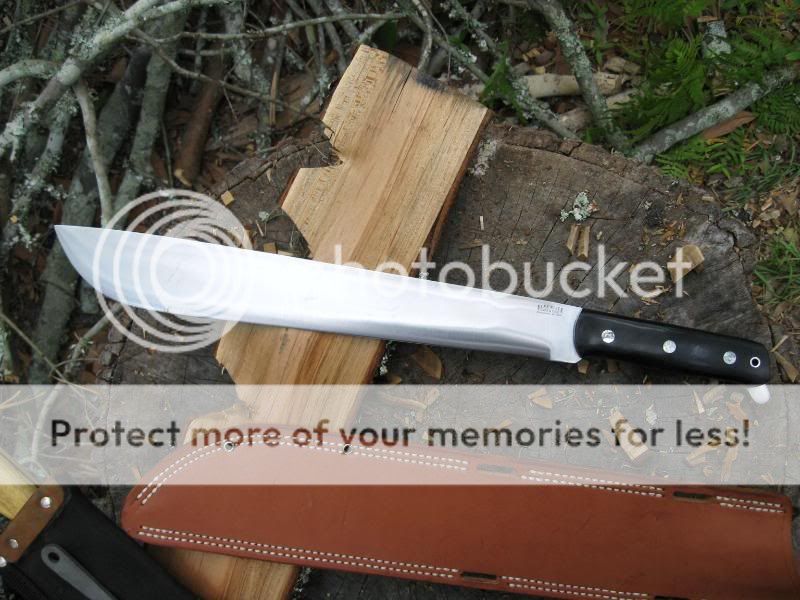

Bark River Knife & Tool has come out with a machete for knife lovers. If you think of it as just another machete, the nearly $150 price is very high. If you think of it as a really big knife, with the quality, edge, and handling of a Bark River, then it is priced similar to much smaller models. Bark River took Ontario blades in 1095, reprofiled the tang and the blade, shortened it by about 4", moved the cutting edge back nearer the handle, gave the blade a slight drop point, and attached a nice micarta handle. Then they gave it the famous BRKT convex edge. This machete feels great in the hand with plenty of room for even my extra large paws.
It comes with a quality heavy leather sheath by Sharpshooter Sheath Systems. It has a belt loop on the back and slots for securing the sheath to your pack. The machete is about the size and heft of my Tramontina Bolo, with a handle that fits my hand a lot better.

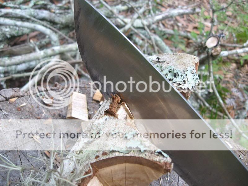

The Tram bolo is a favorite of mine, so I wanted to see how this Cadillac of machetes measured up. Well it took out this hard dry maple limb in one chop.

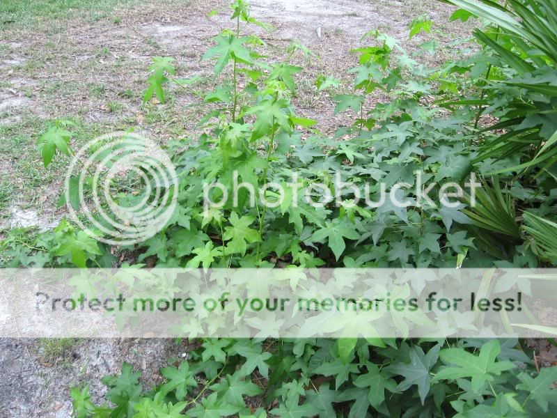

Then I used it to cut back some Sweet Gum suckers.
Mmmm. Sweet gum salad. The BRKT handles light and fast and make this job fast and easy.

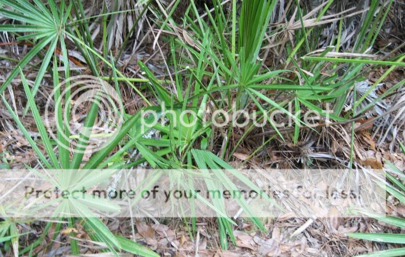

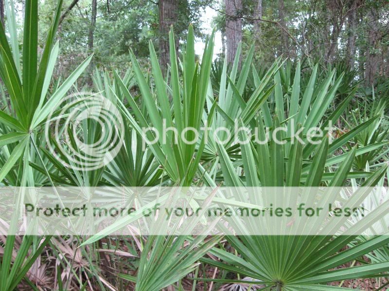

Then it was on to the palmettos.
Like cutting stalks of celery.

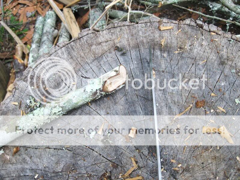

Now some chopping on maple again.
The BRKT chops as well as my convexed Tramontina bolo.
Maybe better. I know it's not everbody's cup of tea to pay this much for a machete when a cheap one will do. But I sure like the Barkie.

spine shot please?
Oh, I knew I forgot something. The BRKT is .12" thick. Just a bit thicker than the Tramontina. And the blade is just under 14" long. It weighs about 14 oz on my scale.
