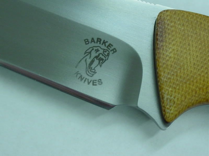

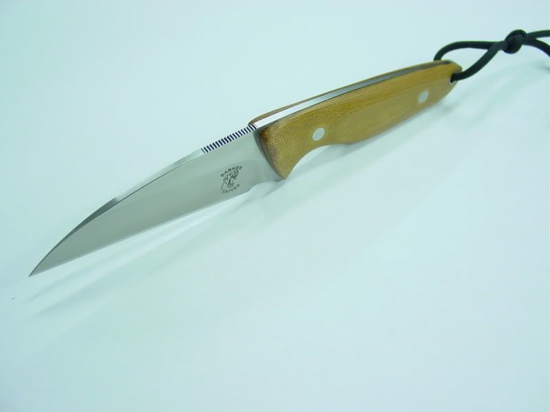

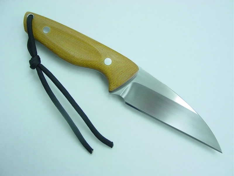

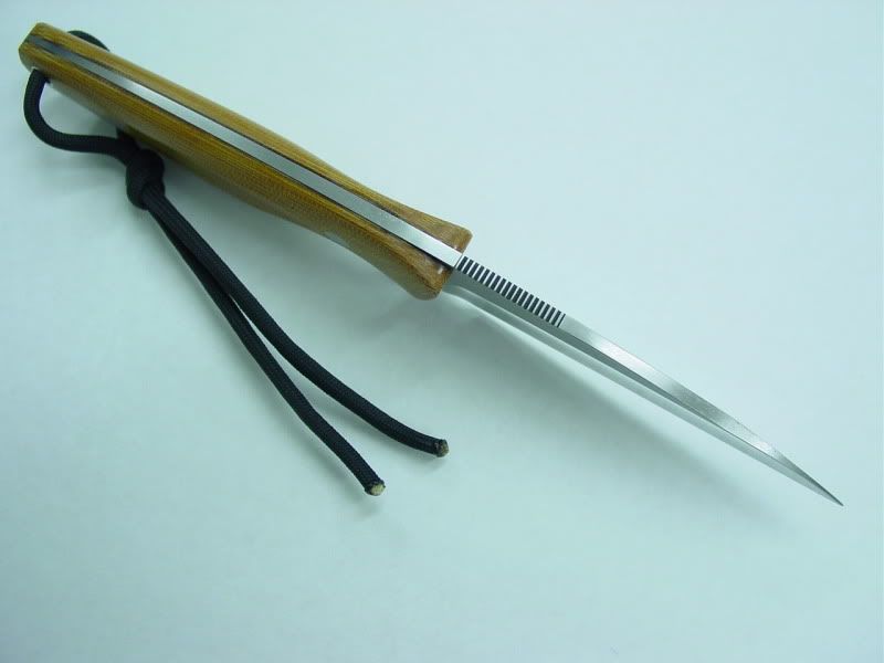

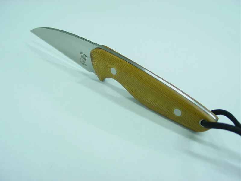

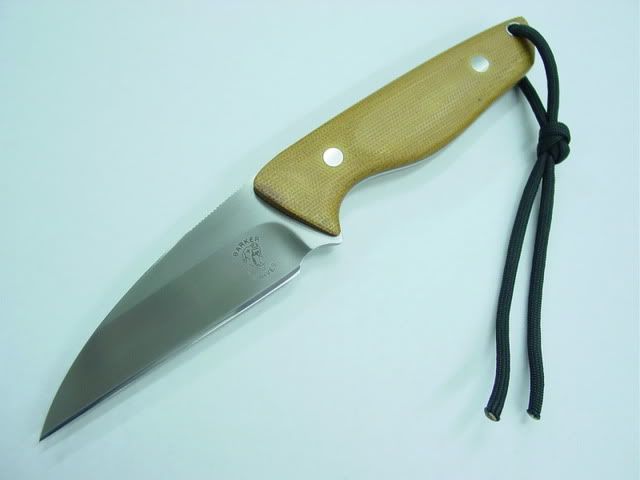

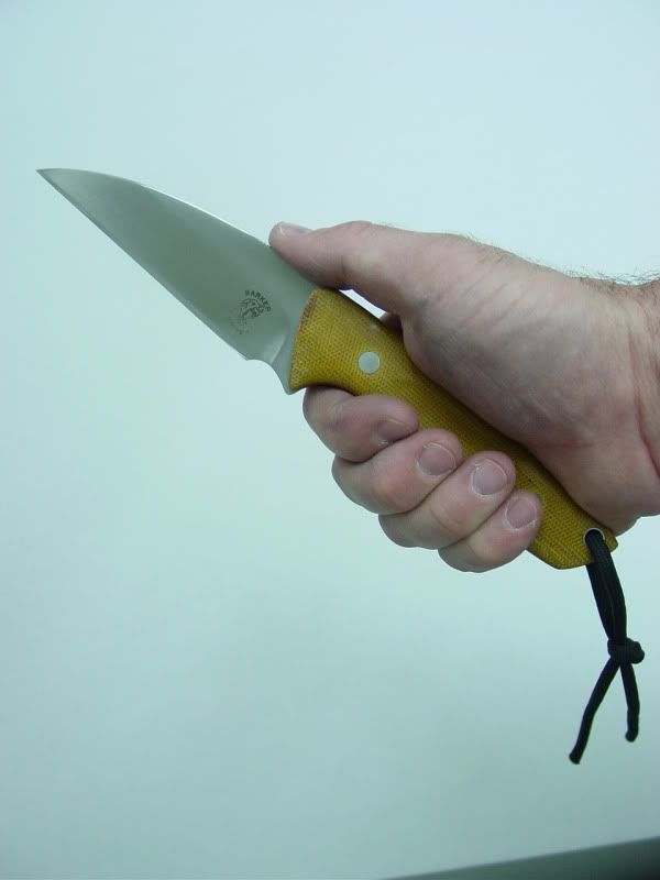

The Fang is my wharncliffe design. This Fang features a 3.75" cutting edge. The blade has a satin finish and is made of CPM D2 0.135" thick at the ricasso with a Rockwell hardness of 60.0. The tang is tapered and it has natural canvas micarta scales. The overall length is 8.5". It balances nicely on the forefinger. Thanks for looking.
