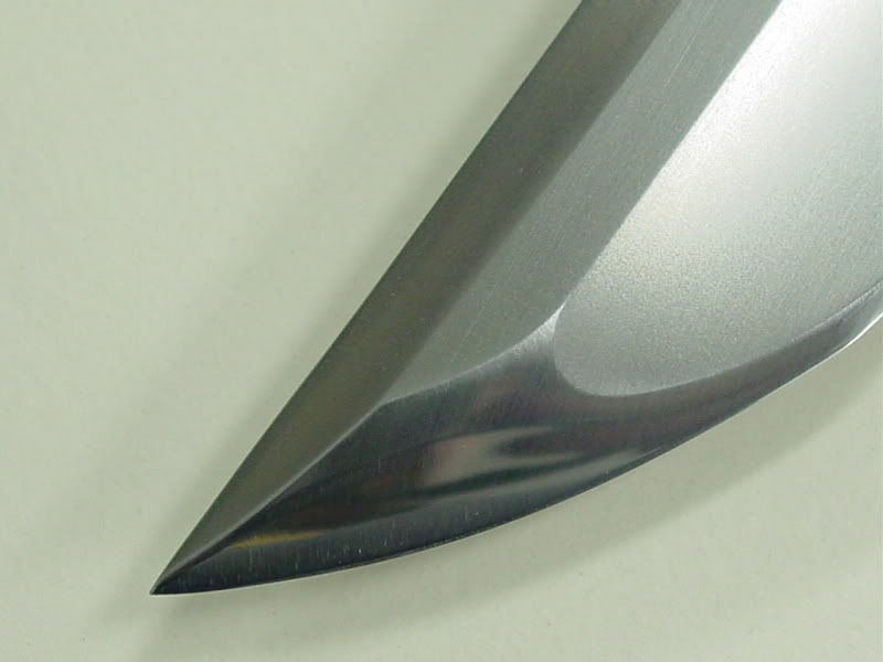

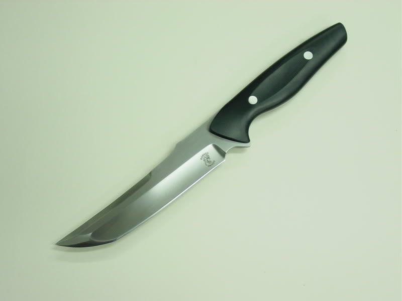

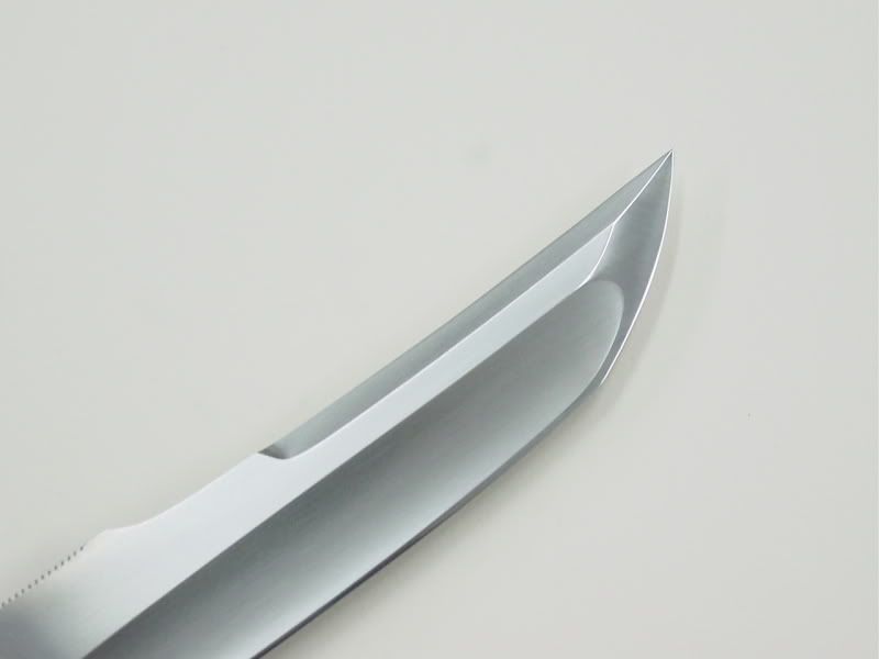

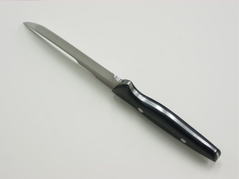

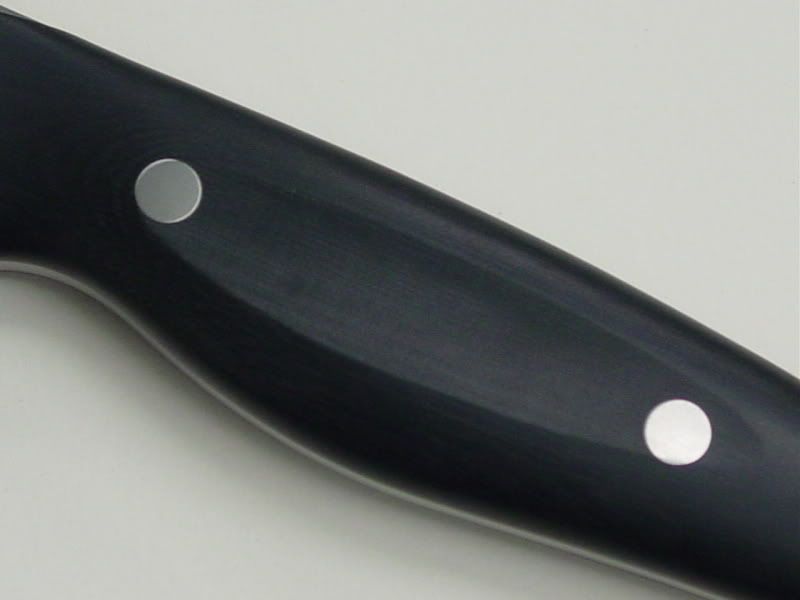

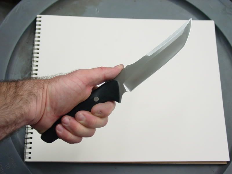

This is my first tanto design. I call it the Hokkaido after the Hokkaido Inu breed of dog pictured below. This blade is made of CPM D2 5/32" thick that has been hollowed ground with a convexed tip for strength. The blade has a 5.25" cutting edge with a satin finish. The Rockwell hardness of the blade is 60. The scales are black linen micarta on a tapered tang. The overall length is 10.75". The grind was inspired by Bob Lum's work. I have always admired his tantos as I'm sure you have too. I would appreciate any comments
