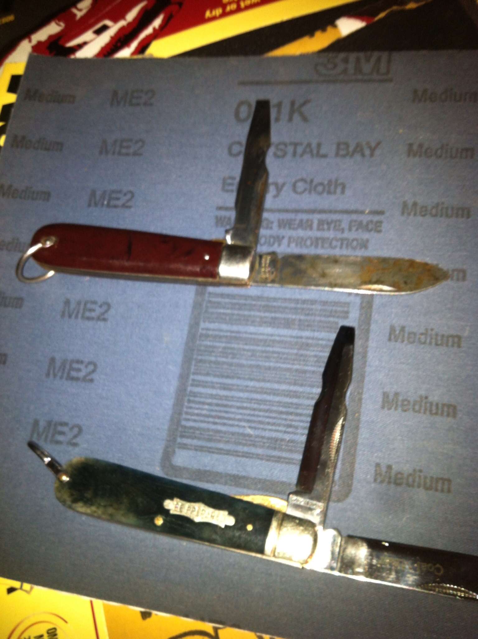

I got a Barlow-looking knife at a garage sale, nothing special. Two blades, a normal blade that had been sharpened poorly and a long thin blade with an edge and a screw driver bit or a chisel shaped bit on the end. It may have started out as a screwdriver but it is sharp like a chisel now. The screwdriver or chisel blade is a liner lock, the main blade does not lock.
I could almost see the screwdriver blade being used to pry out staples? (Sharpened to a chisel point as it is.) It would not be an effective screw driver as it is. The liner lock would stop this odd chisel blade from closing on your hand if you pushed it forward to chisel or pry. Closing on your hand would be bad, because that long blade also has a sharp edge.
The main blade says "Japan 635."
I'd love to know what that long blade is for. Odd thing is it is thin and has an edge but the edge ends and the blade thickens near the tip. I can't get a good picture of that location but I could this weekend under the sun.
I just bought it because it was cheap and kinda cool. Of course I could say that about most of my knives.
I know, pictures are worth 1000 words.
It's an electrician's knife. The main blade was reshaped... most likely originally a spear. Made by Sabre.
Funny, there is one on eBay and the seller says the tip of the second blade is "missing" but it looks just like mine. What do electricians use a spear point blade for? If it was broken and reshaped the one on eBay suffered an identical fate. Edit - All the lineman and electrician's knives that I can find have this same blade, so I am sure it is useful. I don't think mine was broken as all the blades seem to end at the same length. I would have assumed they were screwdrivers, and may be, but mine is now a chisel.

What is now known as the TL-29 pattern started as a military knife for the communication corps for field duty. The blade would have been used for stripping insulation from the wires. I suppose they could have used a clip, but the spear is a nice general purpose shape.
The pattern turned out to be such a useful item that it lasted for many decades. I got a post around here somewhere that gives the spec numbers and dates. I'll see if I can find it.
Jake would this be made by sabre then? No other markings. Beaut little knife and I scored it for nix:D
Meako, Unfortunately I can't help. I'm not very familiar with Sabre. I only recognized the electrician's knife since I've gotten a few in lots with other knives.
Here a couple more of that pattern. The brown one is an Imperial I picked up at a flea market for a couple of bucks. The black one is a new Rough Rider, just a couple of bucks more. Yep, the crappy cell phone pics make them both look old and beat up.
