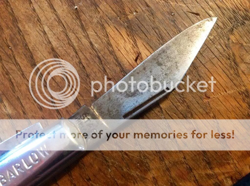

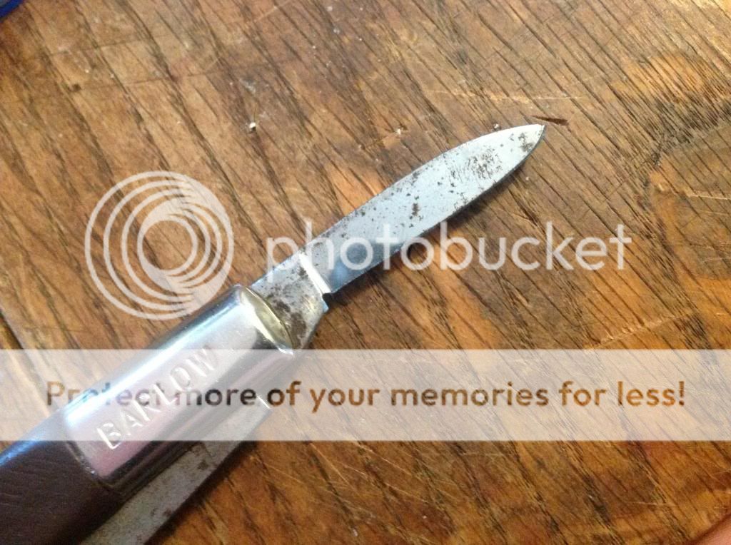

First here's how the Barlow was when I got it. (Sorry about the picture quality)

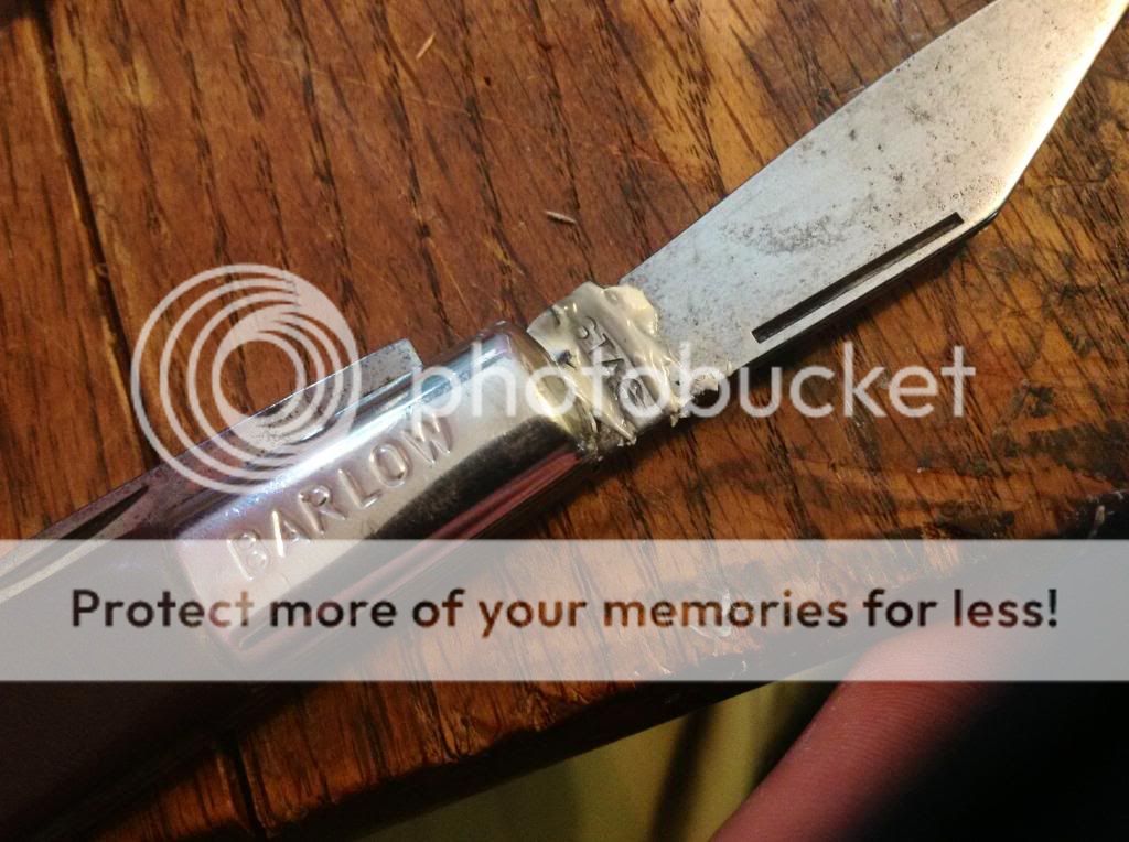

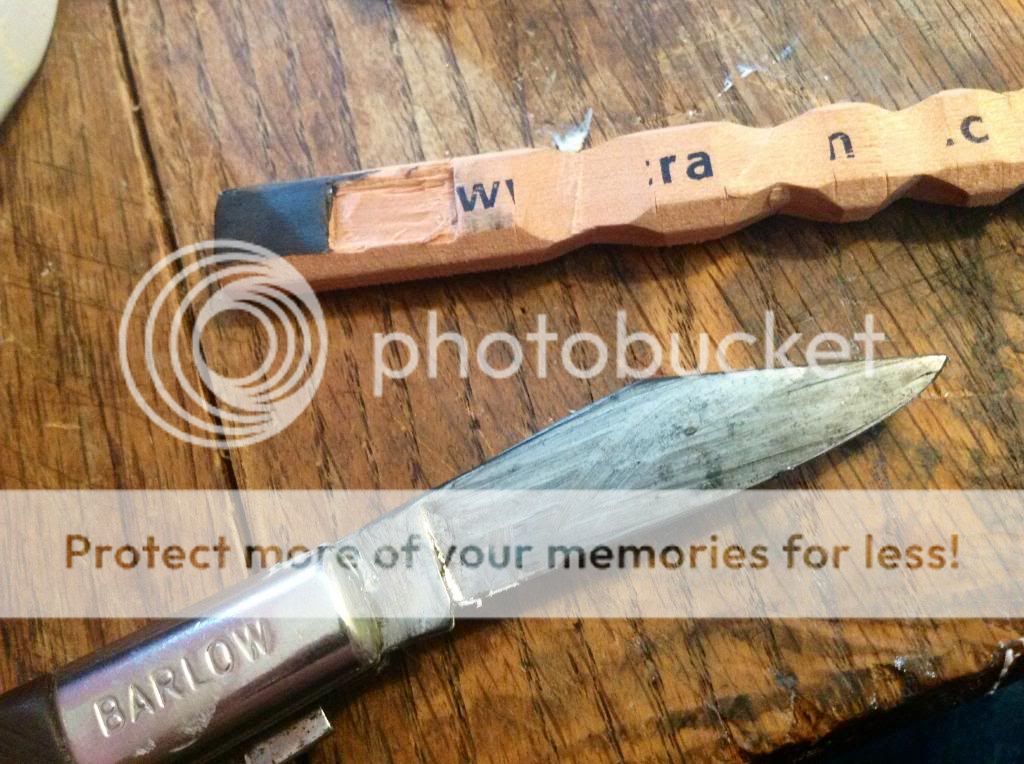

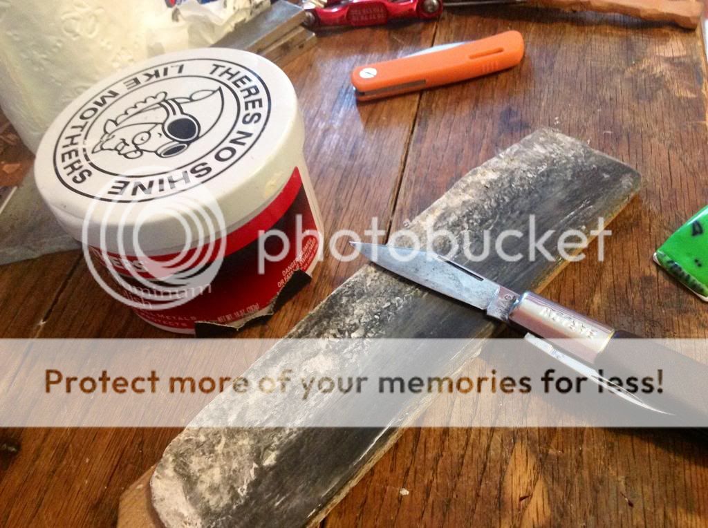

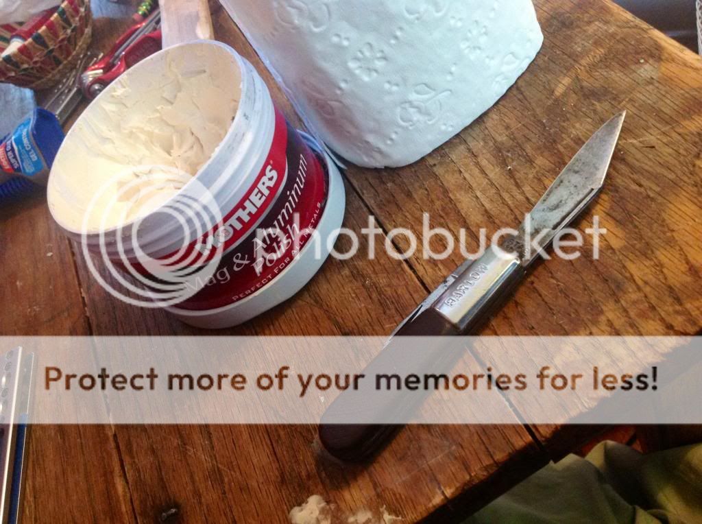

I started by polishing the blades with mother mags aluminum polish. (I forgot to get pictures of polishing the pen blade...)

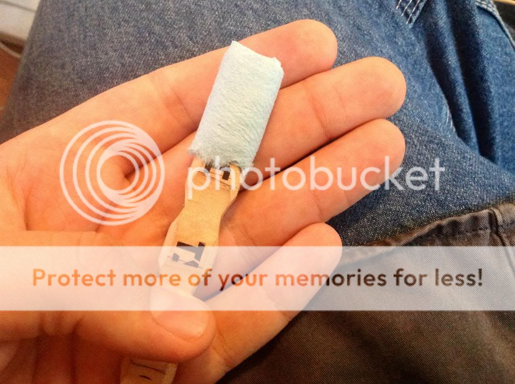

I wrap a strip of paper towel around a carpenters pencil and apply compound, when it becomes loaded with metal I just rip off the dirty part and re-apply compound.

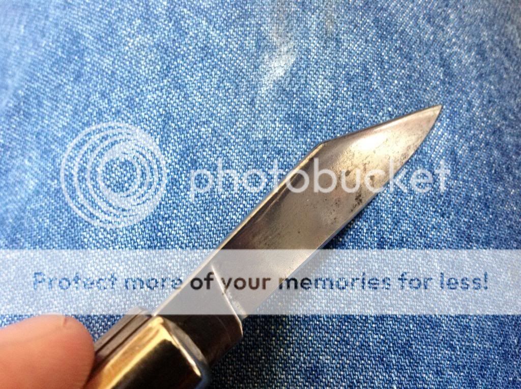

Here I'm starting on the clip blade and then the tang stamp.

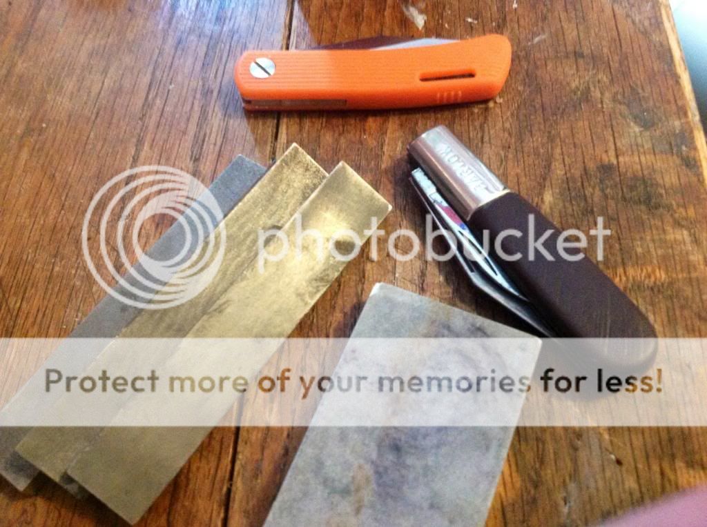

Time to make this Barlow cut! I started with my diamond stones (220, 400, and 600 grit I believe), then onto a hard Arkansas stone, and I finished with my strop. I'm happy to say that it came out quite sharp!

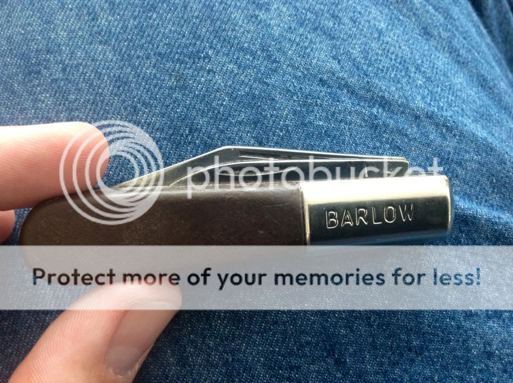

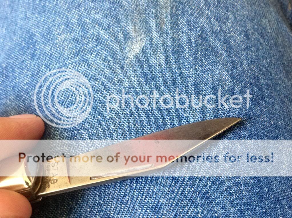

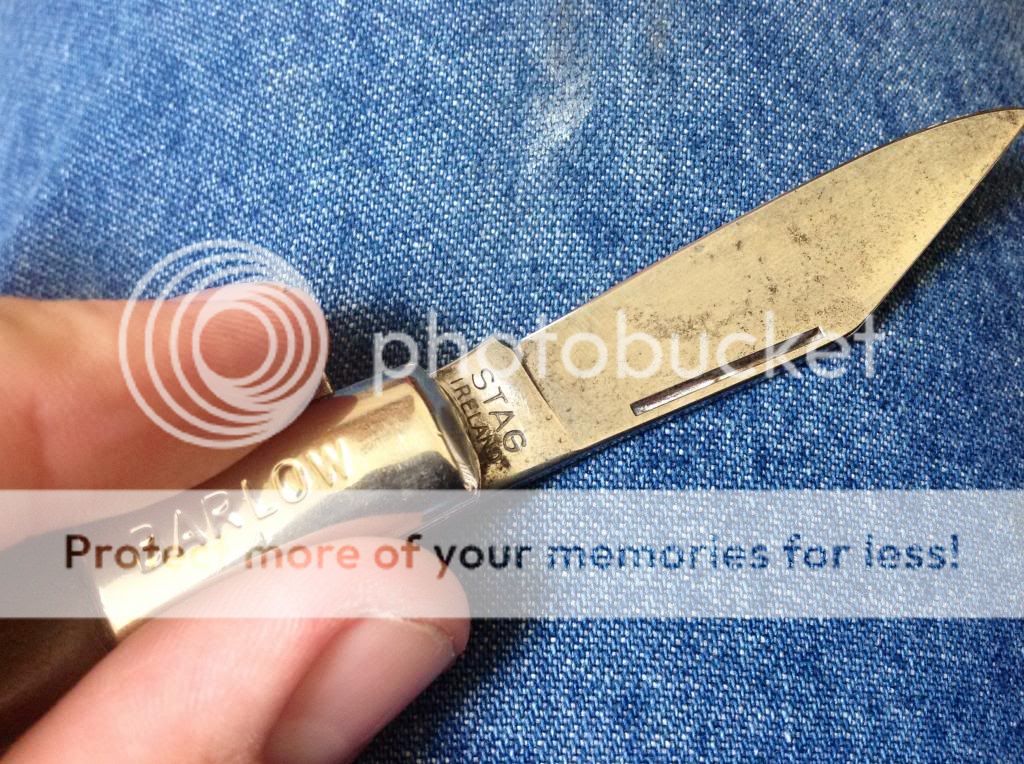

Finally finished! Here are some pics, this knife gave me a newfound respect for people that take nice pictures of mirror polished bolsters...most of mine were pretty sad. :o I'm having some problems uploading pictures of the pen blade, Im trying to fix it at the moment. :)
The only markings I could find are "stag Ireland", if anyone can tell me any history behind this knife I would love to know!

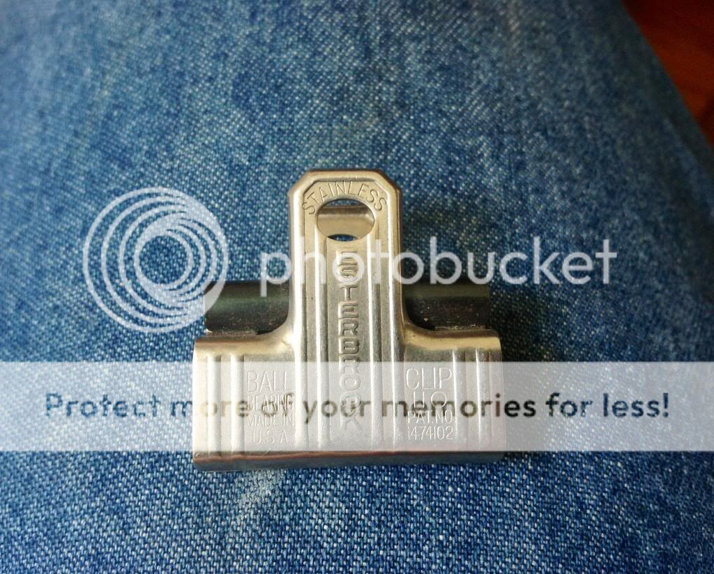

The knife is a dandy, but that Esterbrook clip, wow. It's something that simple that really makes me enjoy things from another time. I'm trying to explain to my girlfriend why it is that I like knives so much, and perhaps trying to explain or put it into words myself... there's a nostalgia and romance to it to be sure... I don't know, I guess you either get it or you don't. What I enjoy about this forum is that it seems a lot of you "get it". Thanks.

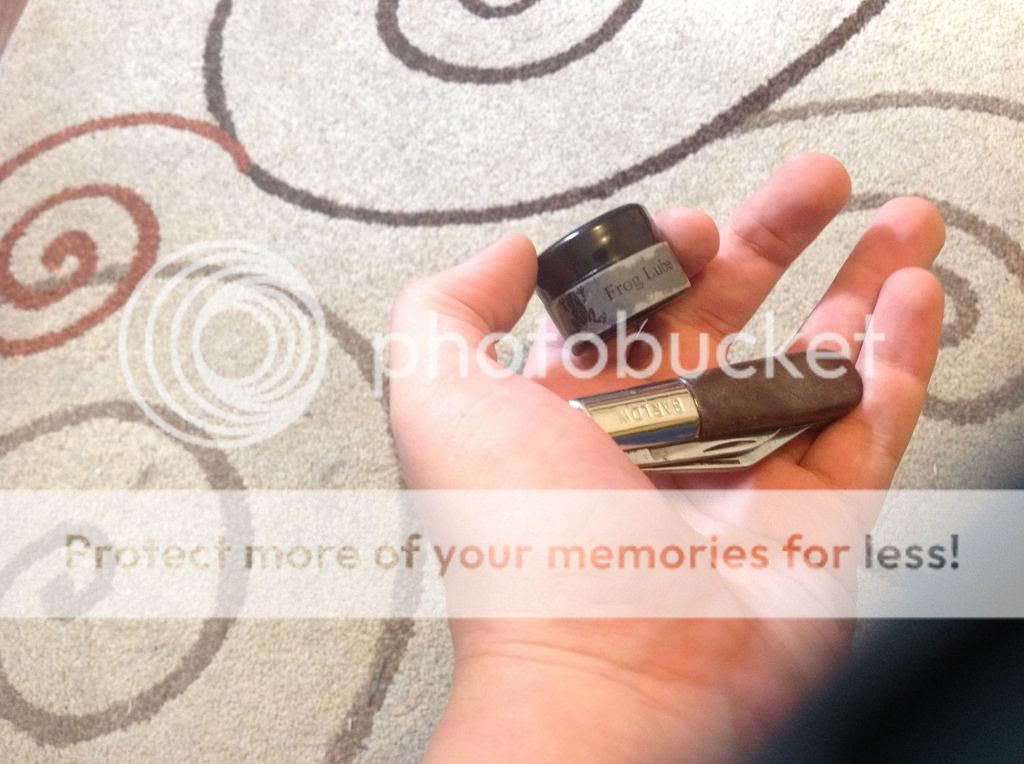

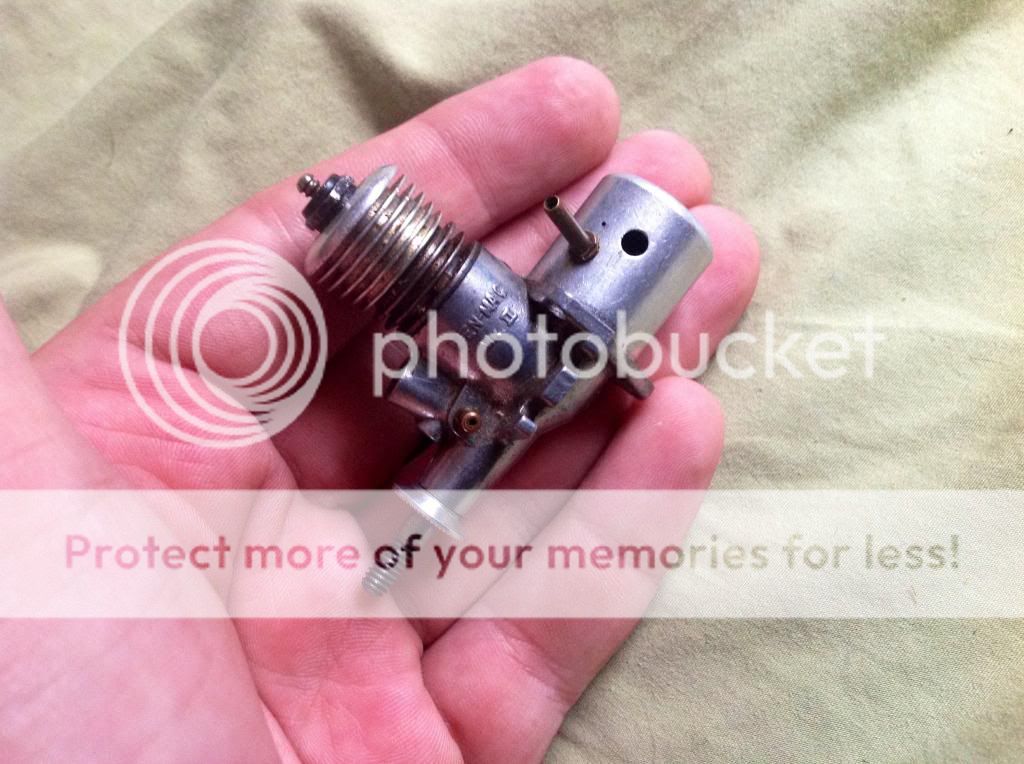

Here's a WEN-MAC mark II. Aluminum, steel, and brass, no plastic here!

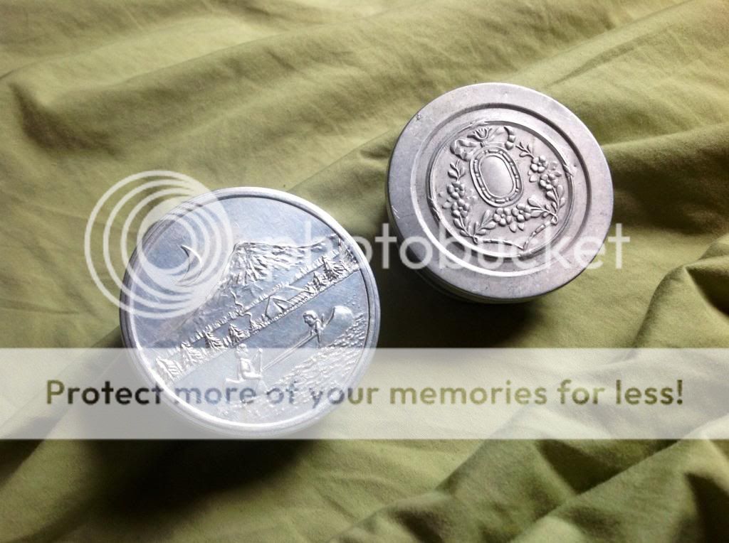

Last but not least, a hand made (looking) treasure box inlayed with brass. It seems like I found this when I was seven at a garage sale and got it for a dollar. :D

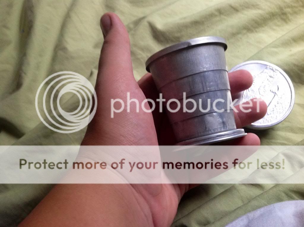

These are folding cups, interesting art work and kind of fun to look at.
