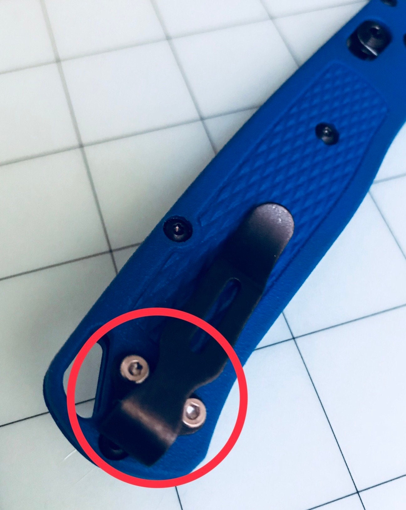

It is one thing when the screws sit above the pocket clip (like in the pic above) but in the case of the BM Bugout (see below) the clip is over the screws and you are going to tear up the inside of your pants with those proud screw heads if you push your pocket clip down all the way.
I agree K.O.D. K.O.D. 100%
Kinda negates the whole "deep carry" idea.

Socket head cap screw.....
They work ok when used as intended, counter sunk into the handle for instance and used with a binding post. The deeper head allows for more positive tool engagement and lessens the chance of stripping it out inside.
That makes sense. Finally a solid reason for them. Sounds like they need to be sold as a combo with properly countersunk pocket clips though. Of course, the other issue with that is if you take the example of the Tenacious pic I posted above, I think if you tried countersink enough for the size of the heads on those screws there won't be any pocket clip left for the screw to engage with... So if it's an attempt to solve the issue of stripped screw heads, it's a pretty clumsy one, at least in some cases.
