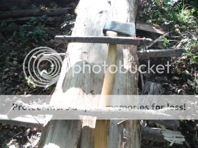

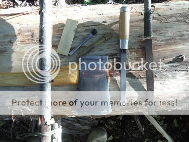

I have been asked by several people to do a video on axe sharpening. I have been very hesitant to do so. I am going to show you what works for me. I don't deal in precise angles or gadgets. I use real basic sharpening tools. There is no real technique. The best way to learn is to get an axe and practice. I have never seen an axe that was beyond repair from hand sharpening.
[video=youtube;oOoBrURokwo]http://www.youtube.com/watch?v=oOoBrURokwo&feature=c4-overview&list=UUnHwxnLdWlkpvCrfwGoPZ9Q[/video]
Basic tools. I like to start with a file. You can make a handle or use a commercial one. A handle is not necessary, but it gives you more control. A DC4 is a great portable sharpening tool. I use it to clean up the file marks and getting out small nicks. The diamond steel and ceramic rod are my favorite for a final edge.
I like to do most of my work in the woods is possible. I made a quick clamp so I could use both hands to file. It is pretty easy to make.

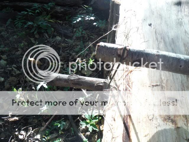

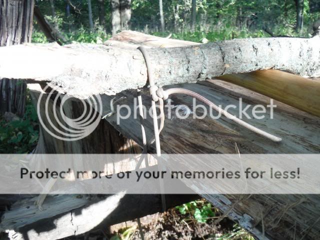

I start with a platform, and 4 spars. On one end of the spars, I tie a fixed loop. I usually use a figure 8 on a bight.If you are worried about the line slipping, you can put a notch in the spars to keep it in place.
The other end of the spars are secured with a Canadian jam. This keeps the axe fairly secure.
There is no great secret about sharpening except practice.
I did not take pictures of actual sharpening, but it is in the video. Hope it helps.
