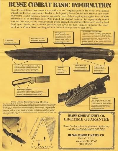

There's a section cut photo floating around of a basic tang. Its not skeletonized but it does narrow as it goes through the grip as you'd expect. I had this fear of weakness as well, but I'm slowly getting over it.
Its deffinitely slimmer but holds up under hard use. I beat the crap out of my B 11 and it holds up just fine.
Not a great image (scanned)......no 90° corners, they are all radiused.
