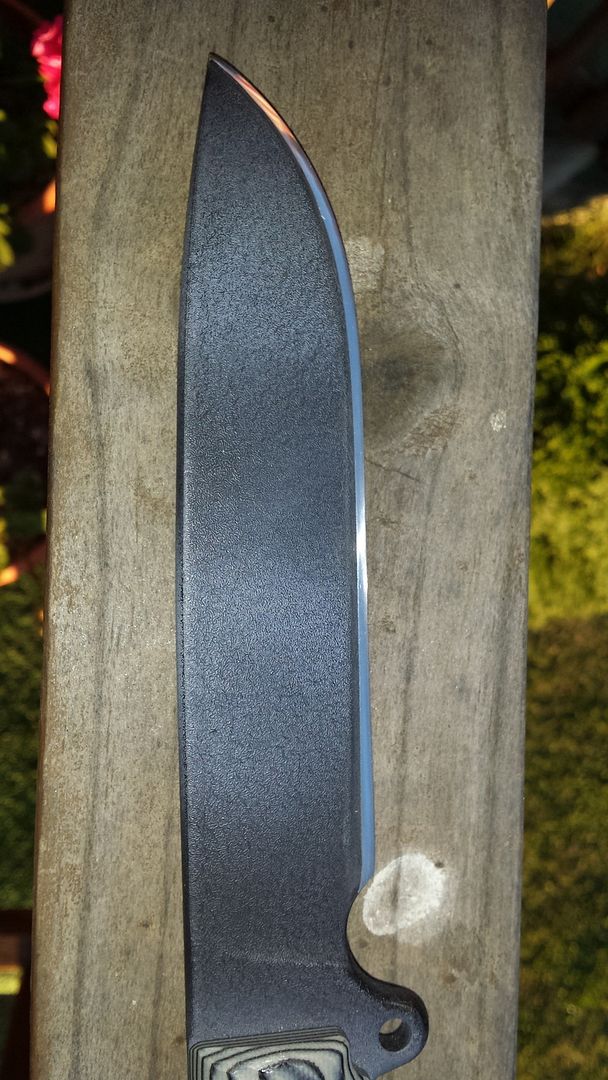

Before:
After:
it turned out pretty good but alot of fine sanding and polishing
