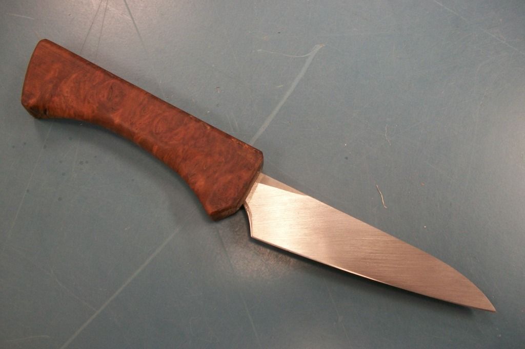

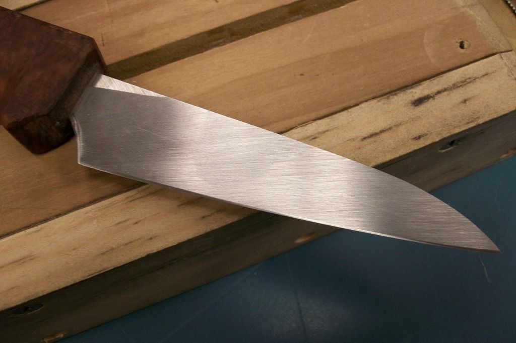

Quick update on this blade and some pics. Disclaimer, the handle is my own work, based on an end for end symmetrical concept for EDU knife but I applied it to this one that Luong supplied with a blank handle. I include these to show the very nice grind work on the blade and for reference, not to show off my wood-working... :eek:
I had suspicions following the last test that based only on RC, the edge should have held up longer, add the fact that in the past my Norton waterstone had trouble making longer lasting edges on higher alloy steel. So, used a Washboard with 800 grit wet/dry instead, finished with some stropping/burnishing on plain paper. Under the loupe and for impromptu cutting these edge finishes look and behave very similar, but there were some differences making me believe the 4k Norton is a fair amount more refined than the 800 wet/dry.
Initial static load for a pressure cut was 17lbs. Static load for a pressure cut upon finishing was 30 lbs - so a notable shift from the first numbers, though anything under 20lbs initially is pretty good for this test. Also, it now completed 158 passes before failing three in a row, a very large difference necessitating a third round of testing early next week.

Martin, I am sure the handle is very comfortable to use. :thumbup:
The grind is indeed very nice, is it tapered to very thin tips?
On the performance, can you help explaining the performance difference, perhaps I can pick up my lesson for VG10 ...
Chris, do you mean the diff between the 4k Norton and the 800 wet/dry, or this steel vs others I've tested?
It distal tapers to a very thin tip. Being mostly used to BCMW trial run knives, the aesthetic and functional quality of the grind is first rate.
