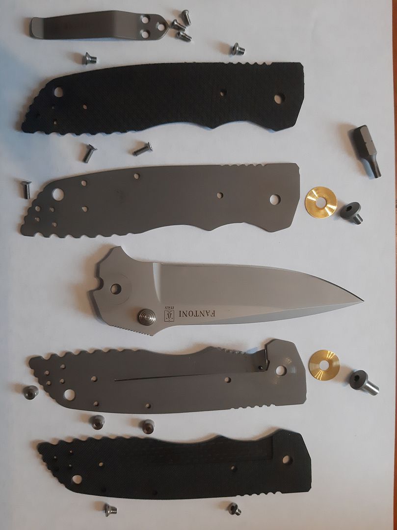

Hi everyone,
Yesterday, I cleaned out a Fantoni HB-01 that I bought used. It has beadblasted Ti liners and a beadblasted blade. I found the opening and closing action to sound a bit "gritty". After cleaning and applying a bit of fluorinated grease, the action was smoother, but stil not 100%. My idea is, that this is caused by the friction between the washers and the beadblasted blade. I'm thinking of polishing the area where the washer sits comes into contact with the blade. Would you guys think this would make a difference? And if so, what would be a good way to do that?
I look forward to hearing your thoughts!

Thanks for all your input, guys!
J. Doyle J. Doyle I'd prefer not polishing the entire blade, I actually really like the beadblasted look of it. Having pockets milled out for bearings would take away the appeal of the knife for me, I actually prefer knives on washers. As long as they're smooth, that is :) But, you did give me an idea, that I'm gonna try out tomorrow.

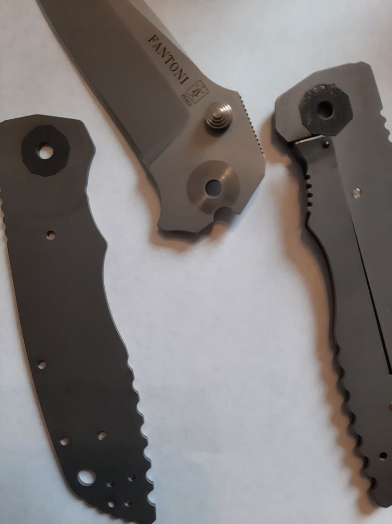

On the Fantoni, I found there was a bit of a burr at the end of the lockbar, causing a bit of drag. So, I filed that off.
I then experimented a bit and have come up with the idea of making makeshift washers out of polishing paper (first 1500, then 3000 grit), and temporarily glueing these to the liners of the knife, using spray adhesive. I then assembled it and opened and closed a few times. The areas where the actual washers would sit are now a lot smoother. After final assembly, the knife feels a looks smoother as well. I'd say: mission accomplished! :)

That's a neat trick with the polishing paper, I've never thought of that. I've sanded and polished pivot areas before, but never thought of cutting sandpaper circles and installing them in the knife to sand/polish the pivot areas. I'm going to have to remember that one. And I'll be sure to give you credit if I recommend it to others :) .
As for modifying BP washers, as I referenced, the really thin .005" thick ones are a bit more difficult to modify due to how thin they are, but it can be done. I just file a bit more slowly and gently than with the thicker ones, and I use sharp scissors (good shearing action) to avoid bending when trimming them. Then after I'm done I sand them with 2000 grit sandpaper to remove any burrs.
