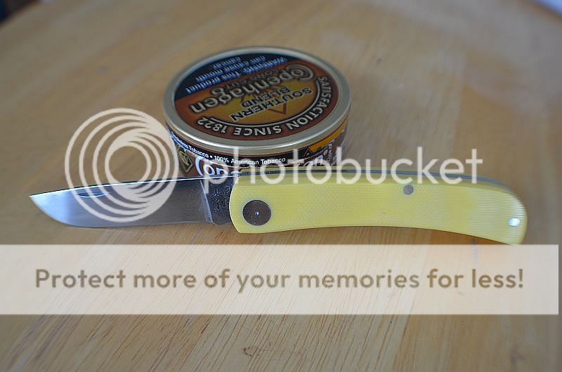

I've had a $50 gift card to [a sporting goods store] since last Christmas. Unfortunately, there are no local stores in my area. I was visiting family this past weekend in North Georgia, and on the way back I stopped by the one in Augusta. I browsed for a bit, and had already grabbed a red Tinker; my first Victorinox. I know it's hard to believe, but I've never owned one. I think I had a Wenger when I was a kid, but God only knows what happened to it.
Anyway, I found a rack of Bear & Sons knives. One that jumped out at me was the C337 Yellow G10 Farm Hand. It is a liner-less Sodbuster type knife, 1.9oz with a 2 3/4in. 1095 carbon steel blade. Of the 7 examples they had, I picked the best looking one. This is saying something, because there was a huge variation of fit and finish between each knife. This seems to be the general consensus on Bear & Sons products. The Price was $29, which is high- but I went ahead and picked it up.

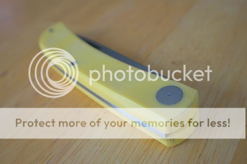

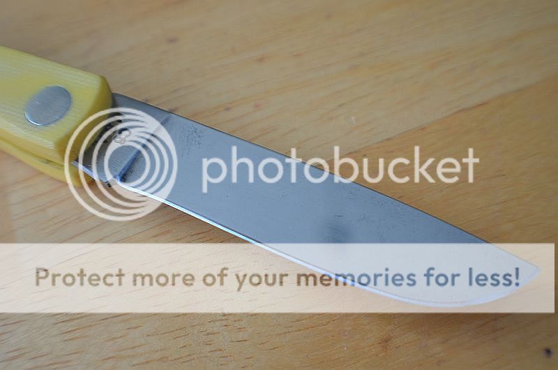

Once I got home and opened it up, I made a few observations. For one, the blade came oiled out of the package, but some spotting was still present after I wiped it down. There was also a good bit of polishing compound left on the blade. The handle was full of dust, too. I don't know if it was dried polishing compound, or G10 dust. There are also a few discolored areas on the G10 scales. The finish on the portion of the blade that interfaces with the spring is very rough, and can be felt when opening and closing the blade. I was able to clean out some grit, but even still the steel itself is very uneven. I oiled it up and it relieved some of the friction- but its still there. This may slick up over time. A rough burr was also present on the blades edge. It touched up nicely on a ceramic rod, but shouldn't have had to be done right out of the box. I'm not very impressed with the quality of this US produced knife. The Chinese produced Puma SGB I posted about earlier is head and shoulders above this knife. I imagine this knife will perform well as a user, but surely not a show piece.

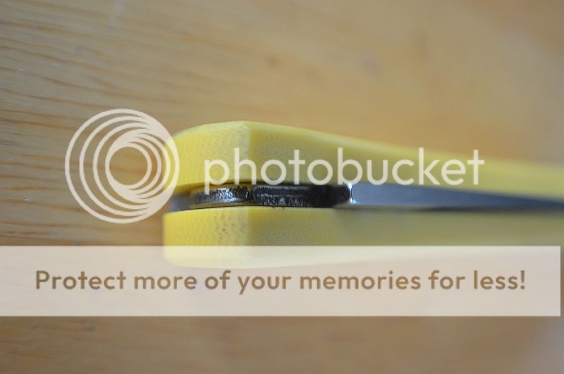

I'm not concerned about the knife being liner-less, as G10 is extremely hard/strong. Many large "Tactical" folders employ liner-less G10 scales. Cold Steel and Al Mar come to mind.
Here you can see some of the discoloration on the G10.
Here is the lack of finish I attribute the rough opening to.

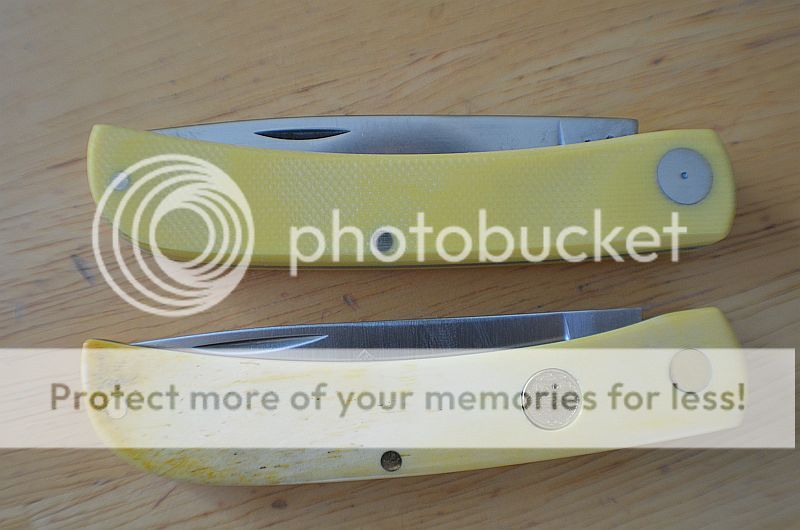

Compared to the Puma SGB Lonestar 30.
