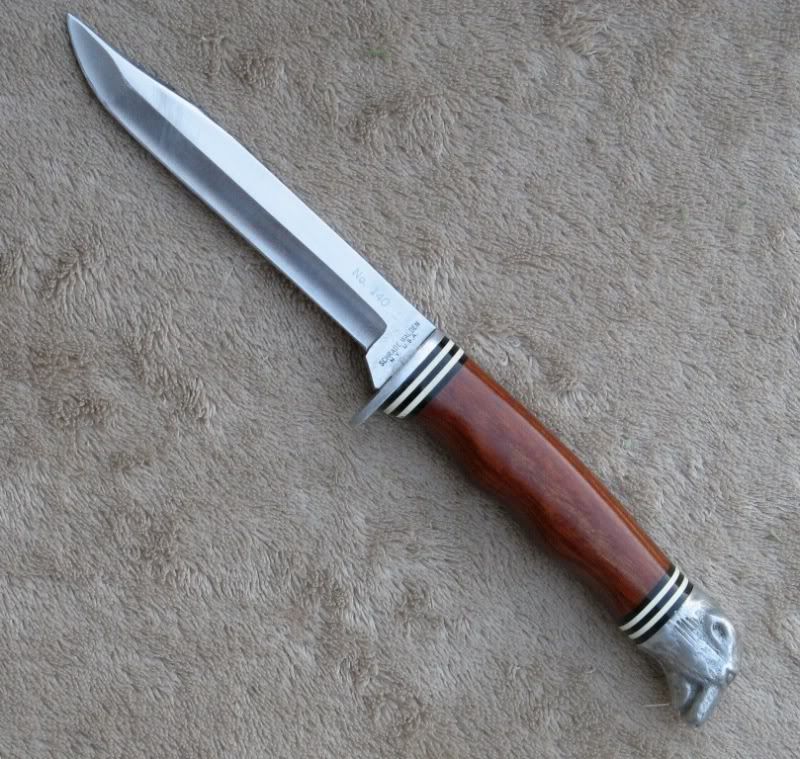

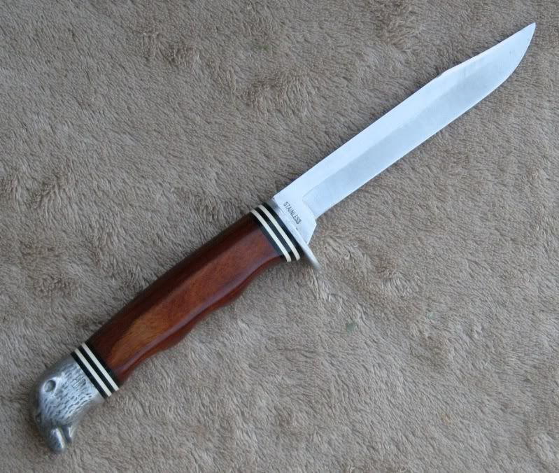

Bear's Head 140 Fixed Blade
Oct 28, 2006
5,978
First appeared in 1953. Lasted only 3 or 4 years. Retail price - $4.95
I've always wanted a Bears Head knife. The grooved wooden handles are gorgeous, and I like the black and white spacers. This one is 8 1/2" total length, and the blade itself is 4 1/4", from the top of the guard to the tip. It's worth the $5.00... I gave a bit more for it.
Hal --
Ditto on the Kudos!!
I'd always wondered reading the catalog description for this one.
Grooved - I was thinking longitudinal grooves for grip but never saw them in the auction pictures.
I remember passing this one up for just that reason.

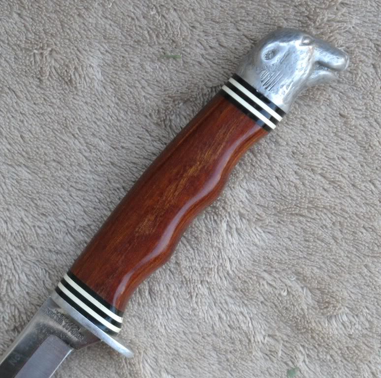

DOH !! Finger Grooves!! :stupid:
Bet the Wonda-Wood with the finger grooves has a nice hand feel. Excellent grain!

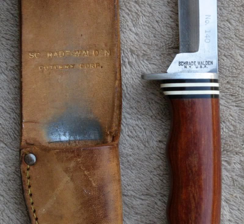

Sweet blade with No. 140 etch - don't see them in this condition too often.
And, as usual, superb photography.
As we say in Bahstun - "A Keepah!" :thumbup:
-- Howie
Note that not all had the Wondawood/Stratawood handles, and not all of those were grooved. And not many were stainless either. There were also Craftsman versions.

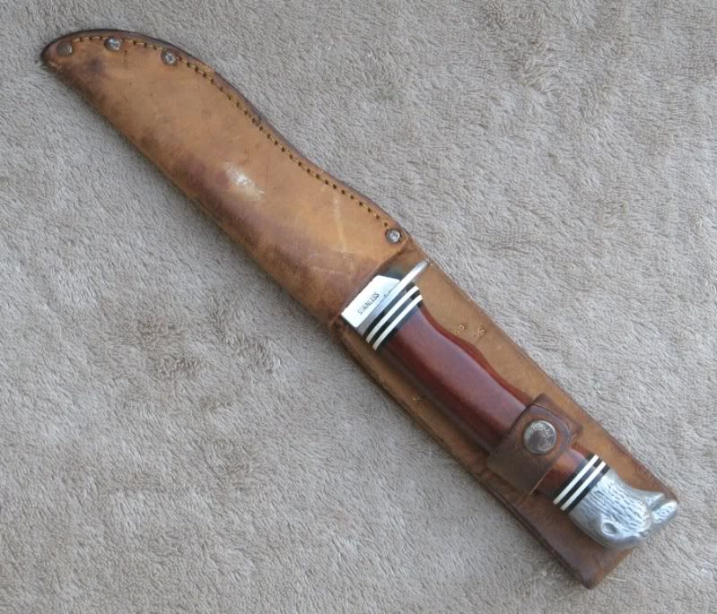

It was an Ebay knife. It sat unbid on for a period of time so I made the seller a fixed price offer and he made me pay a tad more. I'm not up on the current value but I thought it was a fair deal, though not a steal.
Considering they are now fifty years old and are not seen everyday, an example in like-new condition with the correct sheath is worth whatever a buyer is willing to pay and a seller is willing to take. Do you have examples of the later knives that one evolved into? Like the short-lived 41OT, the Craftsman version and the 49er Benchmade? A set would make an awsome display. I believe there was a WondaEdge serrated version as well.
