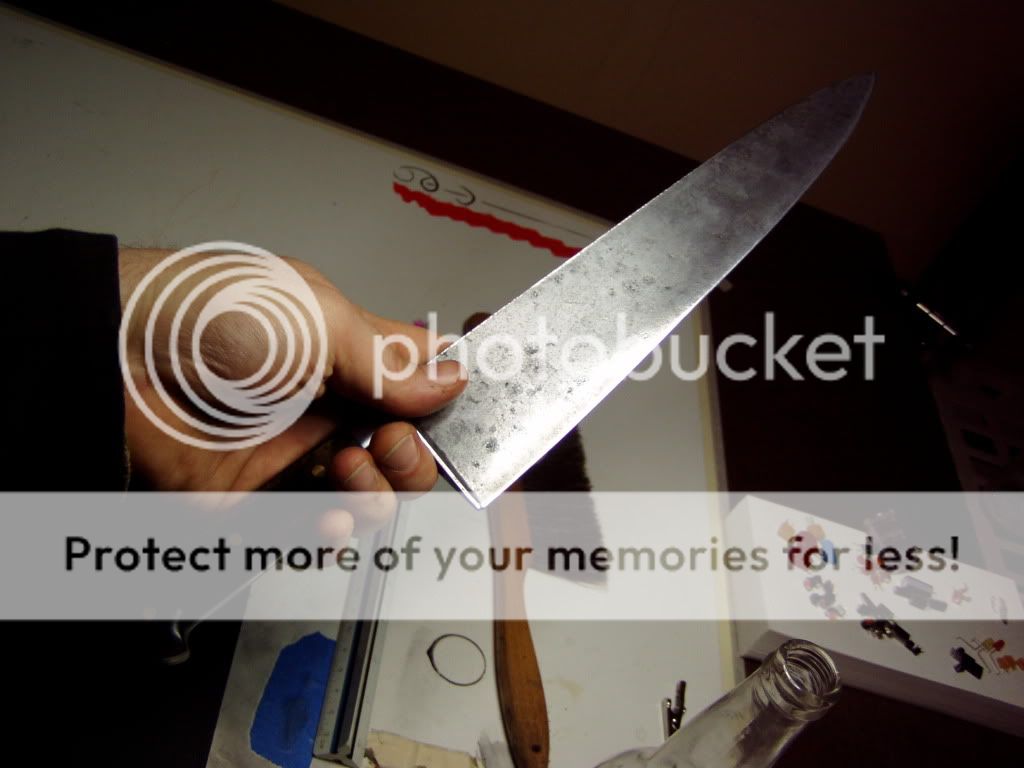

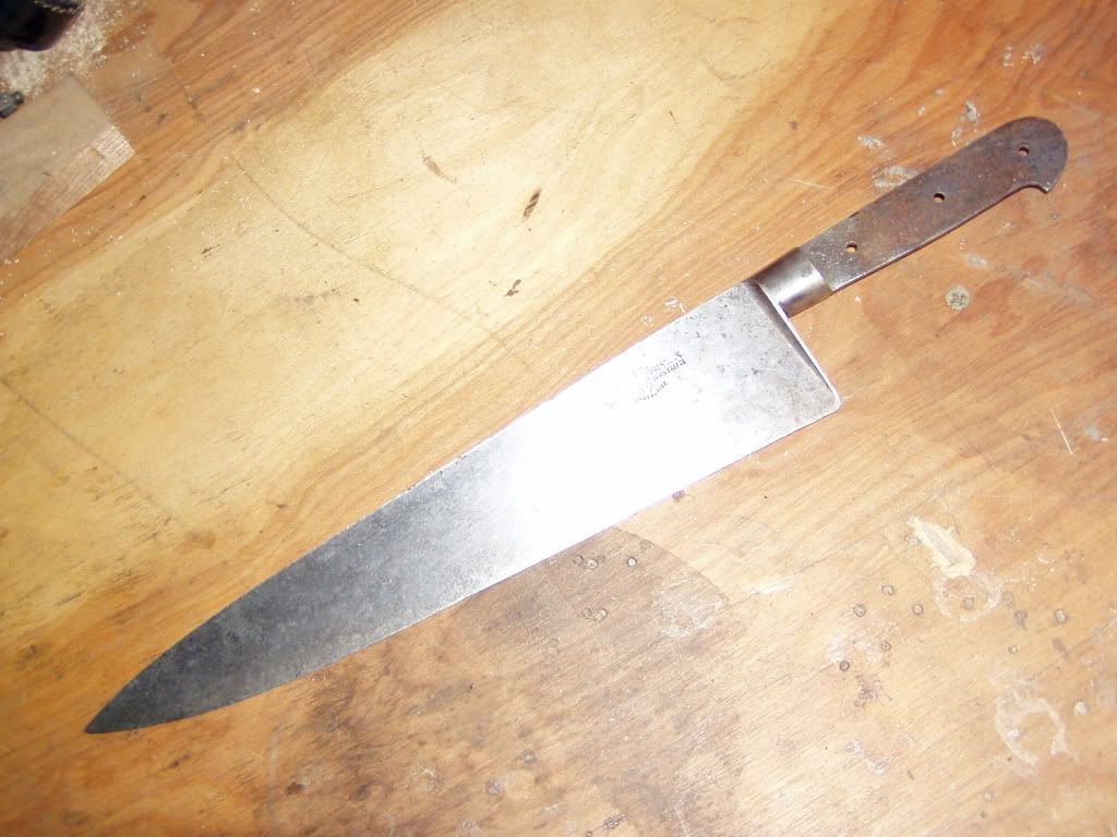

so my buddy, a chef here in town, was rooting around in an old shed behind his restaurant and came across this:

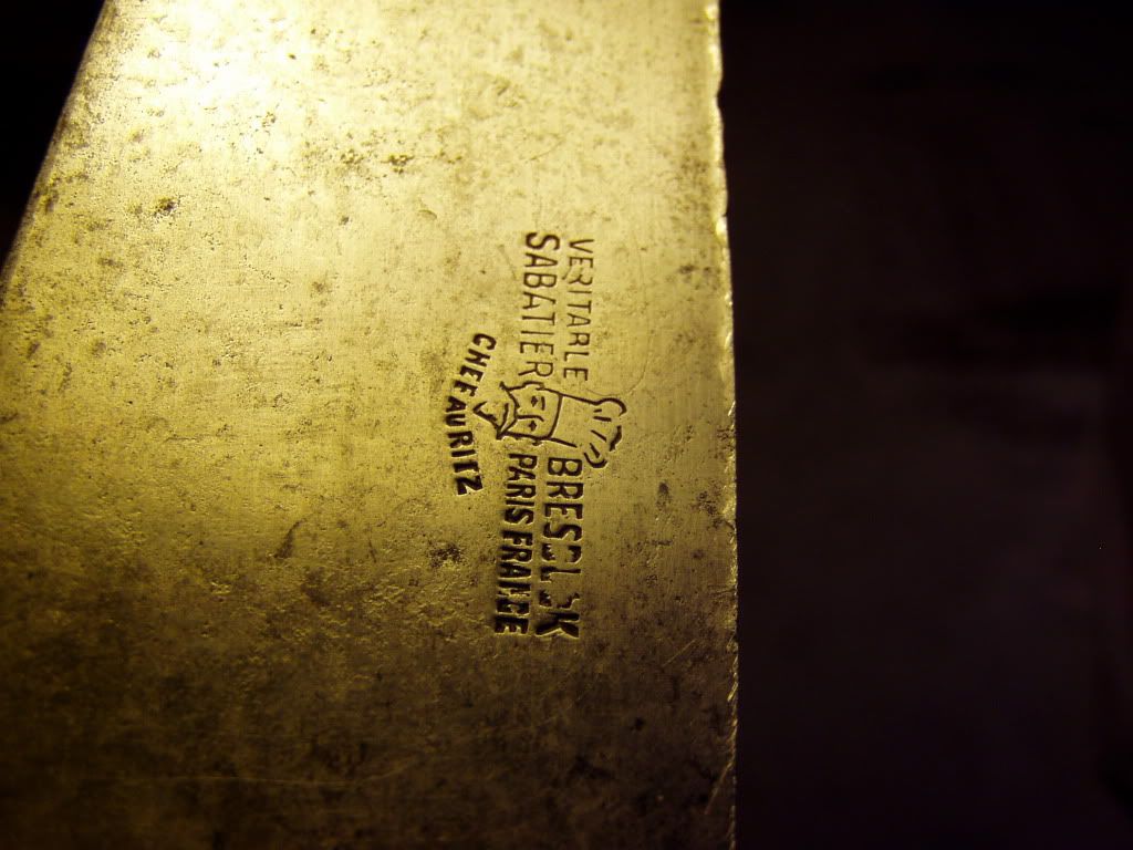

it's an old, beat up Veritable Sabatier, i'm interested in any info about the knife, if there are any french knife geeks out there.. here's the mark (notice the fine hammer work on the spine, this knife is a user!):

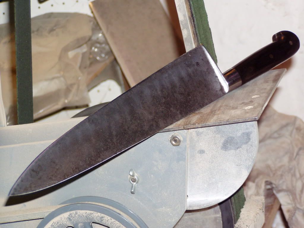

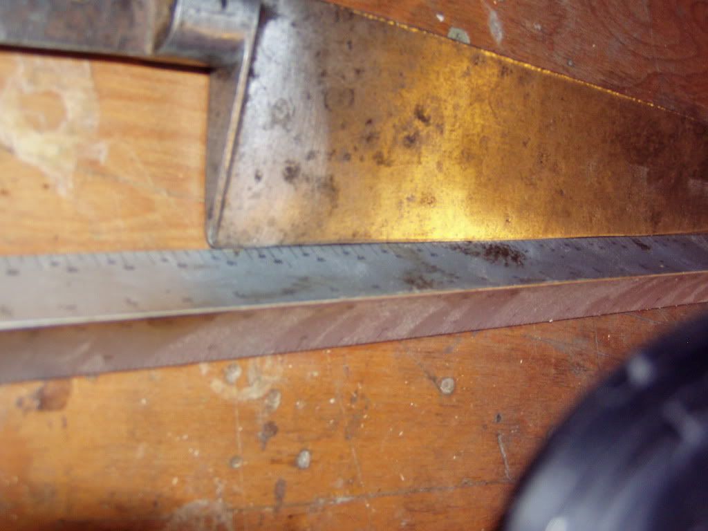

the blade next to a straightedge, looks like deep ocean on a rough day:

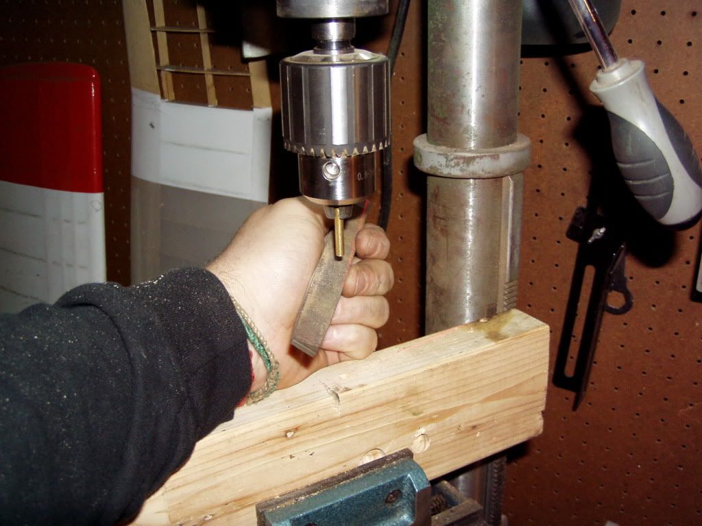

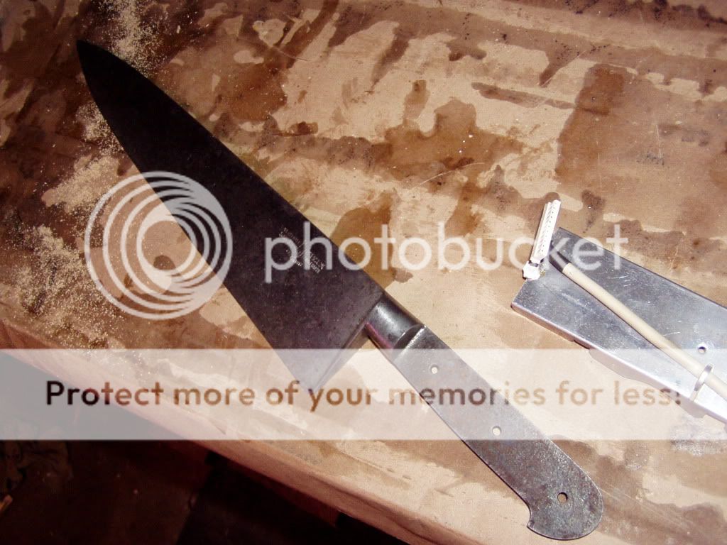

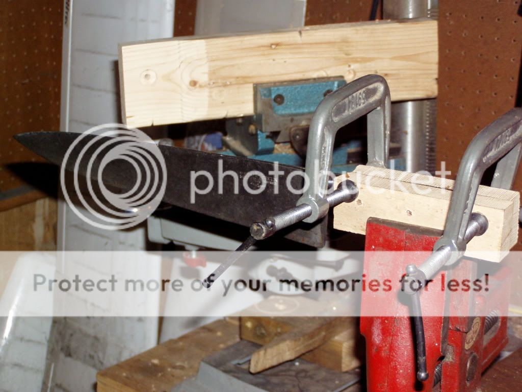

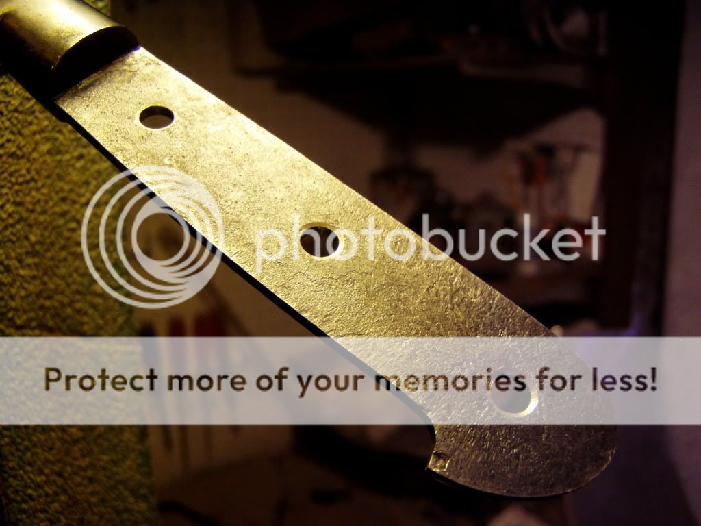

as you can see, it's lacking in the ergonomic department, so he decided he wanted a handle. I like to use pins instead of rivets, so the first order of business was to clean up that rust and drill out those teeny rivet holes to make room for some beefy brass:
BEFORE
AFTER

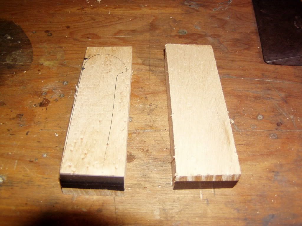

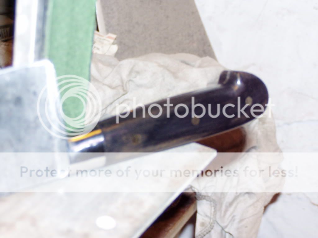

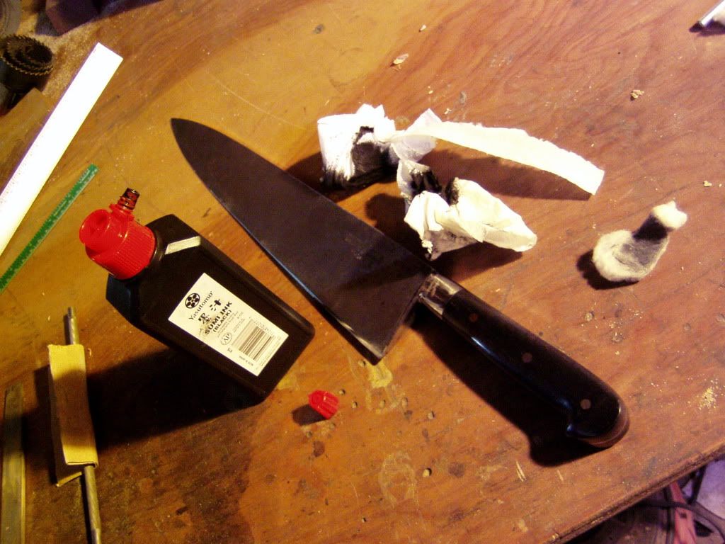

i've got some nice bird's eye maple still, conditioned in my shop for almost 2 years, so i figured i'd give that a go. he wants the handle dark, and i'll deal with that later..
i wish you could see the action going on in this wood, it's not even sanded here and it's still purdy:

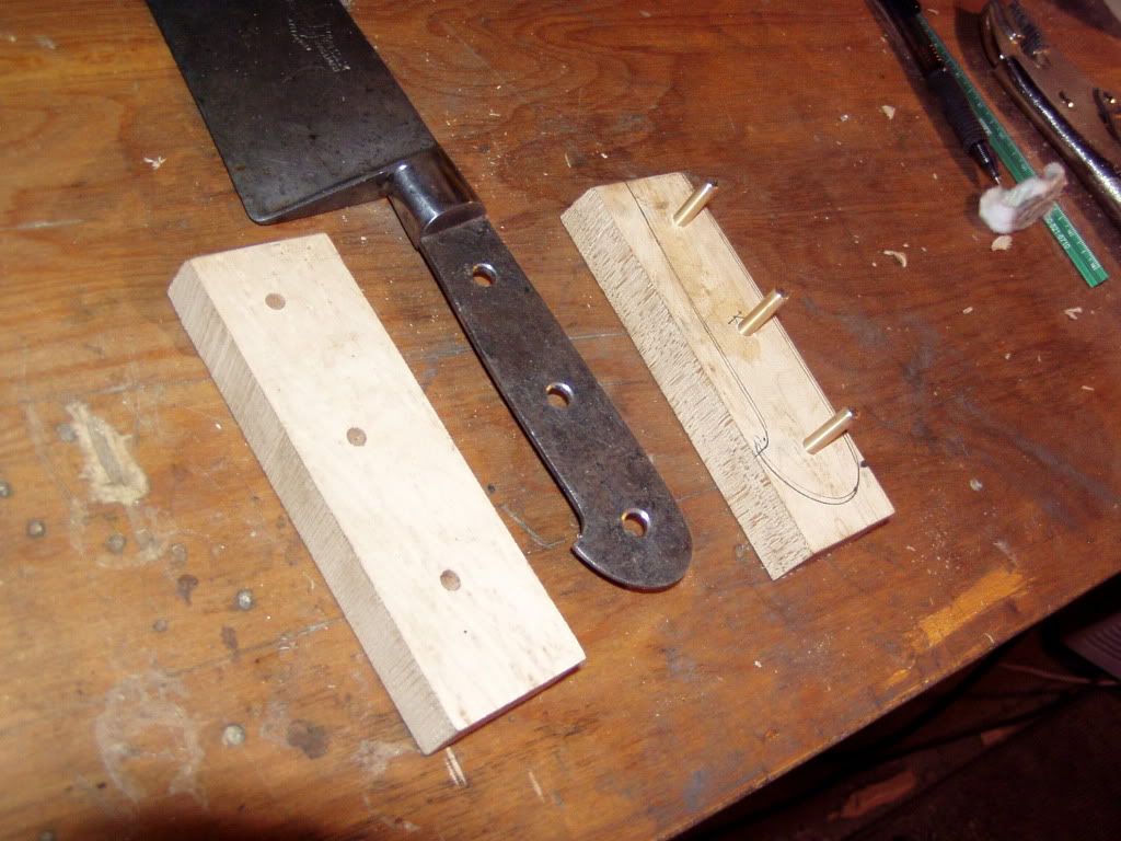

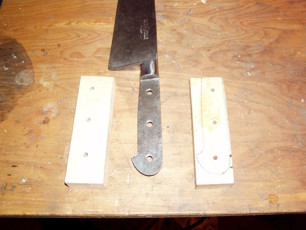

HOLES DRILLED:

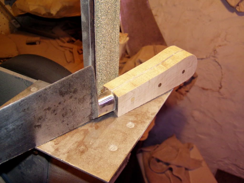

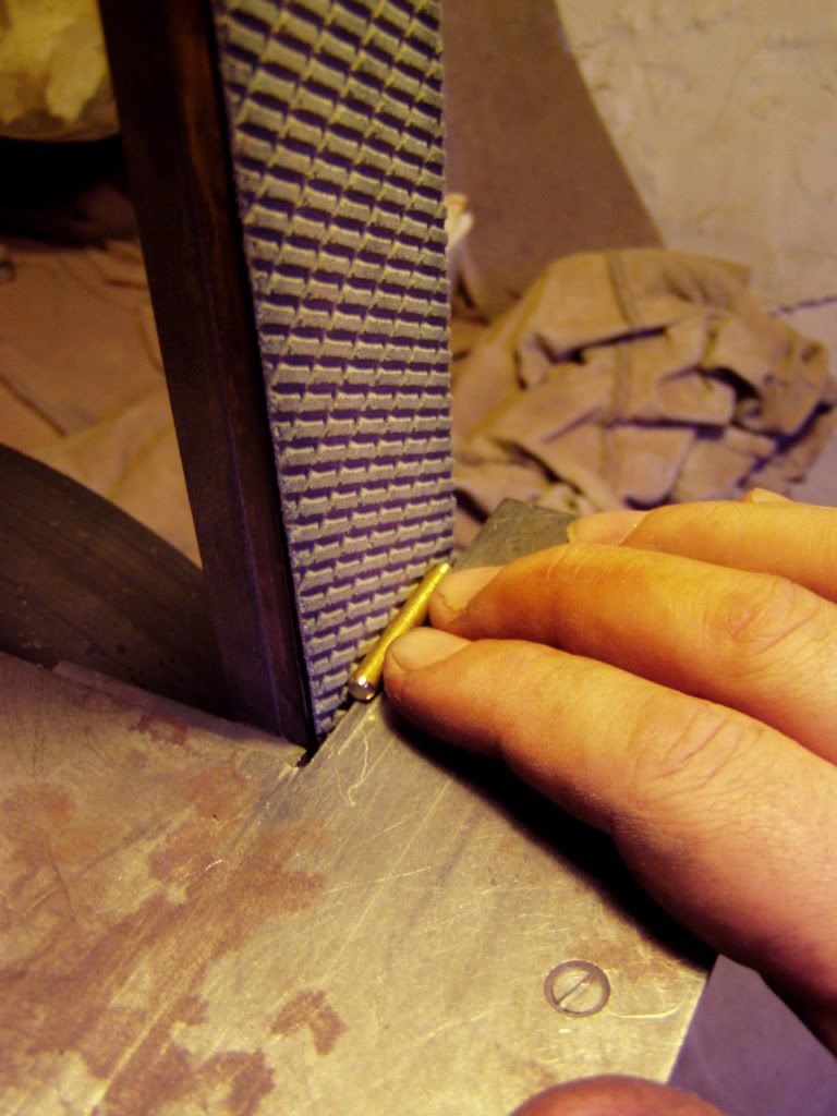

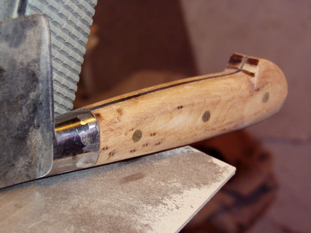

i don't have a pic of me cutting the pins, but here's my super high tech pin crowning machine in action.. all precision!
and the super high precision pin truing device, the tolerances are mind blowing!

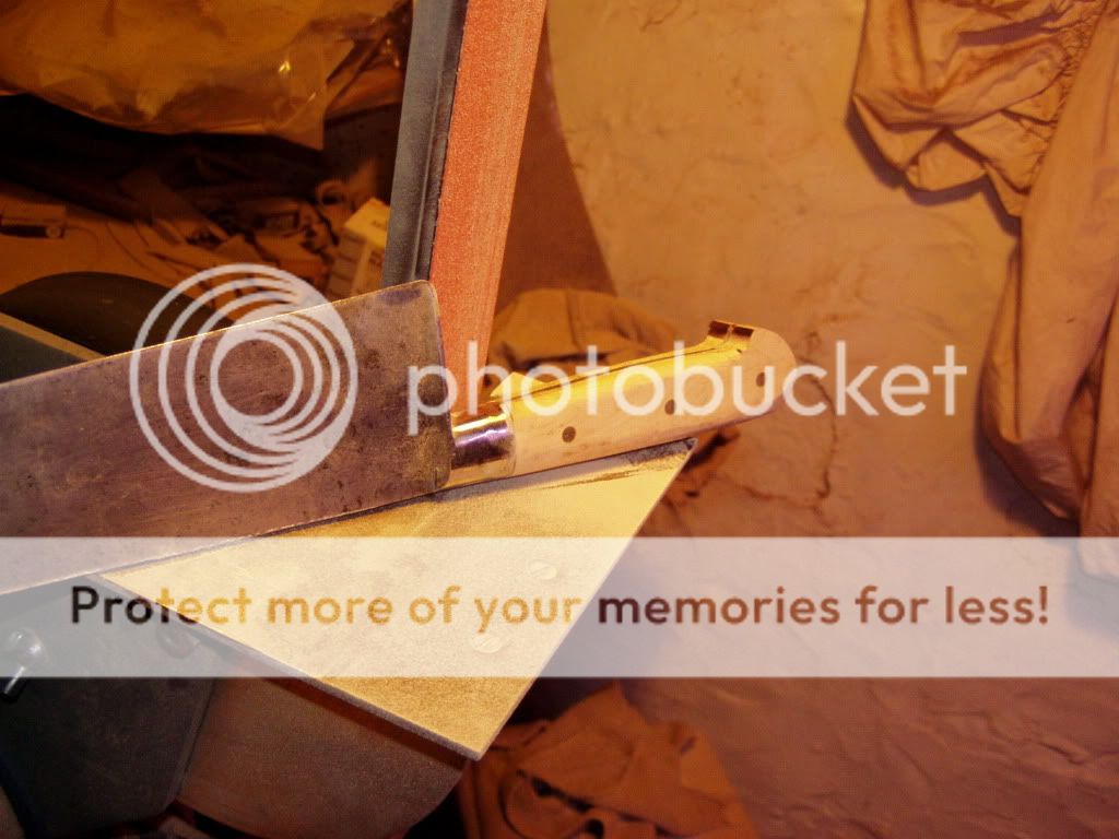

pins in the block:

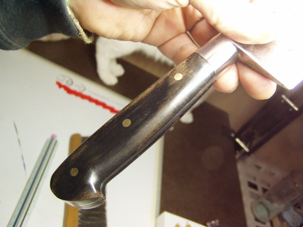

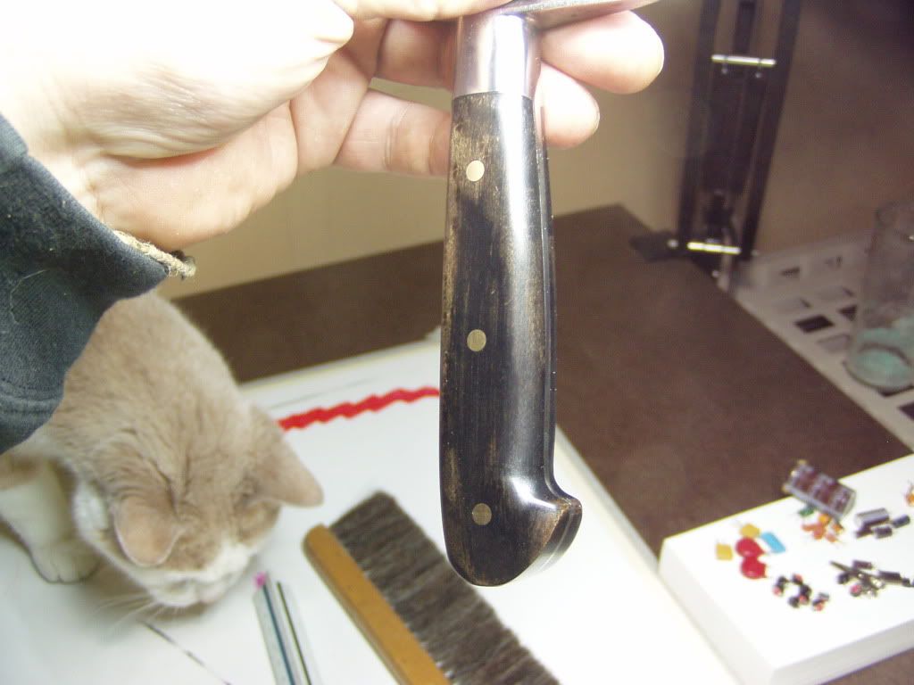

and finally, the handle glued up with 12 ton epoxy, good night knife, see you in the morning:
MORE TO COME..
BEFORE
AFTER
HOLES DRILLED:
