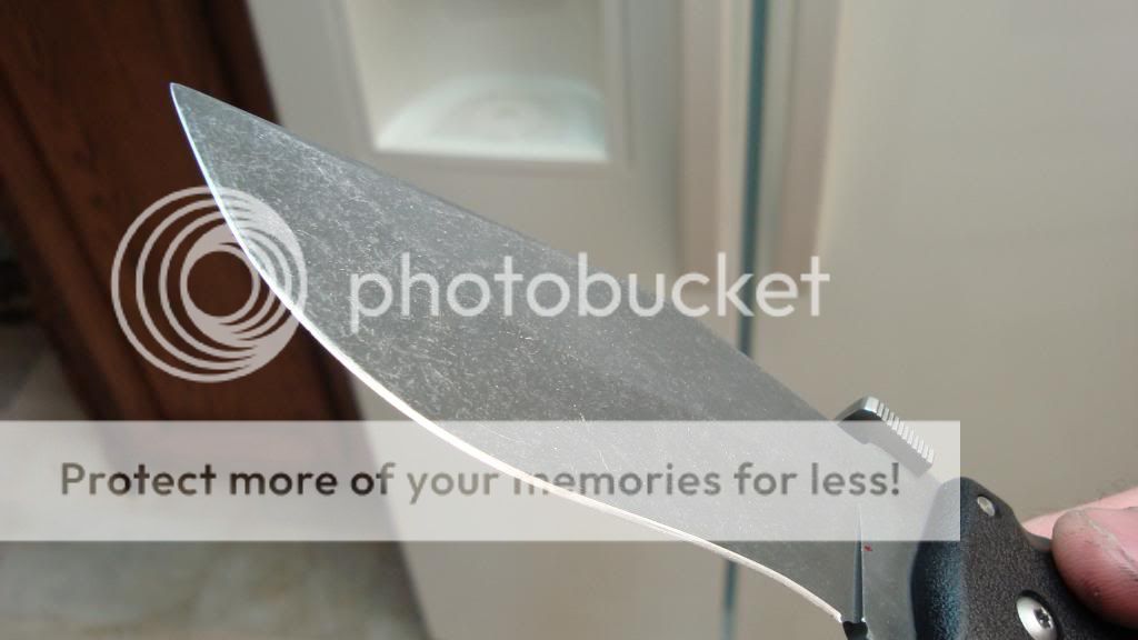

I got this baby yesterday in the mail and decided it would look awesome with a dark acid stonewash. One day and some ferric acid later, this thing looks great.

Very, very cool
How did you apply the ferric acid? Looks good.
Glass jar, 1 part acid to about 4 parts water. Soaked it in for about 8 or 9 minutes checking constantly to make sure it didnt get too dark. Use nail polish to keep the acid off of the pivot area and lock engagement surfaces.

Very nice effect on that blade. Can't say I like the Spartan much, but I think you've improved the look of it 100%. :thumbup:

Thanks, I just really dont enjoy bead blasted finishes much anymore. Stonewash, acid etched, mirror polish, all preferable. I do want to get into duracoating as well for my super heavy duty knives

Did you put nail polish in the edge bevel was well? Towards the tip it looks a bit wonky in how much it thins out.
That looks amazing! Where did you buy the acid? Think I might try This myself.
Radio shack. Its PCB etchant, cost about 11 dollars.

Nope, since its AUS8 its soft and I had to reprofile it anyway cause the edge as it came to me was somewhat thick, i didnt bother.
