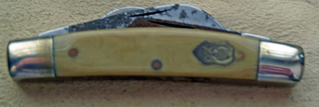

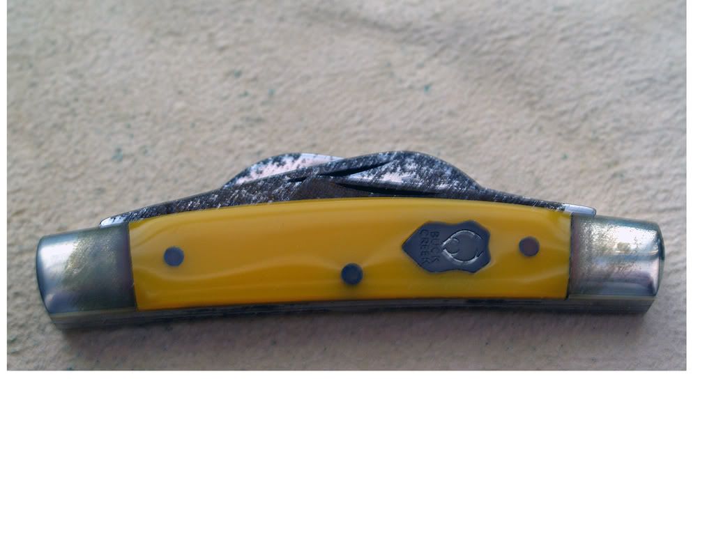

Here are 3 Knives I pulled out of a knife roll a day or 2 ago. Celluloid scaled knives will ruin themselves and every carbon Bladed knife in their vicinity. This is the reason I wouldn't buy one at all. These are 1990's Knives.:grumpy:

I've heard from more than one source that the more filler (colors) a piece of cell has, the lower the chances of it gassing off. It seems to hold true in my experience. I've some black cell knives from the 20s- a Remington regular jack and an LF&C Scout- and neither has even shrunk. Compare that with a 1950s Imperial in cracked ice that has shrunken significantly, and there is a possibility.

The "End of Day" celluloid knives have never given my any problems. The other ones I store with the blades open with tuff-glide on them and on a closet shelf with the backsprings facing up. I never keep them stored inside anything and keep them open to the air. I never keep them enclosed in anything except Sack-ups and keep them on a shelf as well. Never keep them in their boxes. This seems to work out pretty good. The newer ones are acrylic and I don't worry about them much but still keep them seperate and open to the air. I too learned the hard way.
