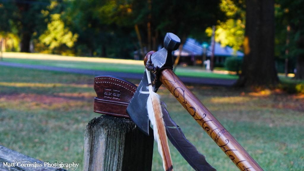

Hey everybody! I just wanted to show a Rifleman's Hawk Mod I done for the Pastor of my local Church. I wanted to do something nice for Pastor Appreciation Month so I figured this would suffice!
I think it turned out pretty good! Below are some pics and a tutorial video I made. Let me know if you guys have any questions!
Here is the video, Pics are below it
[video=youtube;_ukyMAXY0WA]https://www.youtube.com/watch?v=_ukyMAXY0WA&list=UUhqeuImAeioOd9DJLid8Adw[/video]

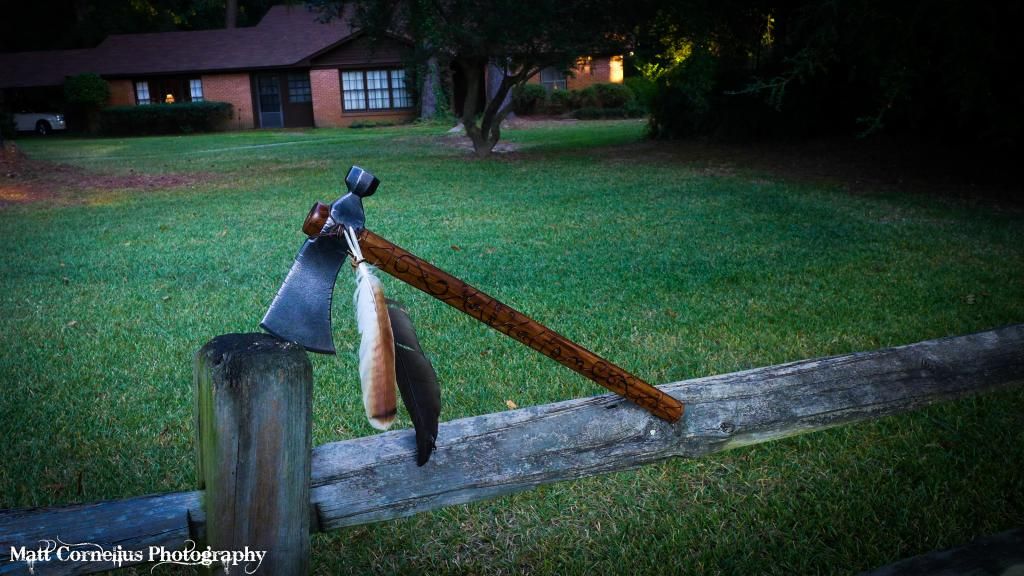

Here is the outcome!

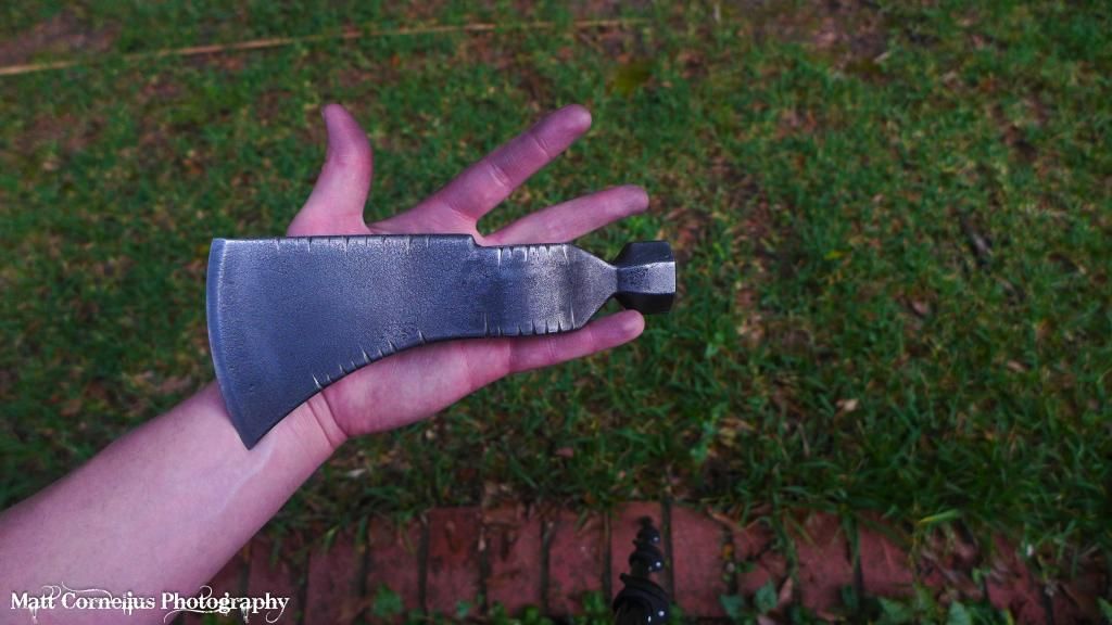

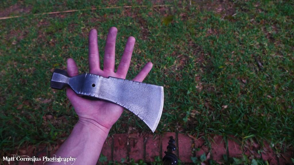

I stripped the head of the black coating.
I then added some file work to the head coated it with some super gun blue. After applying the gub blue I lightly sanded with 3000 grit sandpaper to bring out the pits in the head.

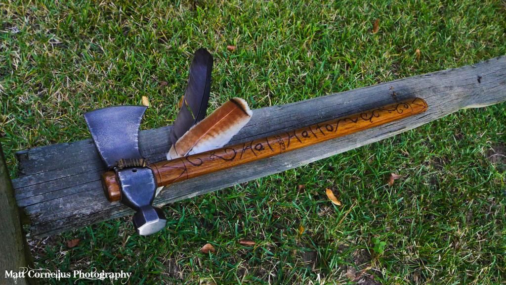

I added some Hawk Feathers (These were giving to me!)
I sanded the Shaft and drew my designs on with a pencil (inspired from the movie The Patriot) and the used my woodburning tool and traced over my pencil markings.

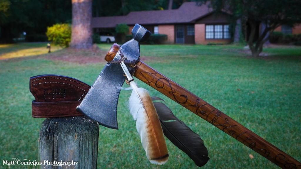

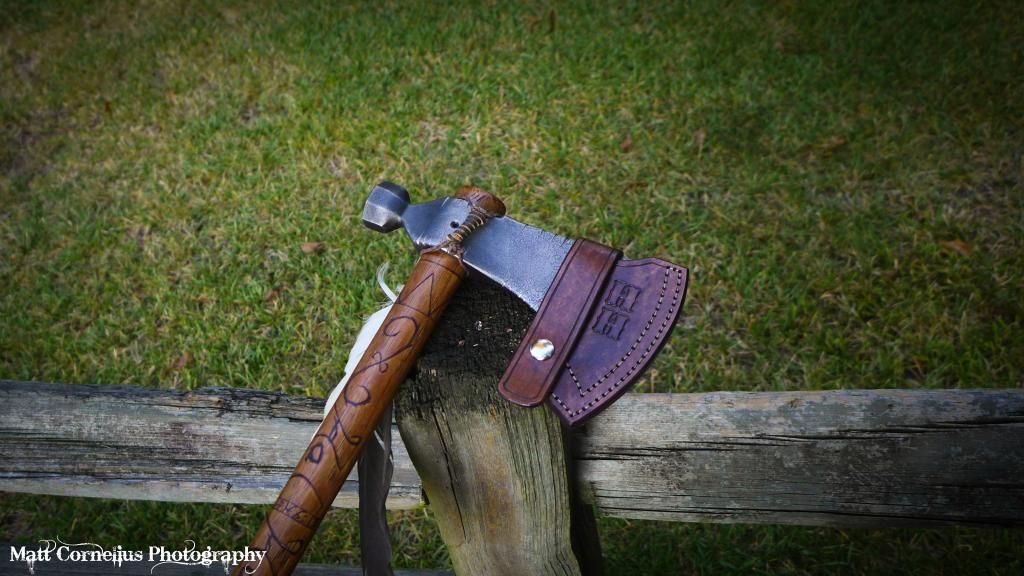

The sheath I got from www.walkbyfaith777.com It was only $20 and has my Pastors initials on it.
I used a few coats of special walnut then realized I was using the wrong stain. I then put one final coat of English Chesnut on it.
It came out a hybrid color but still looks decent. I then followed with 3 generous coats of spray polyurethane clear satin.
