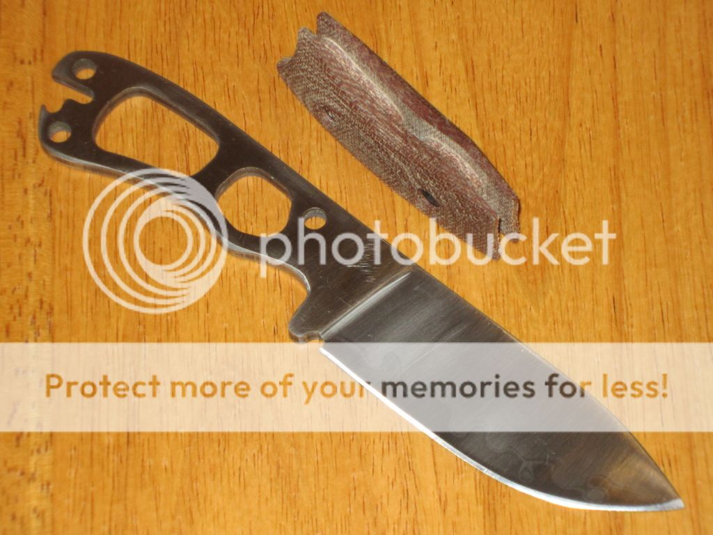

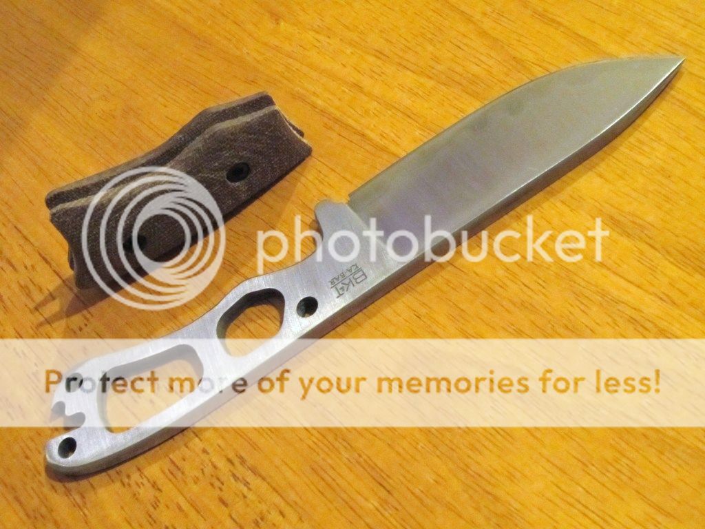

Alright, here's my Becker BK-11 CSM after sanding with 400 Grit for the past three and a half hours (3.5hrs) by hand.
My hands, wrists, elbows, and shoulders are aching for lack of a better word. The work in progress on this Necker continues.

It appears as if you are rounding the butt of the knife. If you lift the sanding block at the end of the stroke that will not happen. Sorry if I come off as rude or abrasive, that is not my intention.:o

spine to belly is the hard way. sanding lengthwise is way easier, and keeps the sanding block aligned.
start at 45deg to your final finish direction.
then go 90deg to that.
back and forth on those two angles until the lengthwise (or cross-knife) scratches are gone.
then go lengthwise to clean up the diagonal scratches.
When the diagonal scratches are gone, go up a grit and repeat on the diagonals.
This is how you know you've completed a grit. Also, it's more efficient from an abrasive standpoint to switch directions each past.
It does appear that way, but I think that when I received this knife it was already somewhat "rounded" in that section. Hopefully I didn't increase that. Thanks for the suggestion!
Thank you for that advice. I'll incorporate it!
