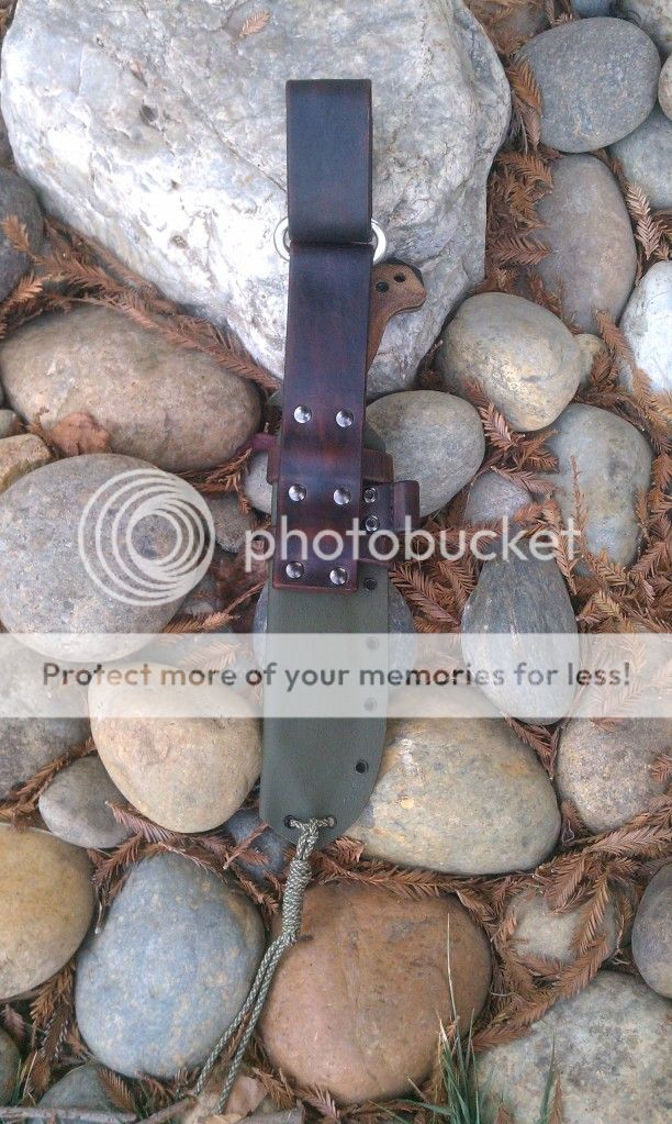

haven't made a machax sheath in a long time so I wanted to show it off. This is an od green .080 kydex with 9 oz. stained dark brown leather. belt loop is removable for scout carry or attach to your pack horizontally. This set up is made for a right handed person but can be all unscrewed for a left handed person or set it up as a cross draw. I will be adding a dangler loop with a 5/15" quick link and 3' of cord to tie around leg...
Sick work bro! Thats a beautiful piece.
Thanks! this is one of the few sheaths for the machax i have made, notice the 710 on back side? didn't want to make that noticable so you can't really see it unless you look for it.
Damn. This is like backwards Sagewoodgear :P
I like this idea a lot. Don't doubt me as a future customer... I just have to acquire $$$ first.
