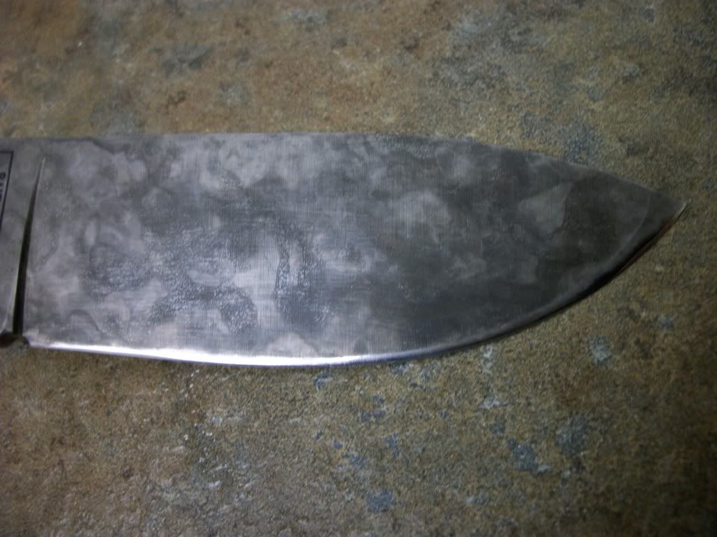

I want to put a patina on it to make it look cooler than it already is. I can only think of doing a grapefruit patina because it looks super cool but I want some other ideas before I go ahead and do that. Also do I need to oil it after a patina?
Here's how it looks right now:
Yeah, you should oil it after. You can use yellow mustard and Siracha as a patina. You can slice jalapeños and place them on it. I like to do hot apple cider vinegar, it takes a while, and makes the house smell terrible, but you can get your blade almost black. Orange slices, ect.
a polish looks cool too! I only took this one up to 1000 grit. I still want to go steeper.

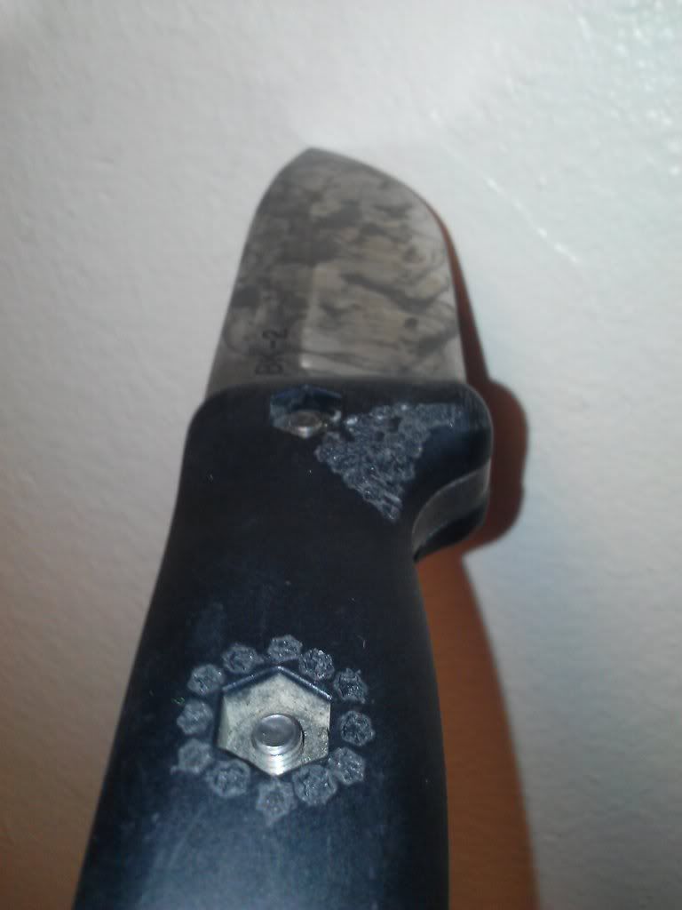

I like doing outlined tiger stripes with mustard, or the most recent one I have put on my bk2 is a "Smokey " like patina, its pretty sweet.
That one is alot darker than it looks on the pictures, the darker looking spots are pretty much black. It was done with some famous New Mexico salsa! :D

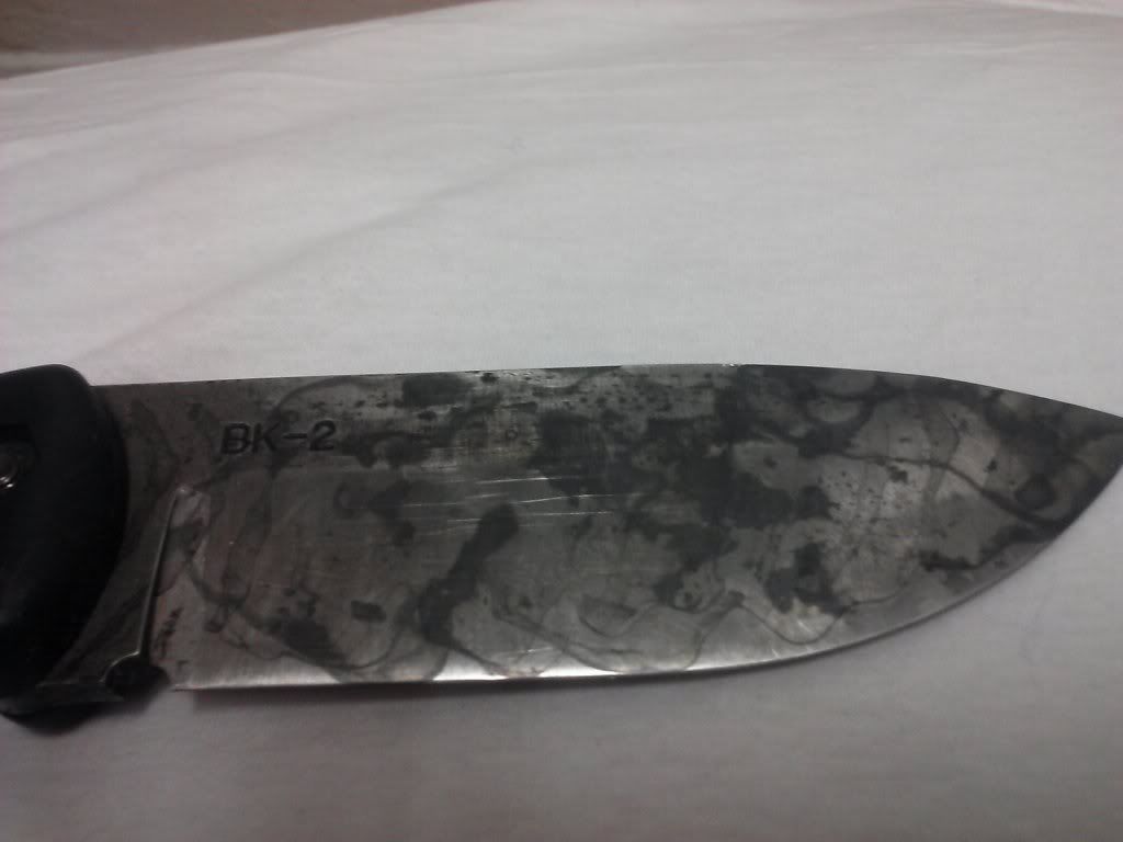

I was frustrated at the slow pace of some of the suggested methods above. If you Google patina, responses will suggest hydrogen Peroxide, salt and vinegar. I tried this recipe and the results were quick, very quick.
I used pasta sauce for this patina. I just smeared it all over the blade and let sit for ten min or so then repeated the process a few times until I had a good pattern going.
This is what it looked like before the patina.
