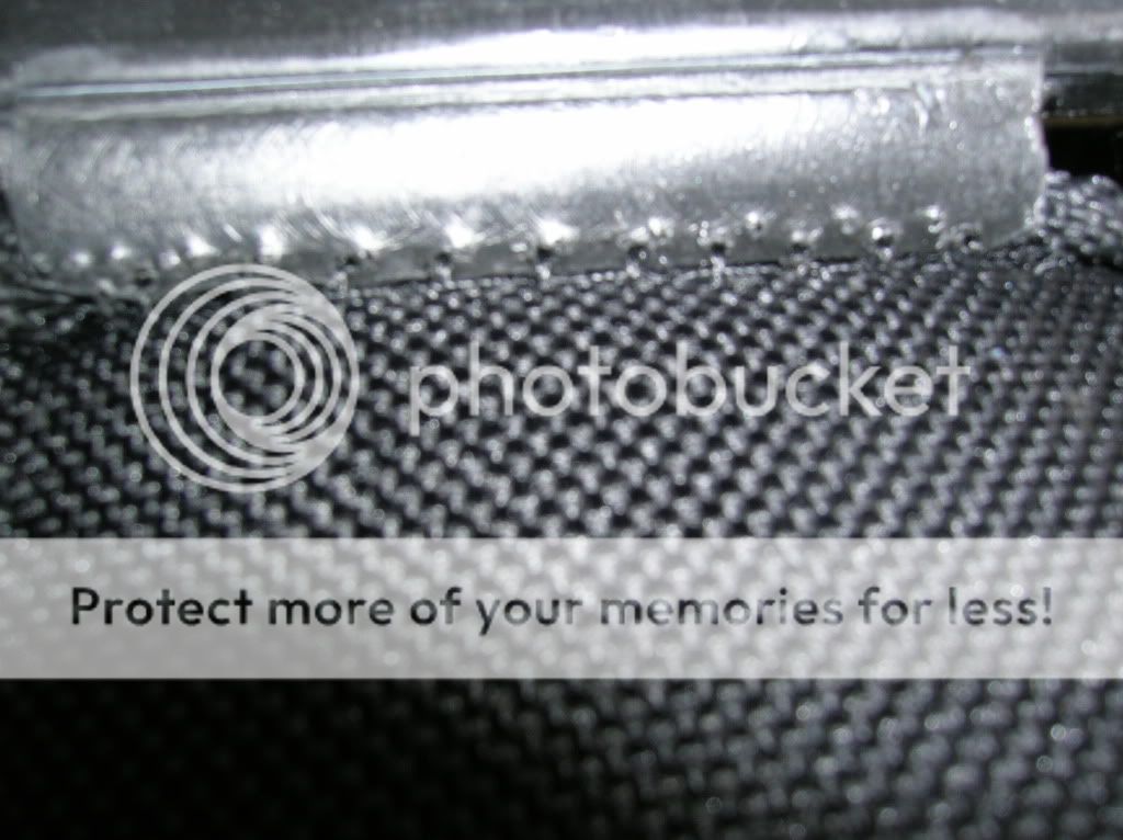

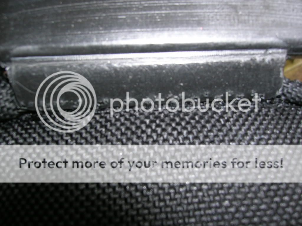

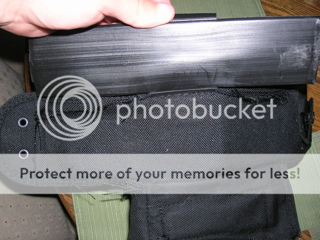

So I know there is lots of talk about the BK9 sheath. I read the posts on how to remove the insert so that I could heat it up (boiling,heat gun) to remove the rattle. Well I tried and tried to remove the insert and just could not get it out. I have worked on it three separate times and finally got frustrated and cut the sheath to find out the problem. Turns out the insert was actually sewn in to the sheath. I have pictures but no way to post them. I can email to someone that can post the pictures. I have a kydex sheath for the BK9 so I really didn't need the stock sheath. I just wanted to understand and post the problem for future owners that have a hard time removing the insert. Thanks!

Thanks slapper! As you can all see by these high quality pics (sarcasm!) the insert was sewn in there on one side pretty good. You can also see the plier marks where I tried to get the insert out. If the insert looks a little deformed it is because I tried to boil the whole sheath and work it so I could try to get the insert out.

That must be a new thing, all the inserts I have removed were just glued in. Interesting to know but sucks you had to cut your sheath

It won't hurt your sheath. It will pop right out with no damage, but you gotta swell up and yank on it. (that might not have come out the way I meant)
I pulled a chunk of insert the size of my plier jaws off of my insert trying to get it out, with the bottom of the sheath tied to my deck. Then I just cut the back stitching, pulled it out, stuck it in the oven at 350 for about 5 minutes checking every minute, and clamped it til it cooled, sewed it back in and voila. Snug enough that it won't fall out held upside down without the retainer fastened.
