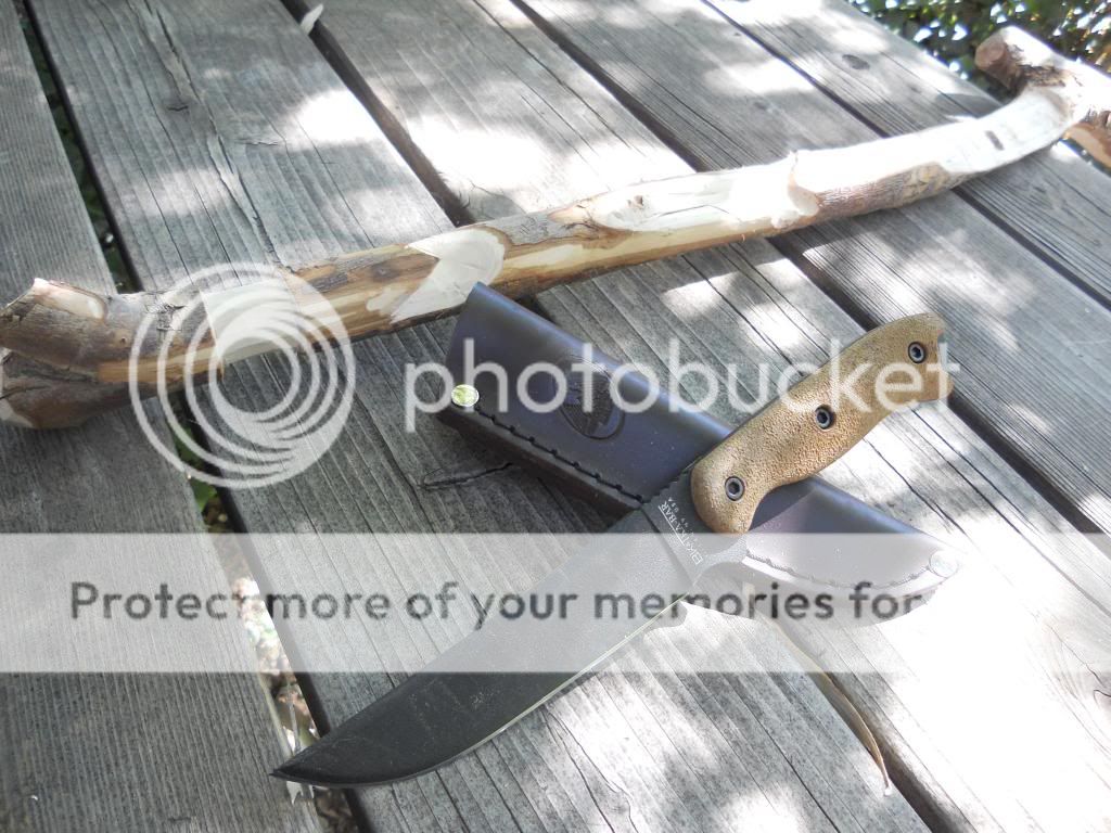

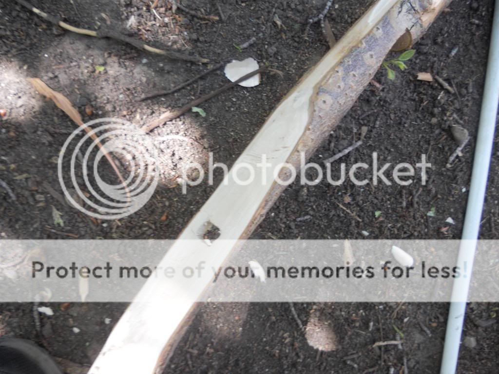

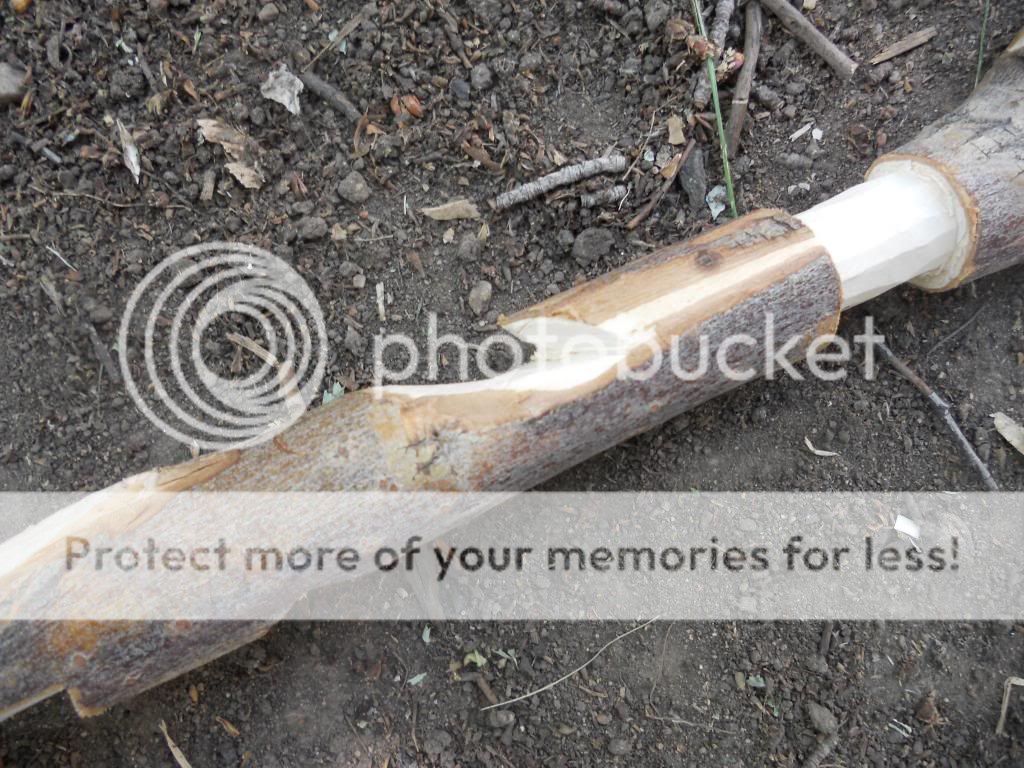

A few weeks ago I decided to make a Kochanski Try stick (google it) to improve my knifecraft. I decided to use my BK-15 to do the job, since it fits more or less within Mors Kochanski's ideal bush knife parameters, and I needed a stabby point to do some of the tougher notches.
I was curious how durable the 15's edge really is, so I decided to test it after every three notches. Well, after every three notches the 15 would still cleanly slice through notebook paper and then I would strop it five times a side and keep going. I did this for two hours or so and finished up by cross-batoning through a three inch thick piece of seasoned wood. it would still slice paper after that, and once I stropped it a final time, would still shave the hair off my leg. To say that I was impressed would be an understatement. The one Becker model I thought would be the least robust not only stayed razor sharp with a little maintenance, but took a solid beating with a club and kept going strong.
This is not the only time when I've been amazed at the Becker edge retention. I'm always surprised how well they stay sharp, especially the convexed ones. My 15 is unique by being a dual grind. I convexed it first to make the edge nice and thin and to smooth out the powdercoating, and after a couple of months of bushcraft use, decided to put a 40 degree inclusive v-grind on it with my KME sharpener so that the edge would bite into wood better than a convex edge will. This has turned out to be a phenomenal set up for the 15, giving it a perfect v-grind combined with a high relief edge. Slicey as hell.
