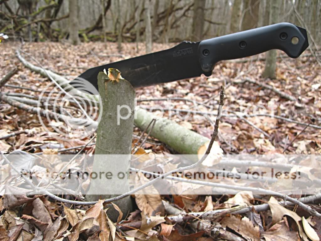

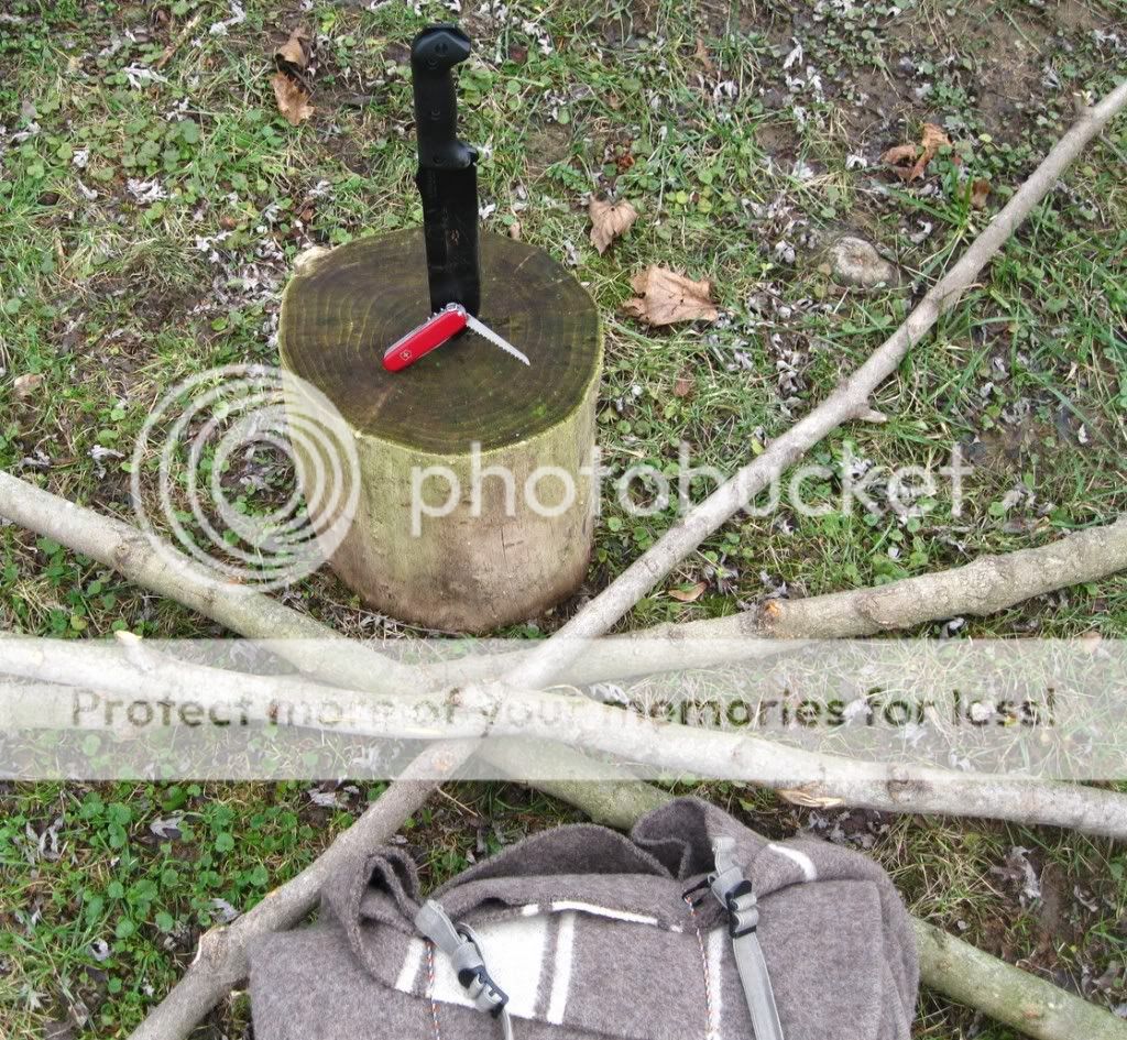

Cut some poles - I use four per chair with each pole being six or seven feet long. This one is thicker than necessary but I like overbuilt stuff - what can I say...

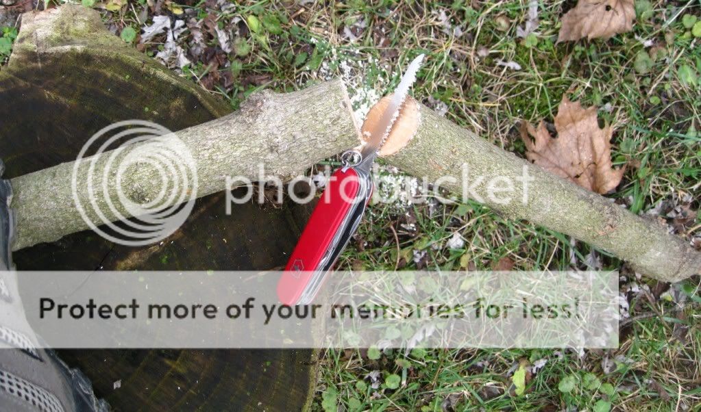

There was another thread recently about backup blades. With that in mind, I decided to use my 'backup' blade - my Vic Huntsman - to smooth out a few spots and to saw off a thumping stick...

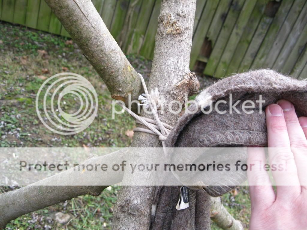

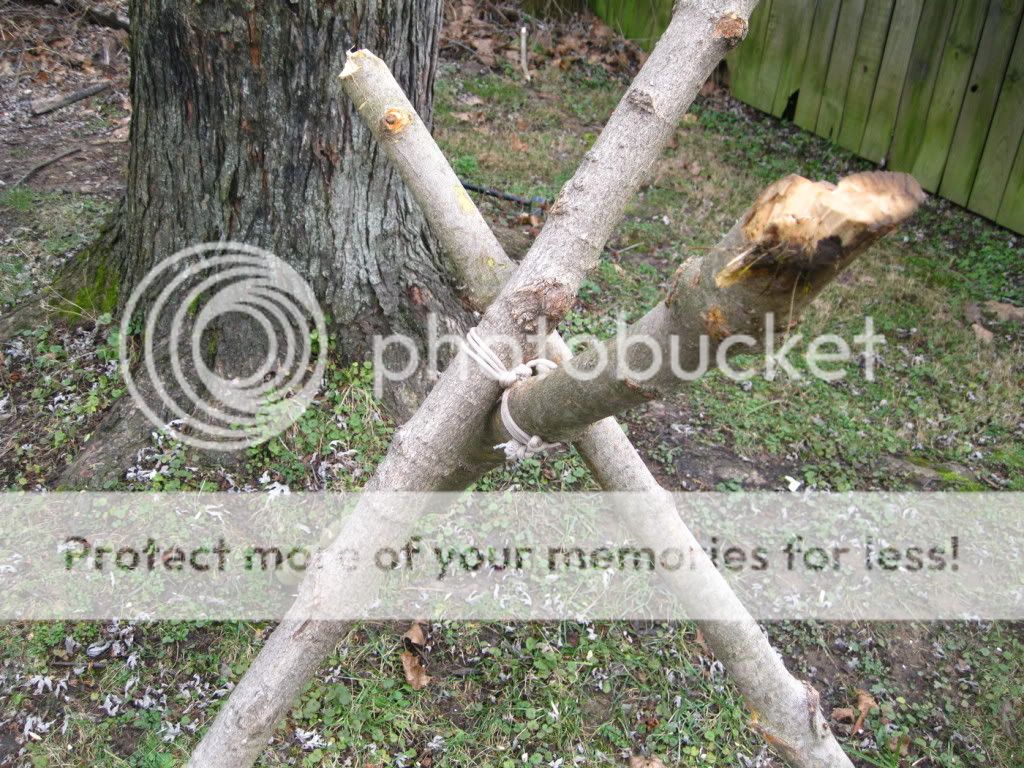

Make a tripod. Here's a closeup of how I fastened the top of the tripod. Watch out for the pointy bit of that forward pole..

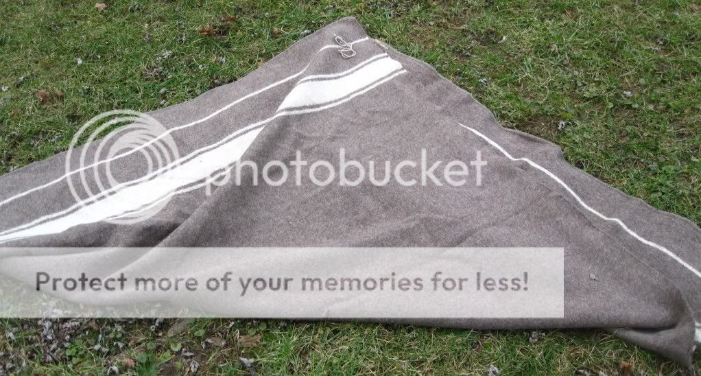

There are better seat materials but I'm using a thick wool blanket. Fold it and fasten the top bit with some paracord lark's-headed around the material and fasten that to the top of the rearmost pole...

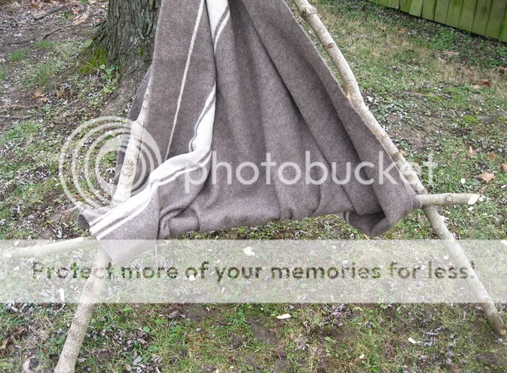

Run the fourth pole through the fold in the blanket...
