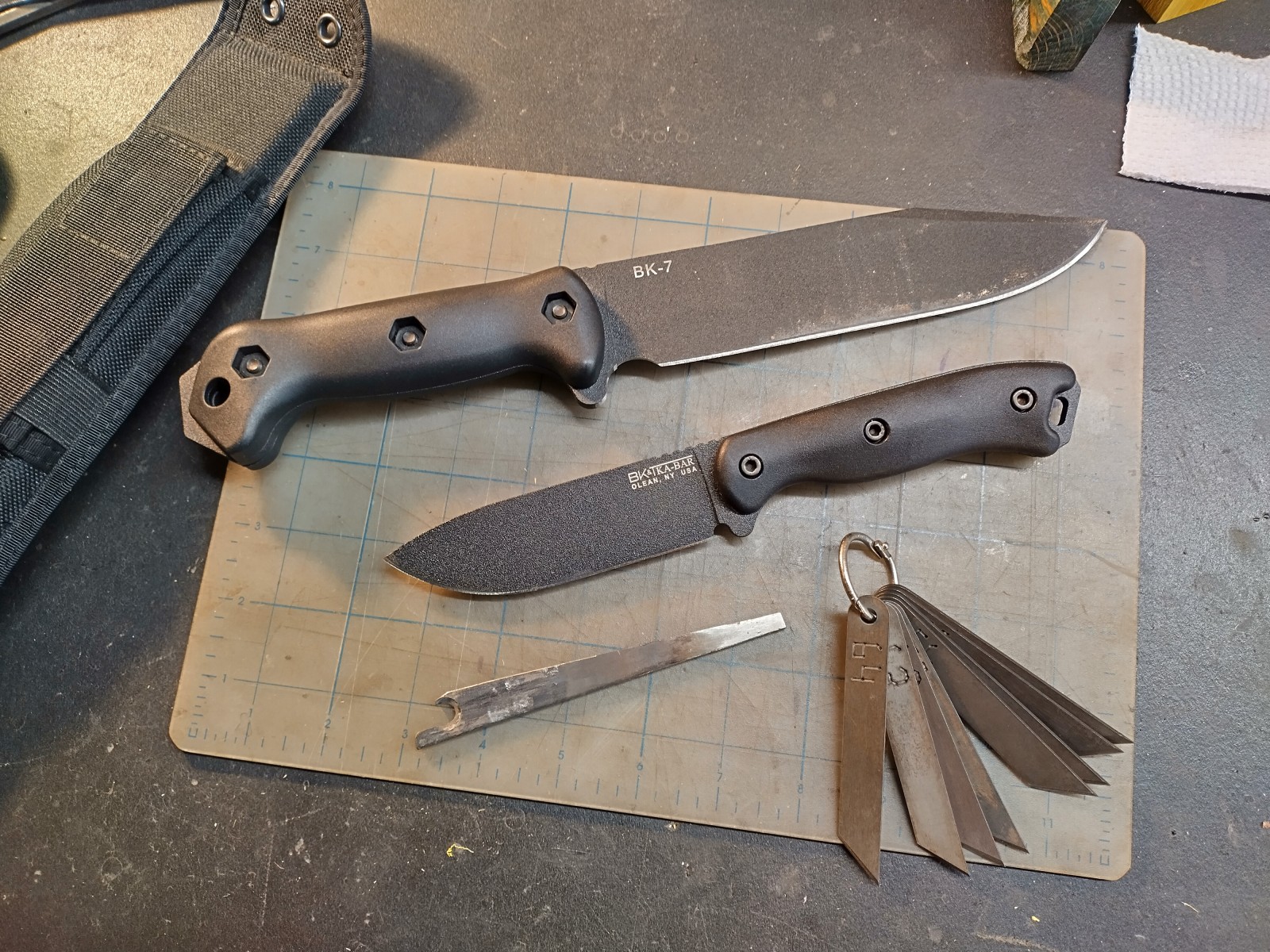

I've got two Beckers sitting on the kitchen table to go to the shop with me shortly. I'll check a couple spots with my chisels.

We can criticize his methods, but it's also entirely possible that he got a lemon. Or that Kabar's process has recently slipped, or something. I'm a pretty big Becker fan, and think Kabar does a great job with them, but sometimes crap happens. The question is whether his tests are valid and if his sample is representative.
This afternoon I took my BK-16 (I have two) and BK-7 over to the shop to poke at them in a limited fashion. Both of these knives are probably ~10 years old at this point (EGAD). I got both of them at Beckerhead-East Gatherings.
The edge bevel on the BK-16 felt like ~57Rc under the hardness chisels (from Matt Parkinson). It was able to carve a bit of unhardened 1084, though the edge rolled slightly under the torque - a pretty brutal test.
The BK-7 is quite modified, so I had many places to test where not only was there no coating, but also definitely no decarb. I would call it 58-59. It was HARD all over front half of the knife, not only on the edge bevel, but also the spine where Wayne's friends used to be, and also on the front of the waddle behind the choil. This blade is beefier behind the edge and carved the unhardened 1084 like it was nothing. It also felt slightly harder than the BK-16 when I waved a steel across the edge and stropped it quickly.
So there you have it. I have two that are convincingly up to spec. 🤷‍♀️
