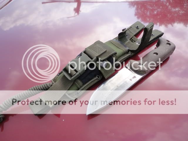

Incoming.

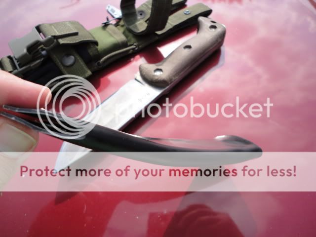

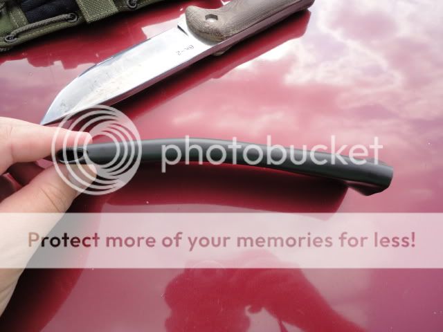

my great photog skills:)
the insert is very arched, Im sure I could boil in some water and place the knife in and straighten out
I recently picked up 4 combat masters and noticed 1 of each size had overly rounded inserts. I had to boil em and press em down a bit. The survival looks nice too but I like the pocket on the combat masters because I'm afraid I won't latch shit properly and lose it.
is the knife insert supposed to be this rounded?
That's factory. Spec Ops used to bow them more for retention.
They also used to let the liner ride high above the nylon, but they brought them down because of IR reflectivity.
Honestly, that's what they told me over the phone.
not tat i need more sheaths, but b2/10/12 sizedvspecops would be useful to locate
Their supposed to be bent. don't straighten them out, unless you want your blade to fall out.
was thinking if i got the plastic super hot it would form to the blade, no?
It will form some, not like kydex though. still keep it bent if you can. If your putting a knife with a thumbramp in it, you'll have to mold it to the ramp anyway. Heat gun is fast, hair dryer is slow.
