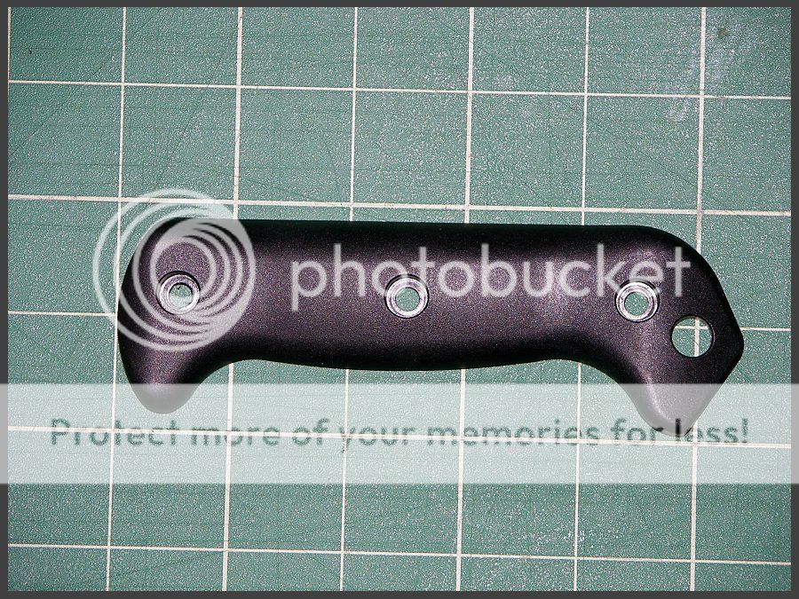

I’m just getting back into buckskinning after a 5 year hiatus and started looking for better equipment. One of the weak spots in my gear is a good, tough sheath knife. I’ve built and used my own for years, but never really trusted them for serious work batoning and such. I’ve actually broken a couple blades doing so and was not a big deal as I just whipped up another at the next workshop.
I’ve decided to stop screwing around with sub-par blades and get a real knife built to take the abuse. The BK-2 caught my eye as a great tool for chopping, batoning, and all sorts of heavy use. With a little modification, could even pass for a historical looking blade. Heavy choppers like the Hudson Bay Camp Knife come to mind when I look at the profile. I was thinking that after stripping the coating, a little forced patina, some nice curly maple scales, and a nice leather sheath, the BK2 could make for a very passable historical knife.
I plan on purchasing the blade next week and am gathering materials for the project. My question: can anyone give me the dimensions of the scales I would need to recreate the grivory grips out of wood, bone, or antler?

The dimensions would be hard to just post without a blue print, the shape is hard to explain on each dimension, the best thing to do is wait until you get the BK2 and then take measurements yourself....
I'd probably go with a 6 inch long, 3 inch wide, 3/4 inch deep piece of wood for each handle. That would accommodate the initial tracing and allow you to sand down the depth of the handle dependent on any spacers you use.

the grid size is 1"x1" square so 2"x6"x1/2" piece of wood is big enough to create an exact duplicate.
I'm just curious on the thickness the one posted is 1/2" are the other styles also 1/2"?
Yes, they are the same thickness and can be placed on all knives of size from the BKT lineup. The only thing that changes the handle thickness is the handle stock thickness.
