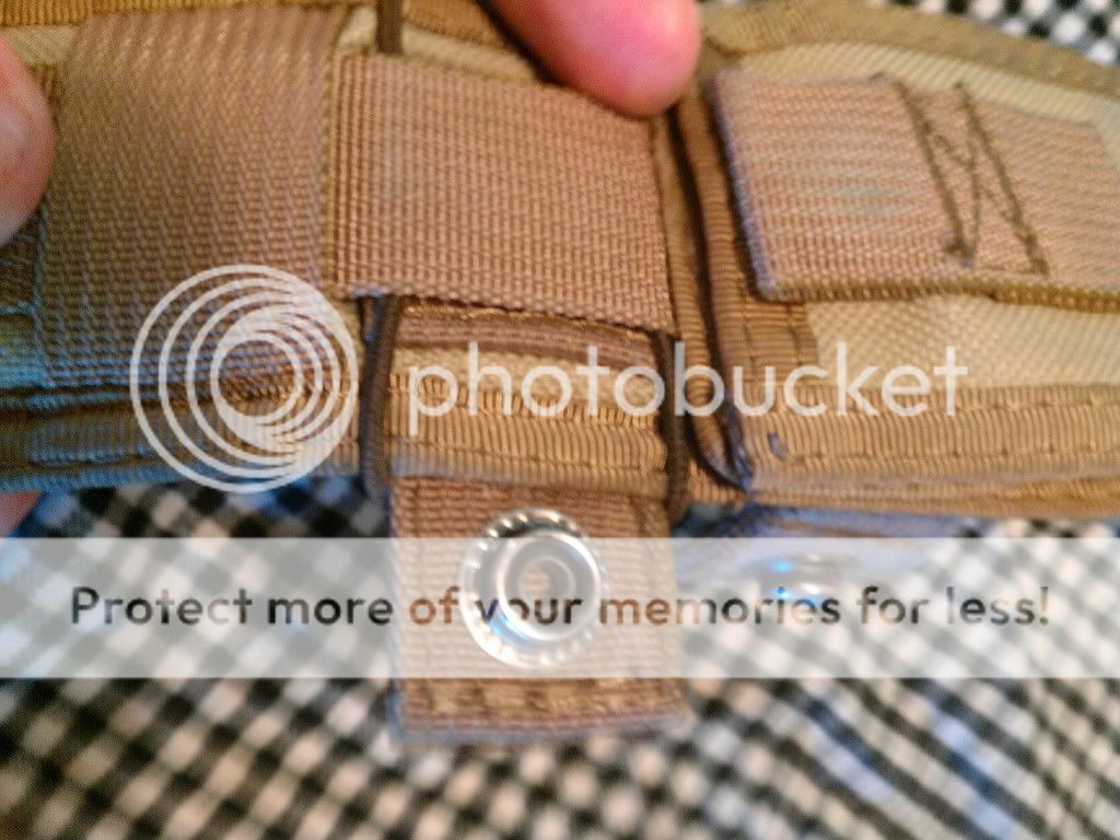

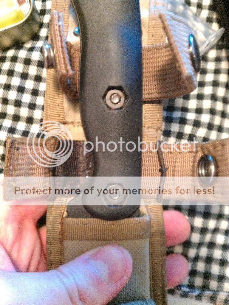

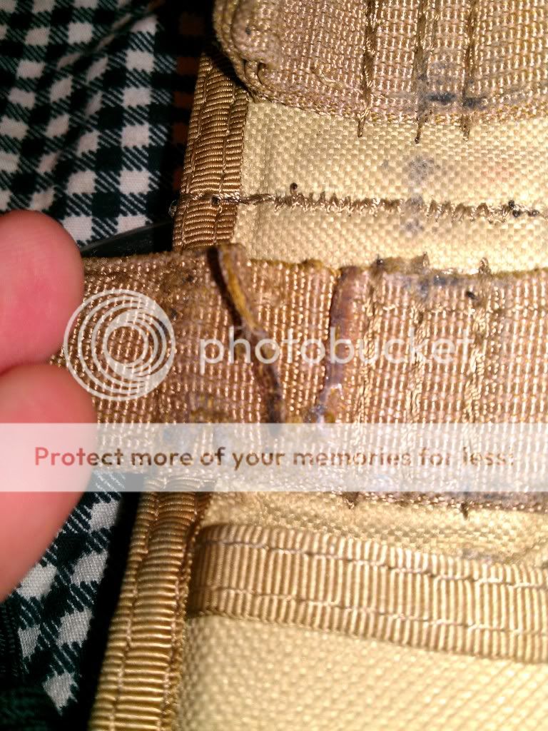

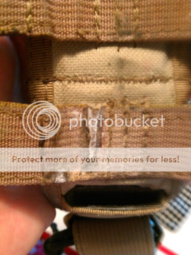

This picture shows the cut that has been made by multiple draws of the blade. There are ways to keep this from happening by drawing the blade with your index finger keeping the strap out of the way... but wheres the fun in that? The real cut was a lot "fuzzier" than this but I have already burned this with a lighter beforehand...

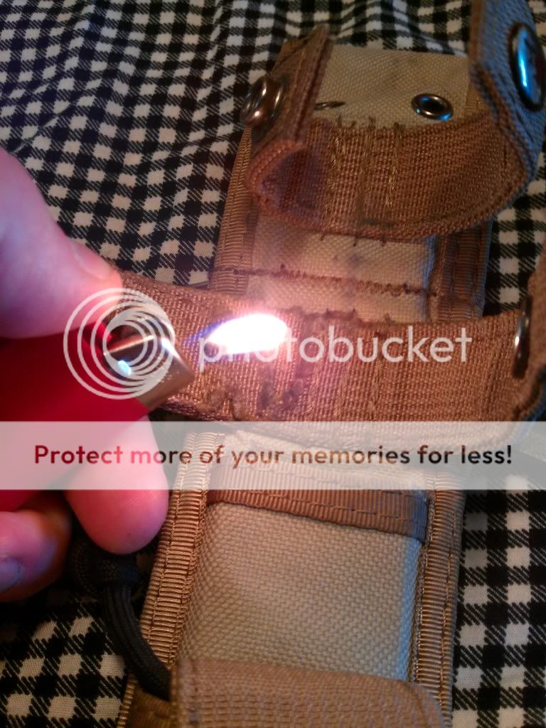

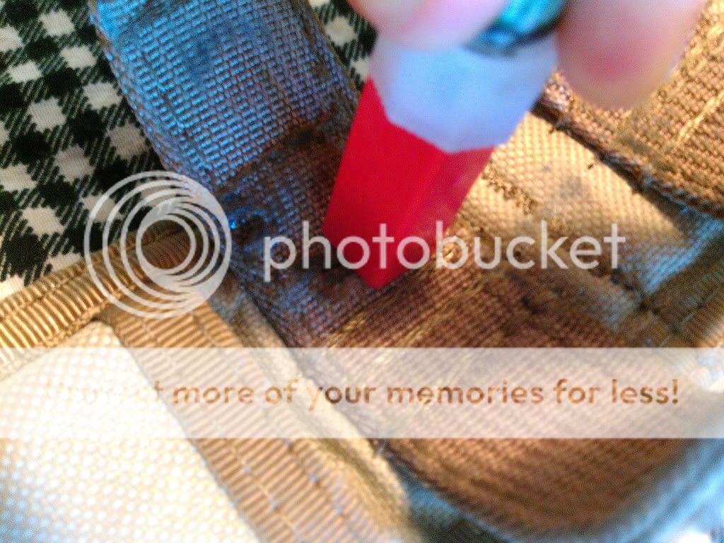

Next burn the burrs and fuzzys off the affect area with some FIRE!

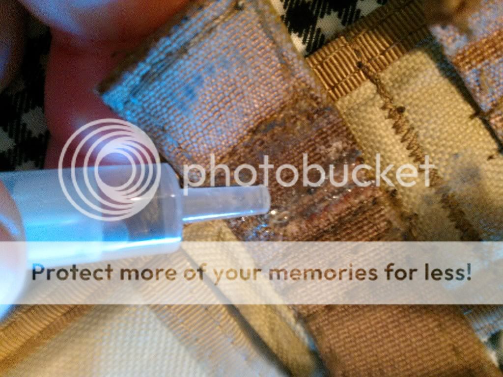

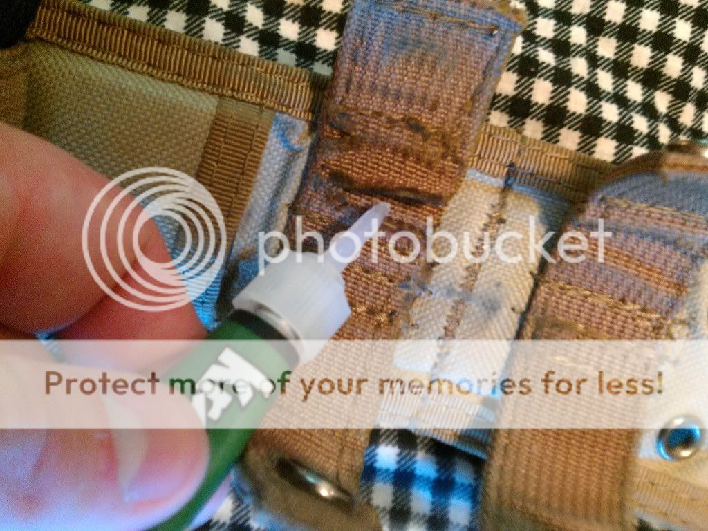

Next apply some super glue to keep the flap down, reinforce the area and repair the damage... This will also stiffen up the sheath in an important area to help us out later.

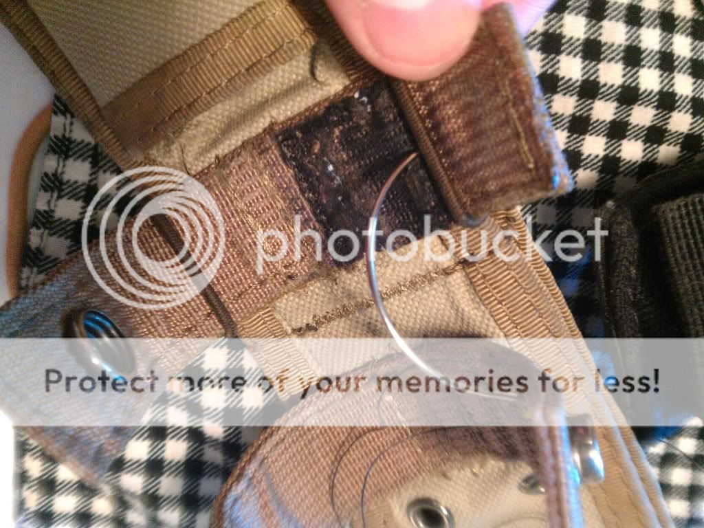

Some brands of super glue have lids that typically wont get stuck to glue, at least that is my observation... So use the lid of the glue to apply pressure to the glued area for at least 30 seconds or until solid. DO NOT use your finger unless you want to be closer to your Becker sheath for awhile...
If you are impatient like me use a dropper to drop a small amount of water to the super glued area... this should cause the glue to instantly harden. Or it could mess your whole project up... either way be patient and wait for it to air dry... or gamble and use water... This has always worked for me but who knows if it will for you. :D

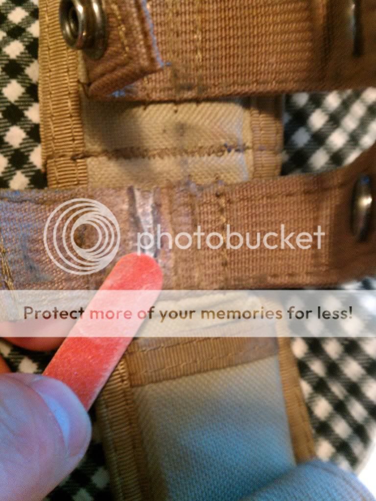

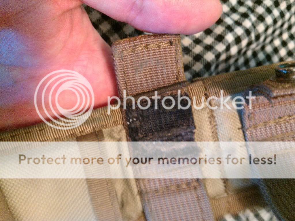

Next use an emery board to clean up any residual glue burrs and any excess.
Here is the repair... good as new! esque.... You will notice I took a sharpie and colored in the repair area in subsequent photos... Dunno why just wanted too!

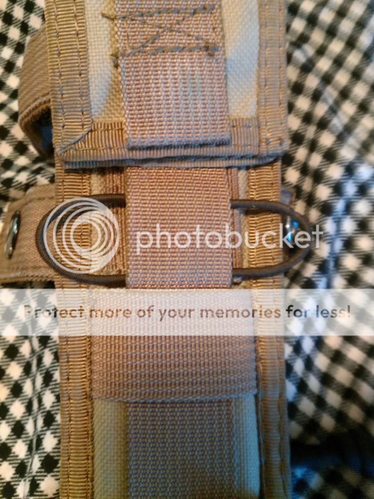

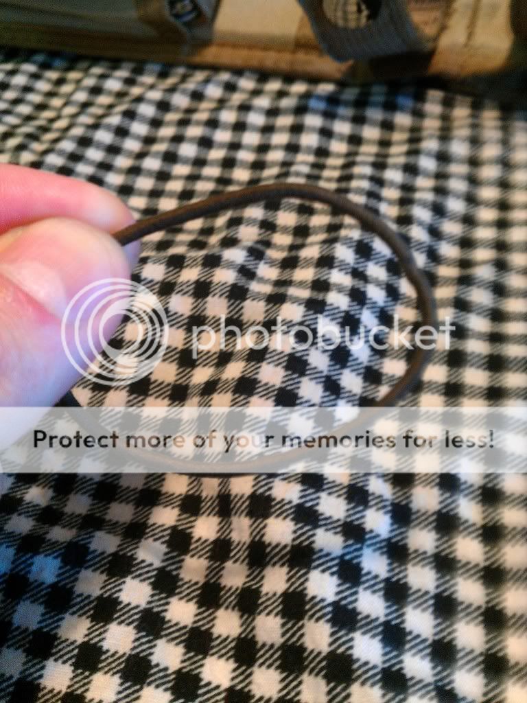

Select you a small hair tie or bungee loop/ring whatever. This is going to be our mod to keep the strap out of the way during future use.
Insert behind the knife between a molle loop.
Fold it over the strap to help pull back the snap.
With a crooked quilting needle (great item to have in an edc kit or in a bag with some thread... Will work for sutures or any repair) Sew a few passes around the bungee to keep it in place. The mod will work without the sewing but this way it will stay in place and be more effective. You might need a small pair of pliers or something to help you push the needle through. I just used the strap as a thimble.
Repeat on both sides and you are done! Burn off any excess burrs or threads and you are good to go... If done properly the strap will POP out of the way when unsnapped... This repair/Mod is super easy and takes all of 10-15 minutes to complete.

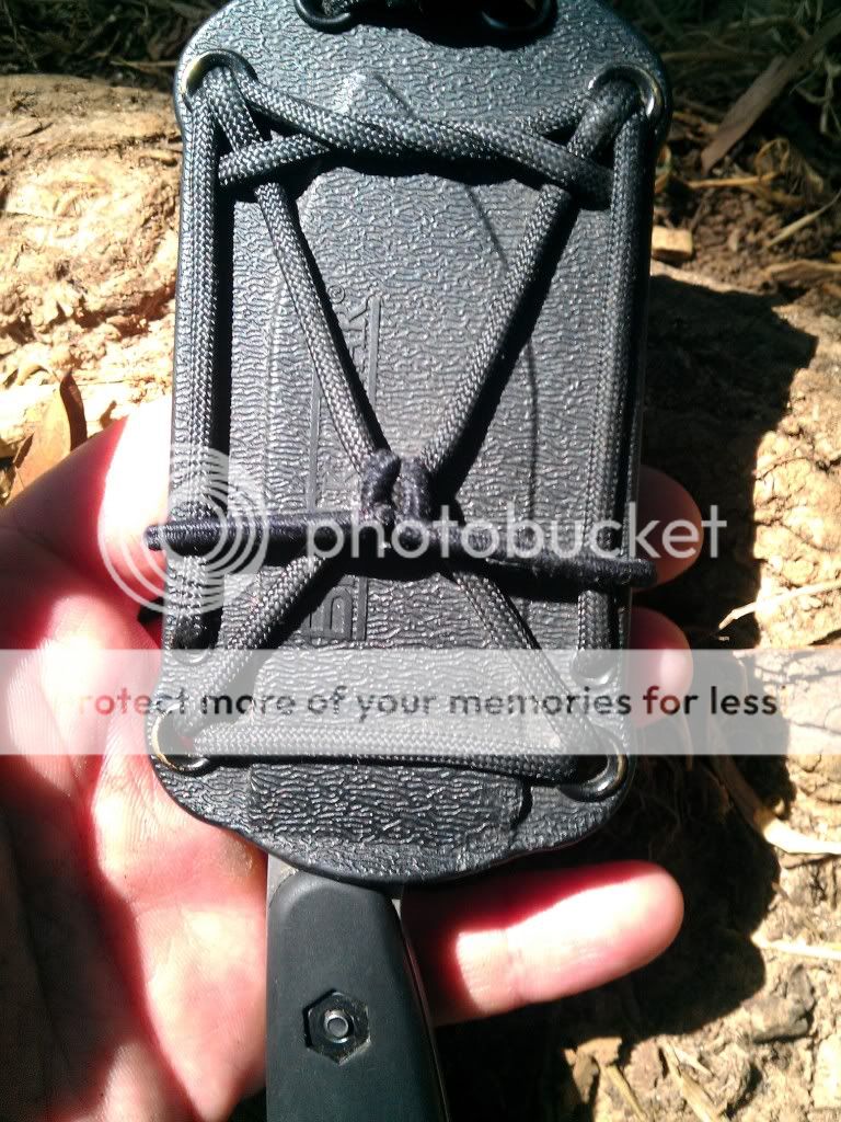

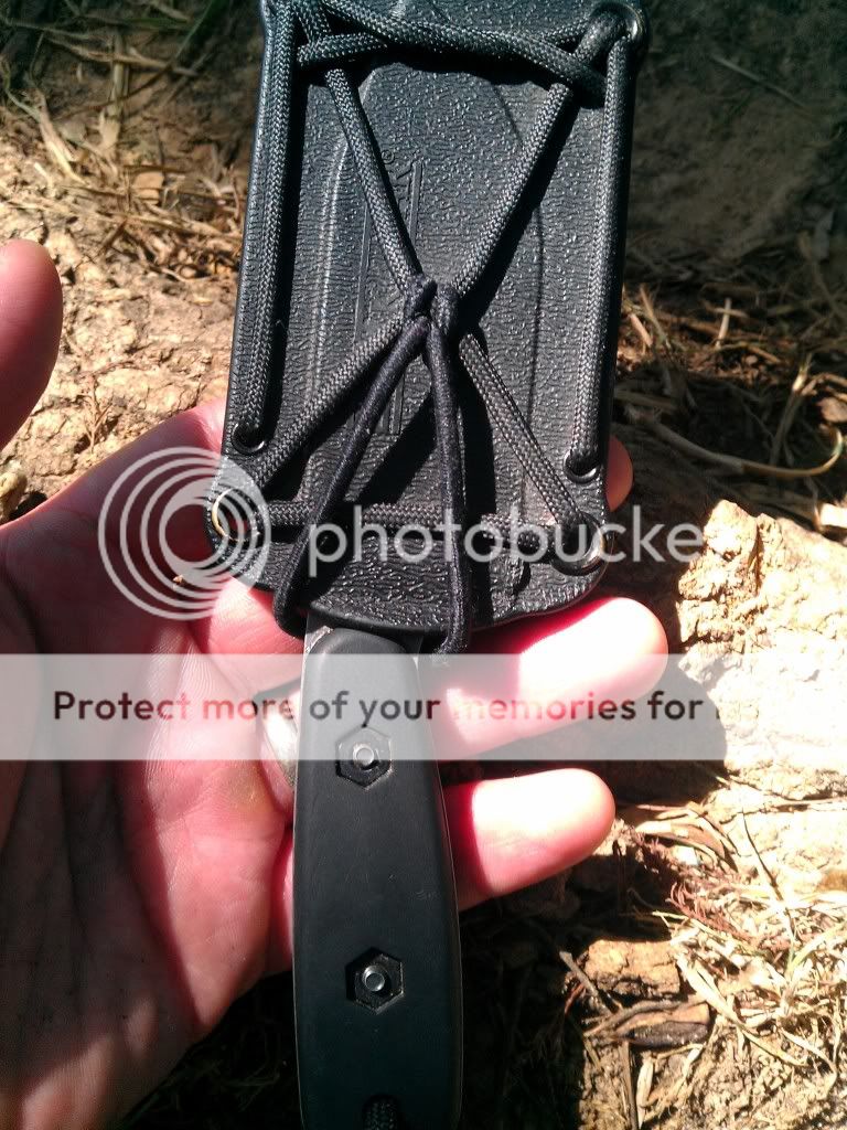

Yah with a wife and daughter there are always a few laying around here and there and I have found them very useful doing stuff for knives or packs... Here one I used as a retention strap for my bk14, simple, cheap, easy, and reversible.

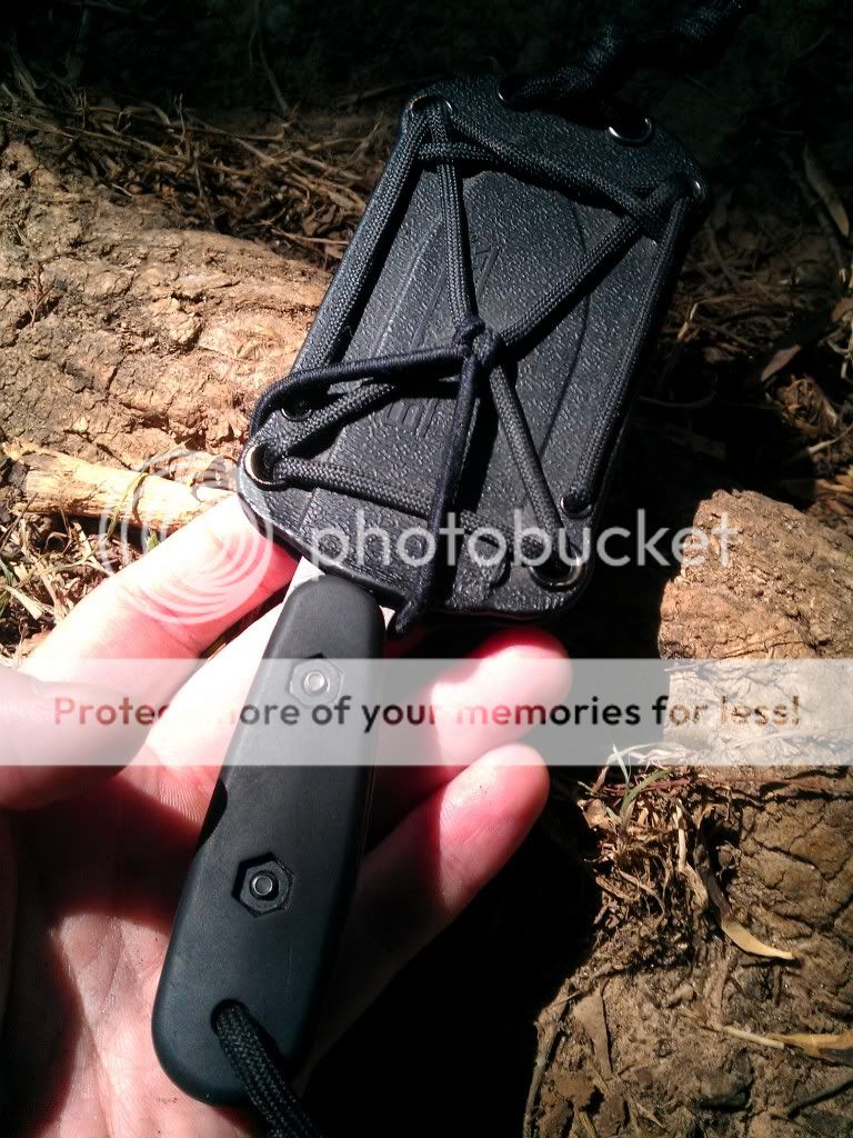

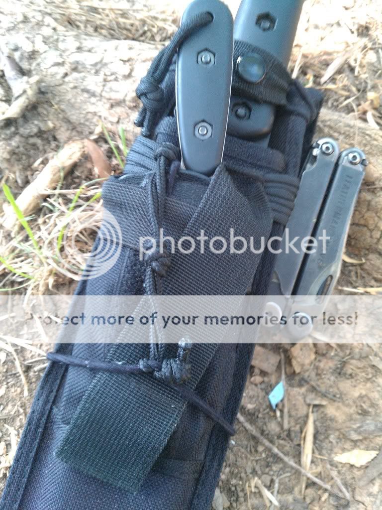

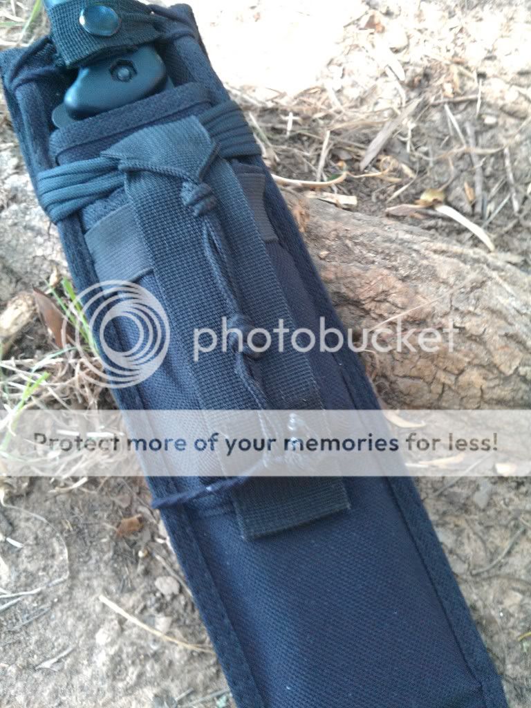

For some more hair tie mod madness here is a retention strap made with a bungee and a piece of cordage to keep the BK9 pocket "neat" if loaded, and to act as added security if loading with another knife like the bk14...
