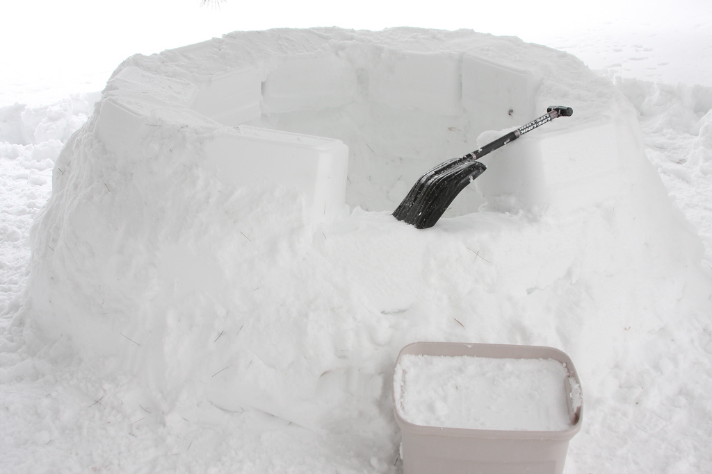

not a SINGLE grain of snow. nope. none. compared to last year? when i had 25 foot MOUNDS i could hollow out and stand up in? oh myyyy.

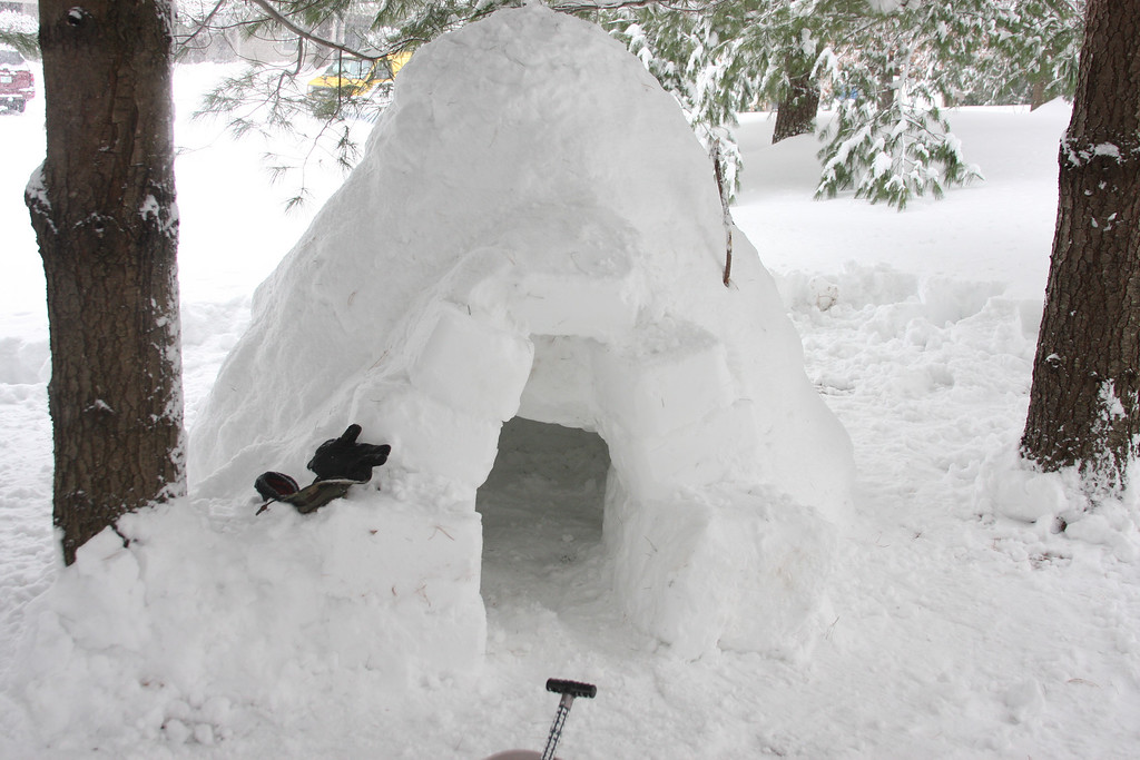

a true igloo is ... tricky. forget making it with a bucket or pail. it's a LOT of work.
a speed quincy is easier.
or you could use a special tool :)
built well, they don't even actually collapse... they slump. slowly, then hollow out like shells.

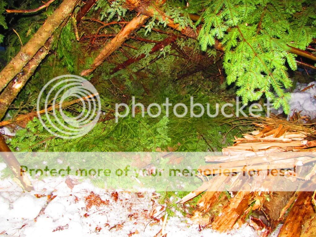

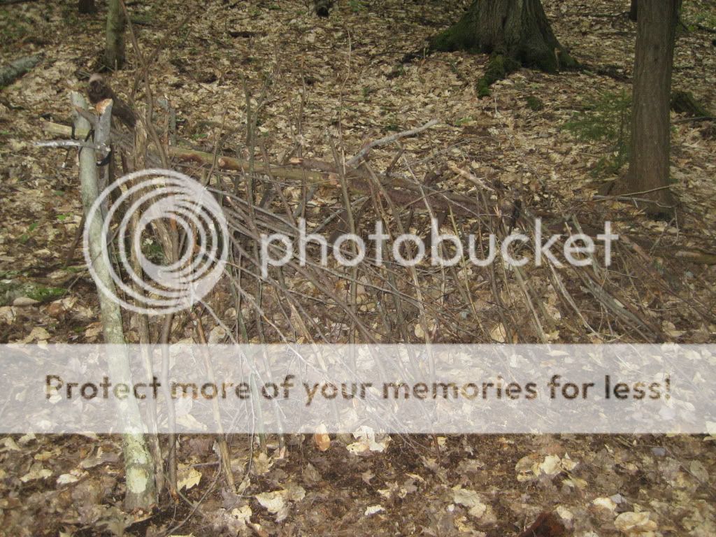

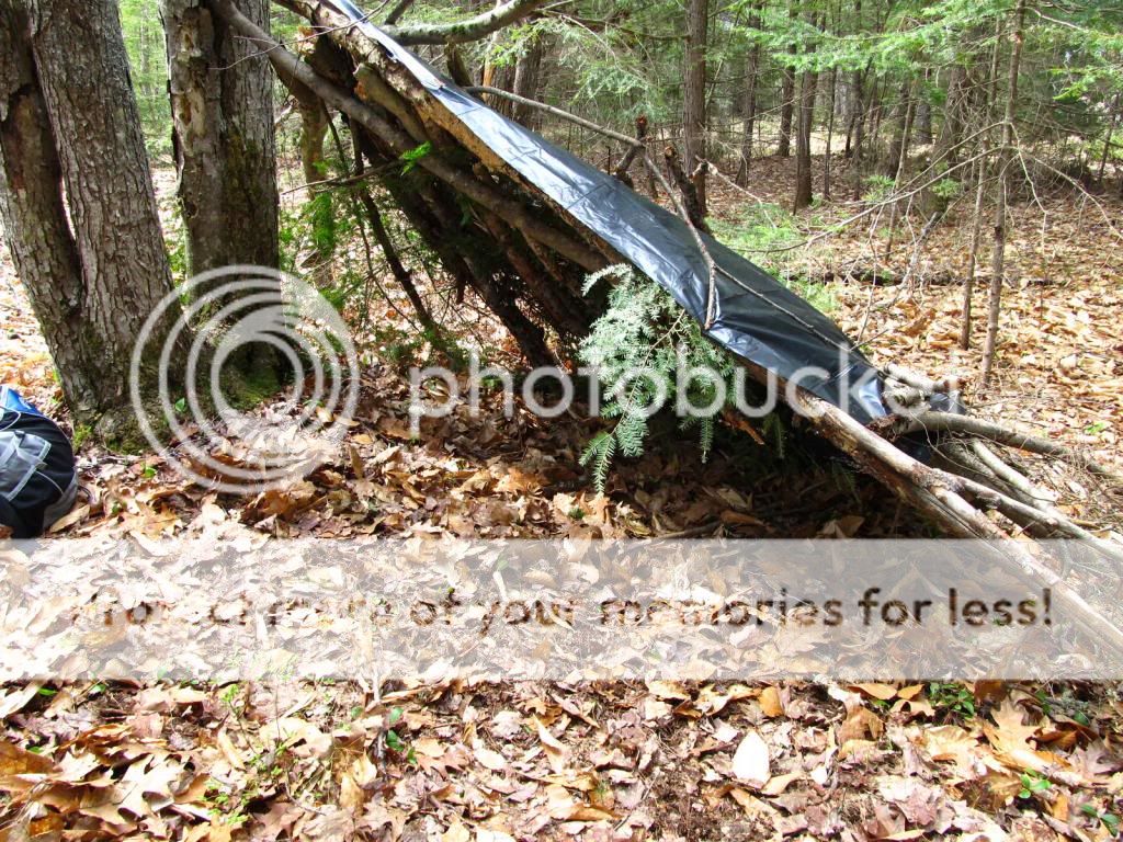

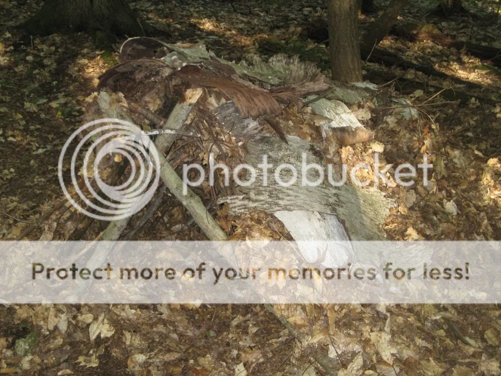

Debris shelter. These are easy to make and are warmer and more waterproof than they look.

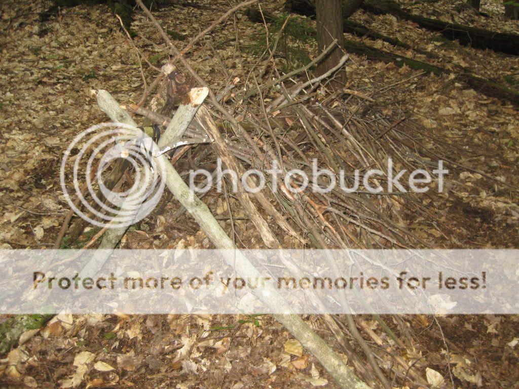

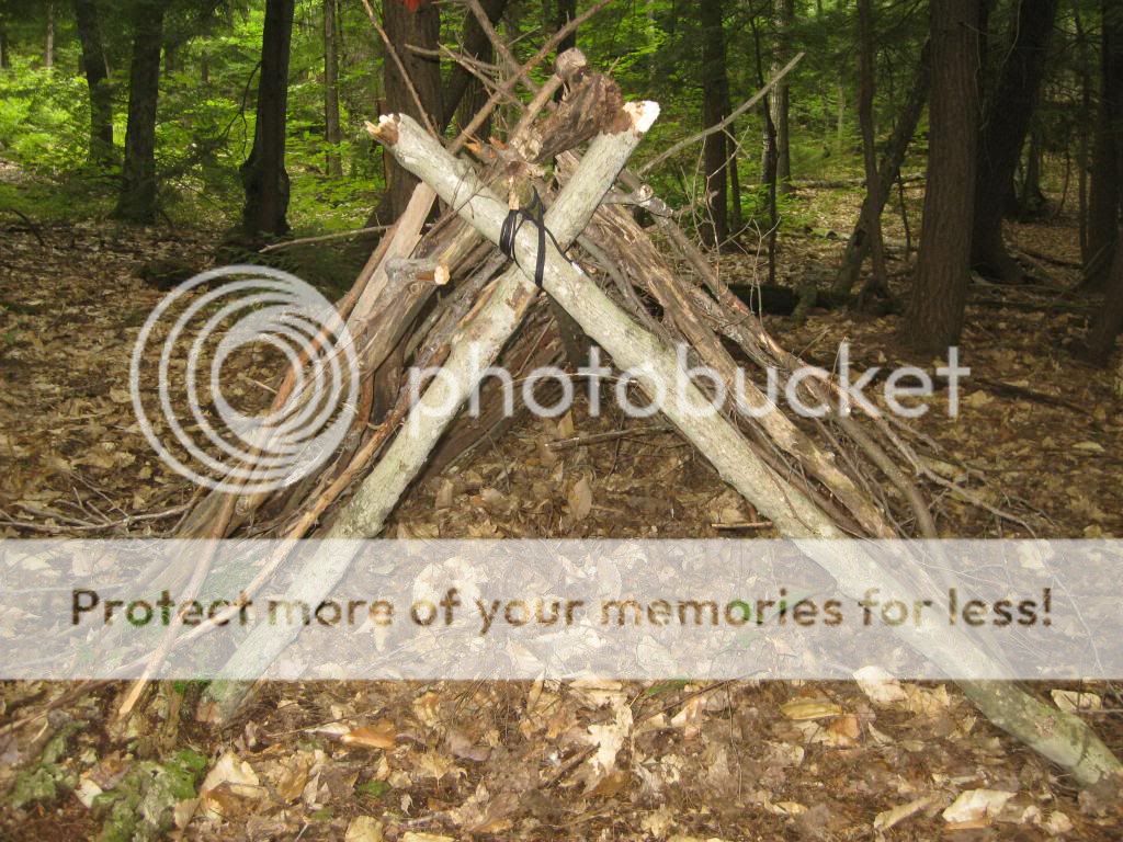

Start by making a tripod.
Add branches to form ribs. The more branches you add the better it will support the leaves and other debris you add on later.

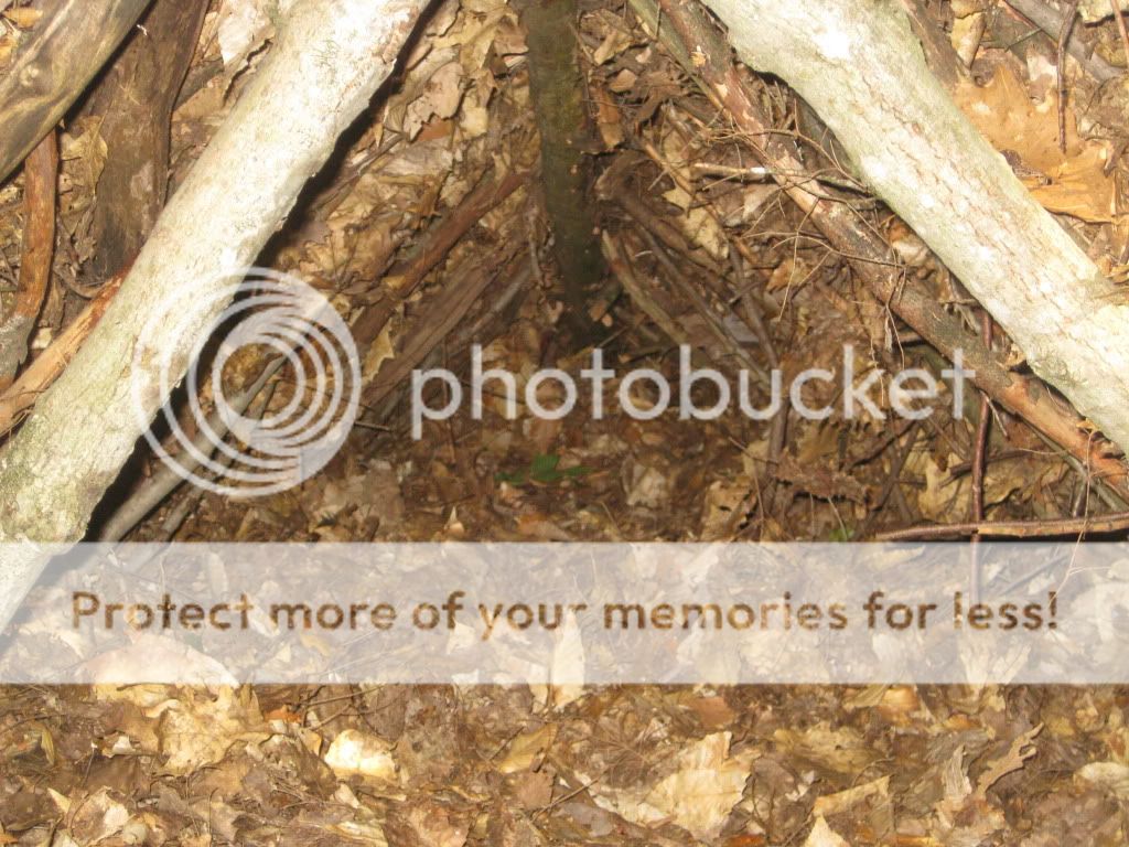

Before you start throwing the debris on top get inside and make sure you have enough room and that your whole body fits in the shelter. Remember the less space you have the easier it is to keep warm. After you get the size squared away line the floor with leaves, ALOT of leaves. They will compress more than you think.. Somewhere around 6 inches compressed is a good rule of thumb. Add more in colder conditions.
Now you can start throwing on leaves, bark, moss, anything you can to help trap heat and shed precipitation. Add as much debris as you can.
Check for any light shining through into your shelter. Add more debris if needed.

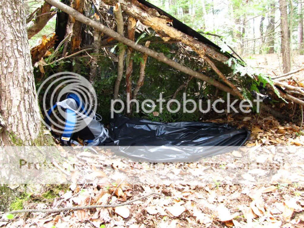

You can also bring some simple items to help you make a debris type shelter even better. In this instance I used two 55 gallon drum liners and one space blanket. One drum liner split open to help waterproof the shelter with the space blanket underneath to reflect radiation from a fire. The second drum liner was filled with leaves to create a sleeping pad insulating me from the ground.
Getting ready to fill the other drum liner and fit testing.
Time for bed.

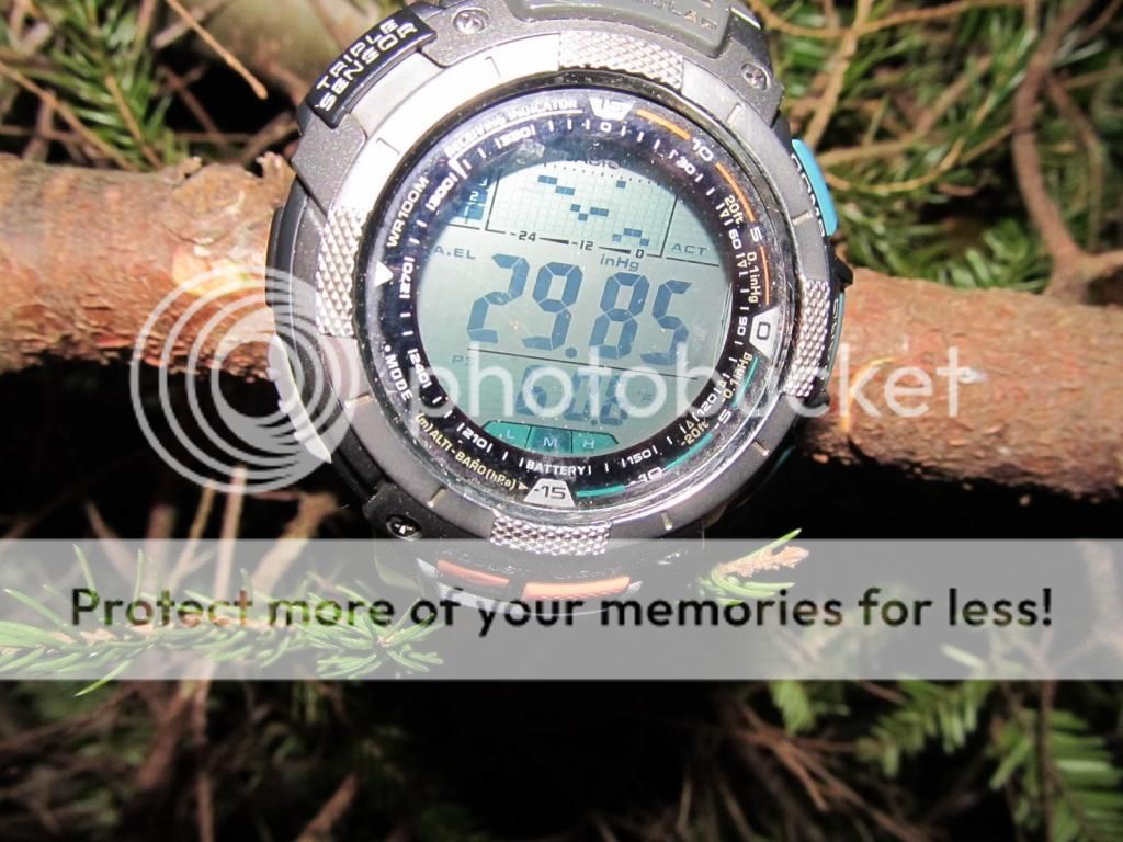

I hung my watch inside the shelter to measure the temperature inside. 60.6 inside the shelter and below freezing outside.

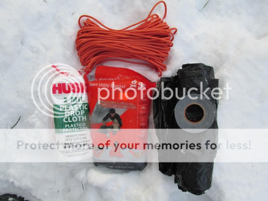

Component list: 2ml plastic drop cloth 9' x12'. Reusable space blanket. 550 cord, 55 gallon drum liner and duct tape.

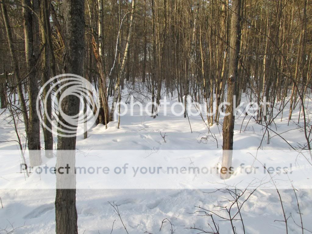

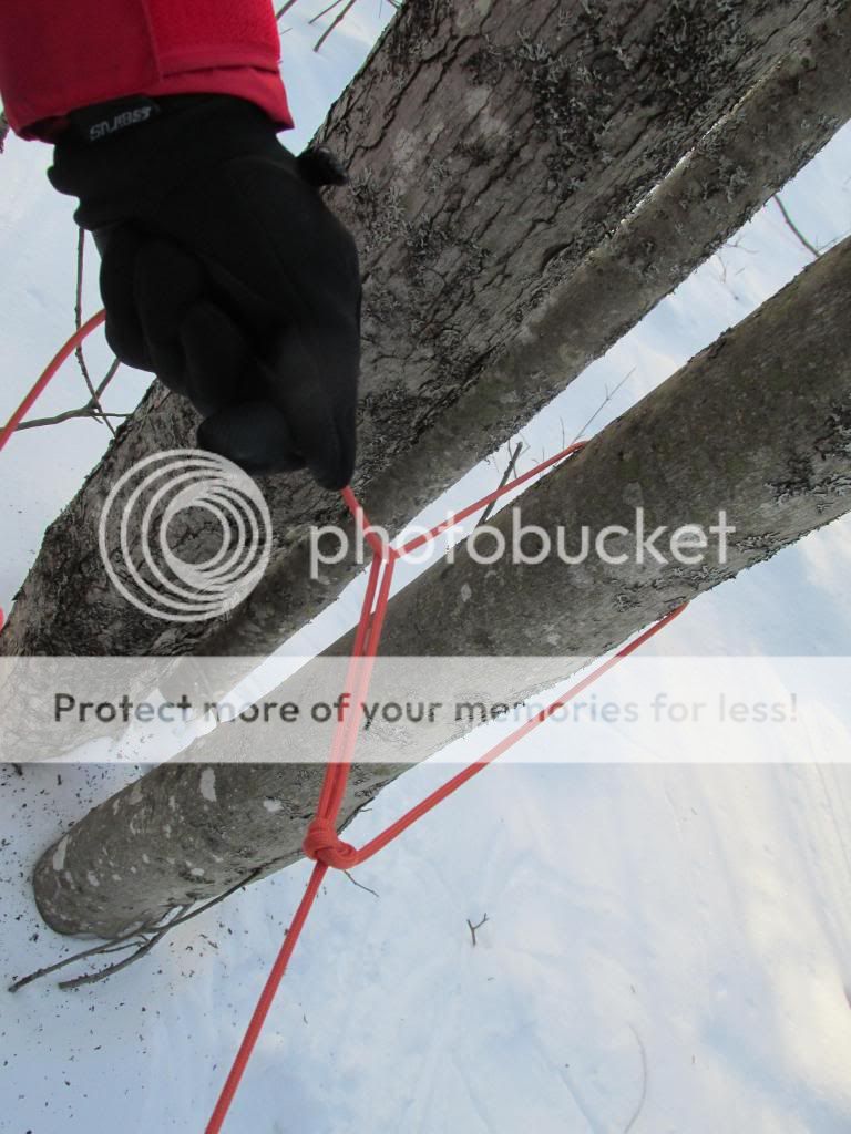

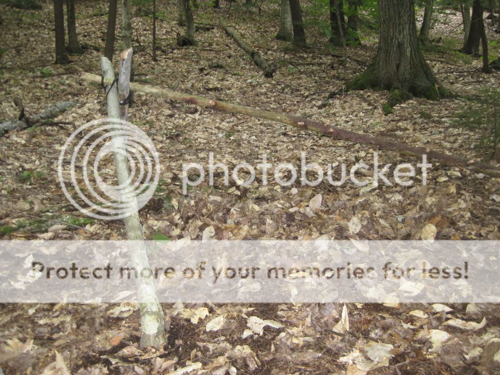

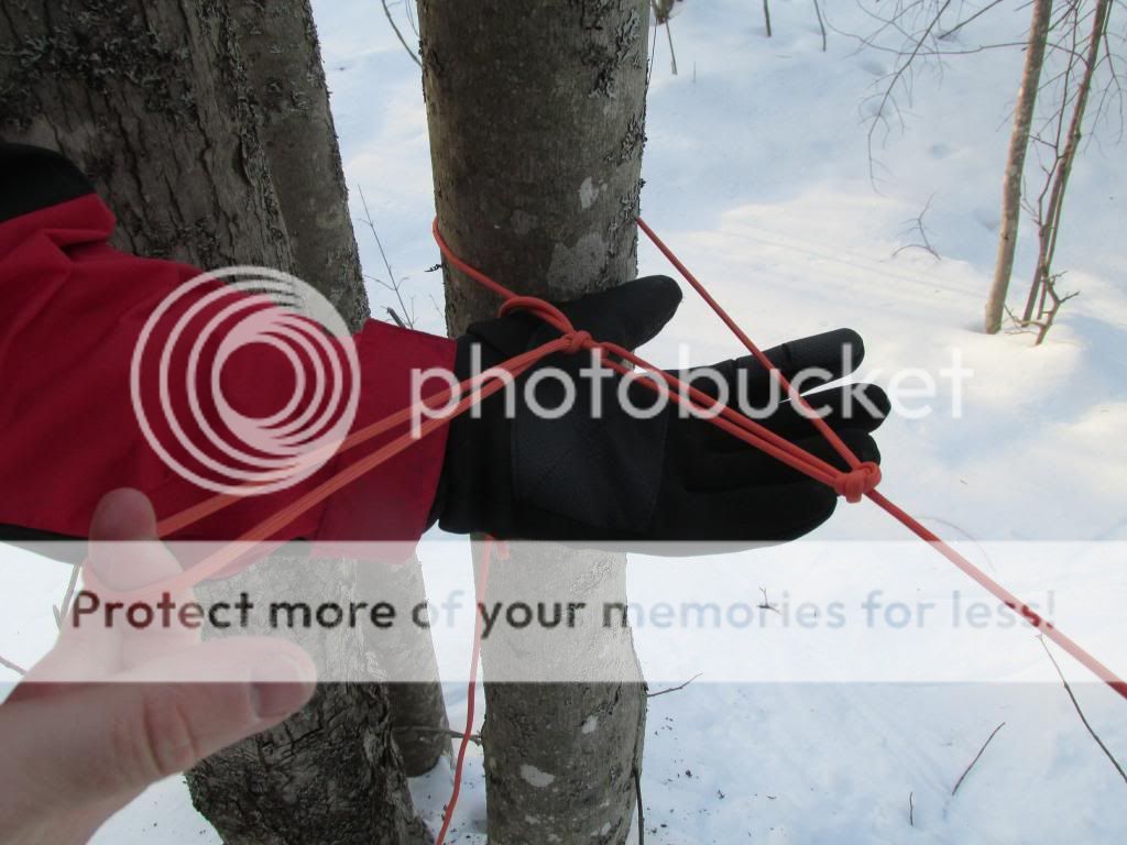

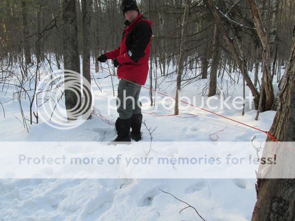

Find two trees about 10-12 feet apart.
Make a loop in your 550 cord and loop one end around one tree about waist high.
Loop the 550 cord around the other tree and test the hight.

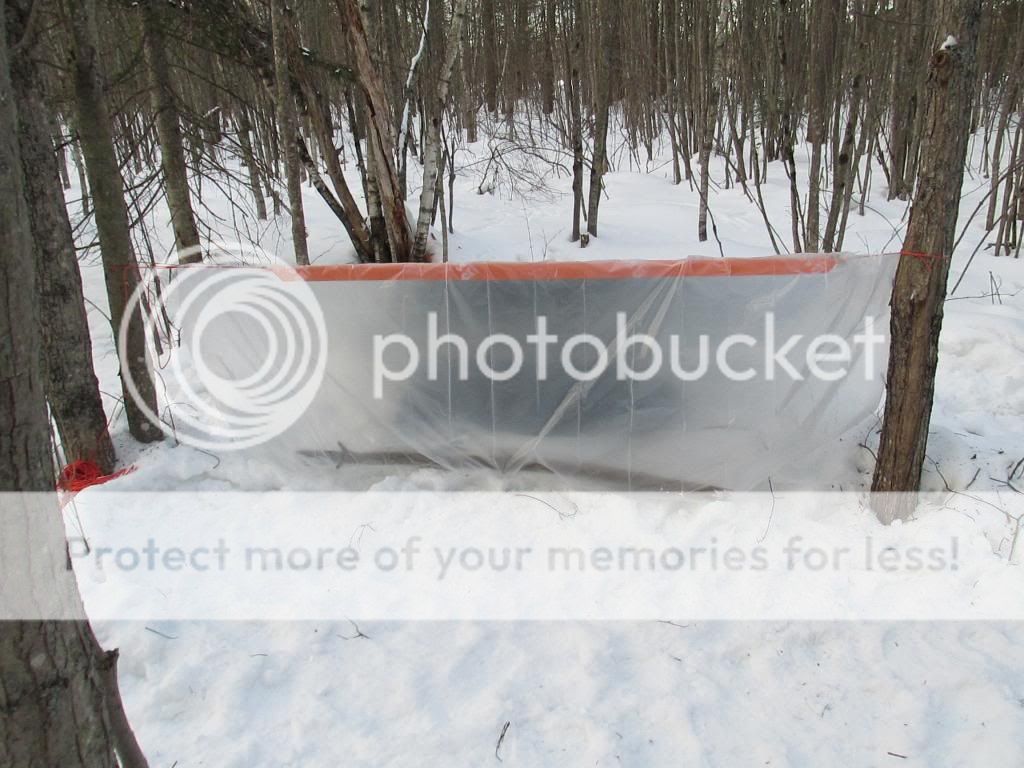

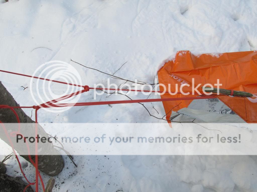

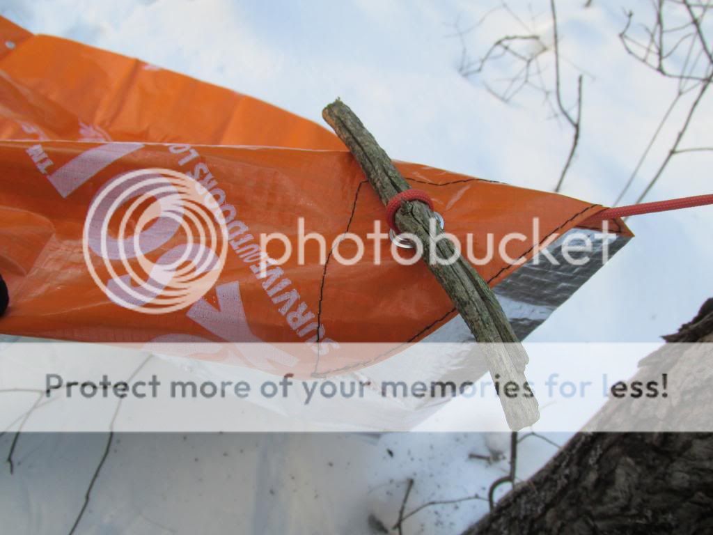

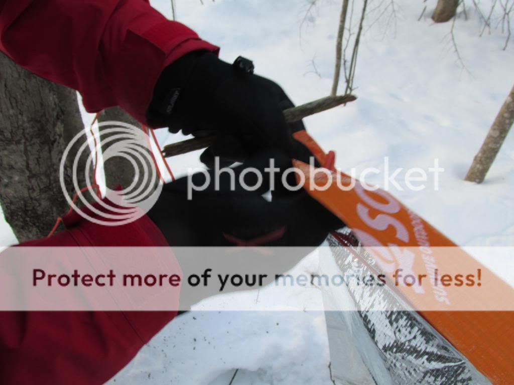

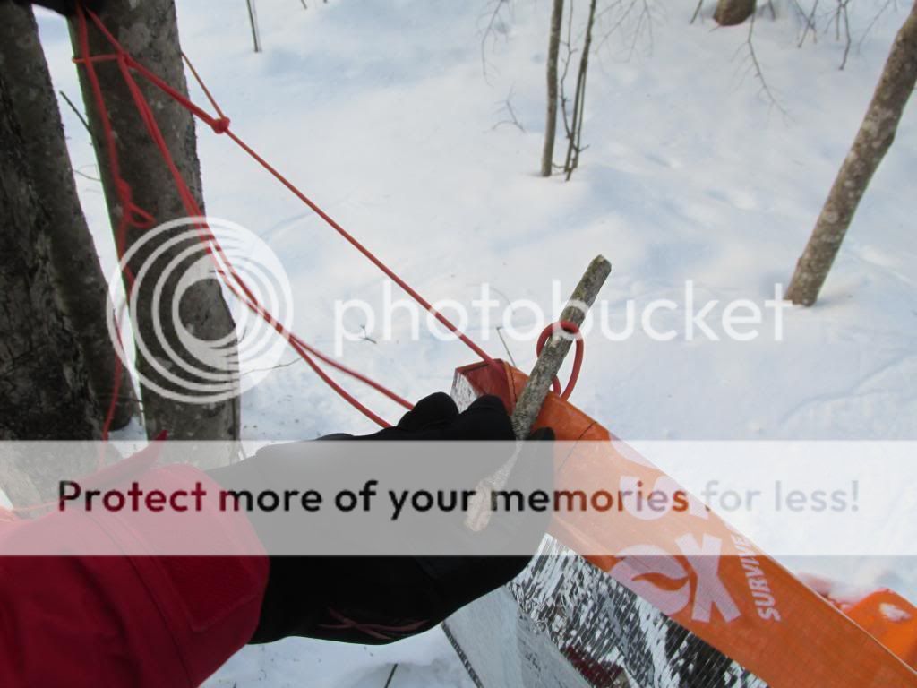

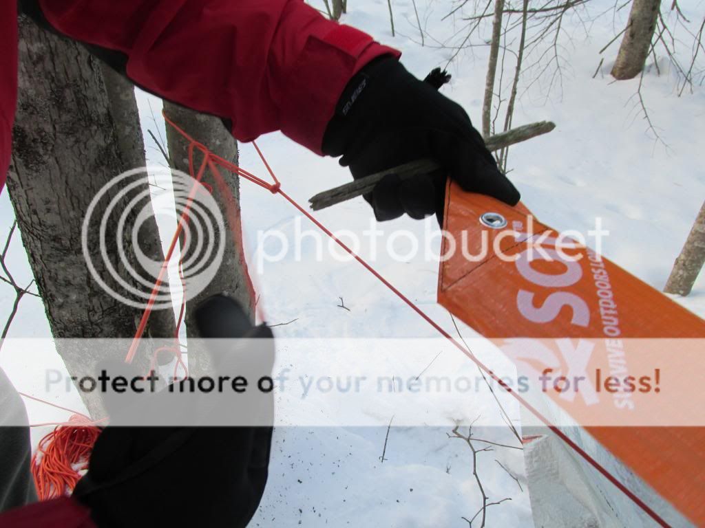

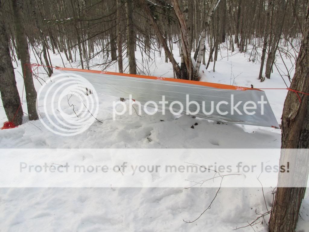

Loosen the ridgeline and put it through a corner grommet. Then insert a stick to hold the space blanket in place.

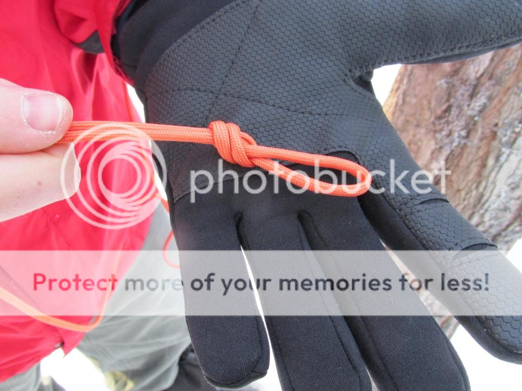

Make a loop in the line before the tree and feed the 550 cord through that so you have a way of tensioning the ridge line.
Tie an overhand knot by the loop to hold it in place. Now you have an adjustable loop.
Run that lop through the other corner grommet and insert another stick.
Now tighten the loop by pulling on the tag end. This makes the space blanket taught.

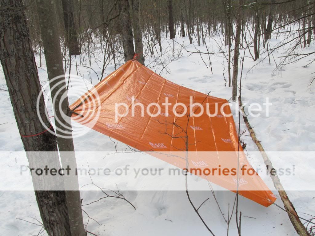

Tie off or steak down the back two corners.

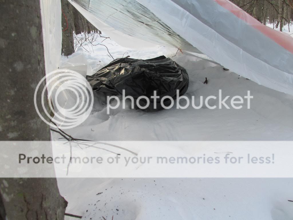

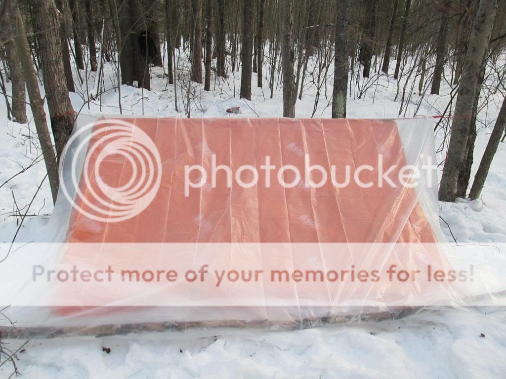

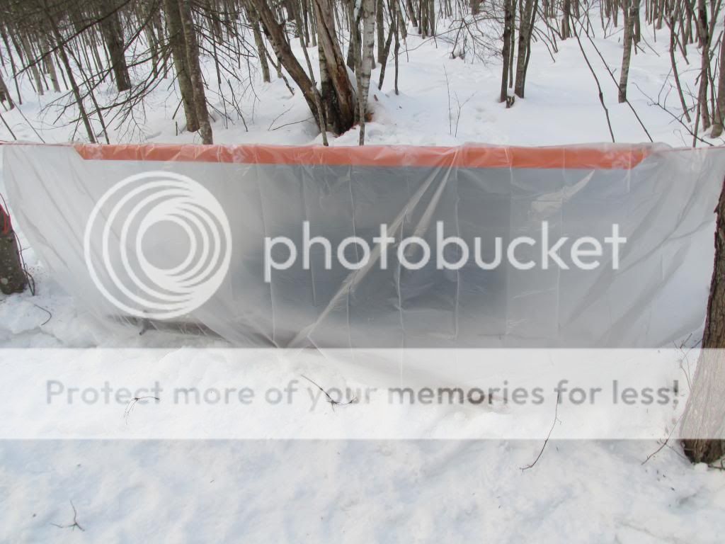

Drape the clear plastic over the space blanket. Steak down or tie off the back section and roll up the front around a log to keep it tight and make it easier to get in and out.
For the sake of this demonstration I did not want to cut a lot of bows to line the ground since I was not going to sleep in it. If I was I would have make a nice thick bow bed and layed the 55 gallon drum liner on top to further reduce conduction.
Use the tape to help seal off the sides. Do not seal them up too much because you don't want to fill the shelter up with carbon dioxide from breathing and make your situation worse.
Make a long fire in front of the shelter and keep it going all night to keep this shelter nice and warm.
