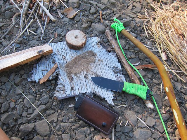

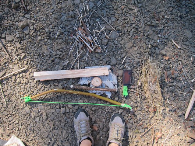

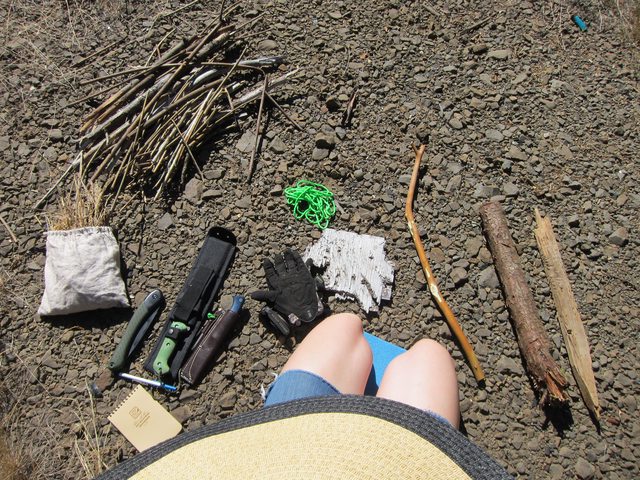

I haven't posted a thread in a real long while, but I wanted to share with you guys Cameron and I's adventures from today. Today we hiked around the woods and tried to make friction fires. We got pretty close! I tried making a bow drill, and he tried the fire plough.

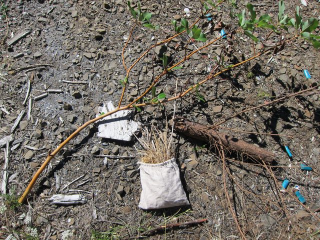

First step: Gather stuff.
My supplies. Pretty happy with the madrone branch for the bow.

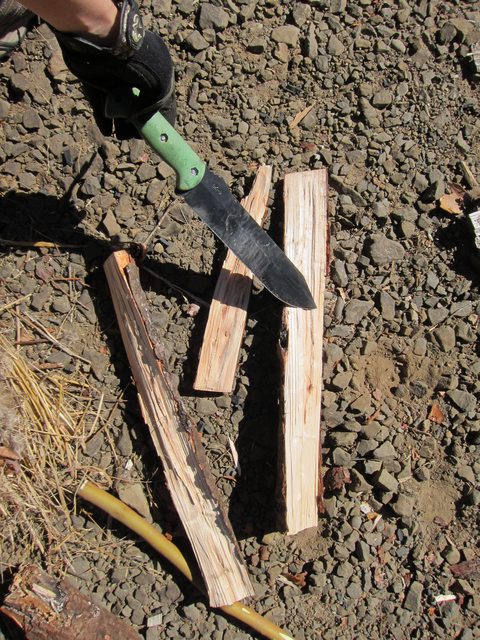

Cameron batoning with his 14 like a boss. (he only wanted to use 1 knife so the 14 was it!)
The 9 makes quick work of anything in it's path

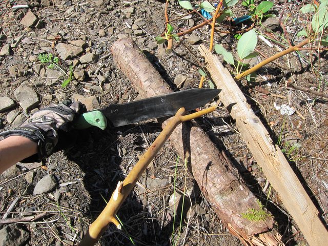

Starting to look like i'm doing something
Cameron's "Survivorman" photo
aaaah batoning
Ok now what?
Lots of dust, lots of smoke, no ember :(
again, lots of smoke, lots of dust, no ember. I think the board I made was wrong - too hard or something.

Any suggestions from bow drill veterans? We were running out of time for me to try and find a different type of wood to try for the bottom board thingy. I'm going to do some research and try it again eventually, I brought my hard earned bow drill kit home so I can improve up on it.

Just one quick thing before heading off to bed, try using more of the bow, If you refer to the video you posted, you can see that you seem to be using near half, of the bow, if that. Due to that you have to stop the drill from turning at the end of the stroke near the bow AND in the center of the string. If you had used the full length of the bow, you should be able to gain at least 4"-6" worth of usable push/pull on the drill. With that thin of a drill, that ends up being quite a few rotations while maximizing retained heat.
Also, I just noticed that the divot that you set the drill in is rather shallow, see if you can add some depth to that and get the drill to match the hole as close as possible, that is normally done witha knife then the drill in use.
Make your notch like and old fashion key hole, wider on the edge of the board, narrow towards the base of the drill and a small hole for the ember to drop/build in the very center.
