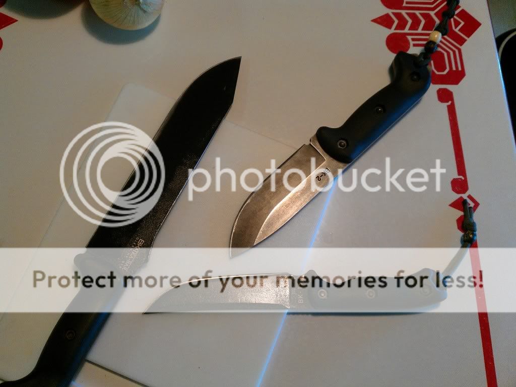

So the title says it all! I really like to use my Becker blades in the kitchen! The 14/11 makes a great pairing knife, the 2 as a short chopper, the 15 as a slicer, and the 9 actually makes a great large chefs knife. I snapped some pics the other day of some standard kitchen slicing. Using the BK9, BK2, and BK15. I use these blades everywhere so yes they were cleaned and olive oiled before the cutting began.
These pics are not really comprehensive nor did I photograph a control knife like an actually chefs blade, but I hope this gives you a good idea.

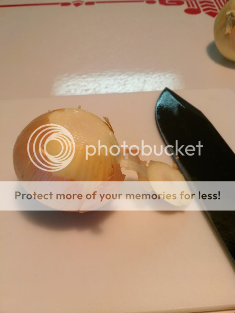

The BK9 is soon to become one of my favorite blades in the kitchen. This is mainly due to the "thin" geometry that the Saber/flat grind brings that 3/16ths stock to. Chopping up onions was a breeze. The main complaint I could see with any of these blades is distance from the edge to the cutting board in relation to the choil/ricasso and your hand. With a normal chefs knife there is plenty of clearance between the edge and the handle/your knuckles. Tried to grab a picture of this but it just looked like junk. So if your interested... grab a chefs knife put it edge down in a hammer grip on your cutting board, now do the same with the BK9 and you will see the air between the edge. Anyways back to the onion murder... BK9 topped off the onion no problem. You could also get paper thin slices with the BK9.

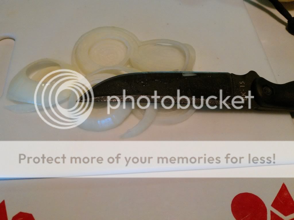

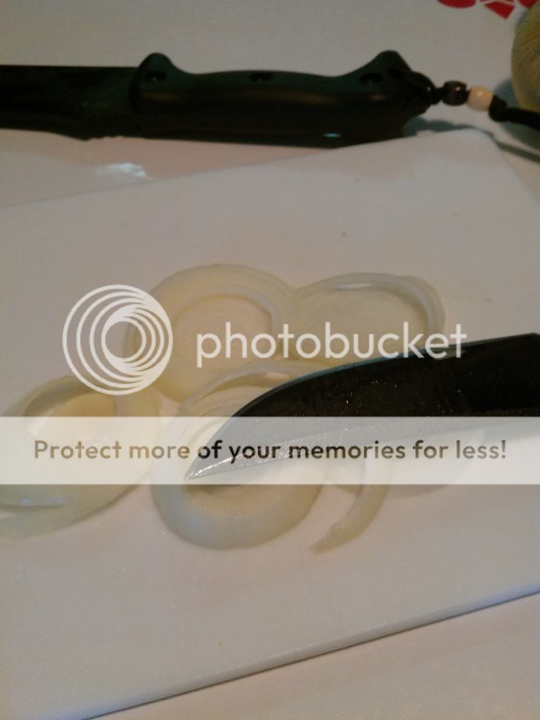

Next was the 15, The only issue is the distance between the shoulder and grind. With the BK9 you have a lot of distance and clearance between the cutting medium and the grind. With the 15 you do not, initially the cut was beautiful but then took slightly more pressure on the shoulders. This could be remedied by Fisking the blade, but really its not a big deal at all, just something to mention. Realistically though the 15 did great.

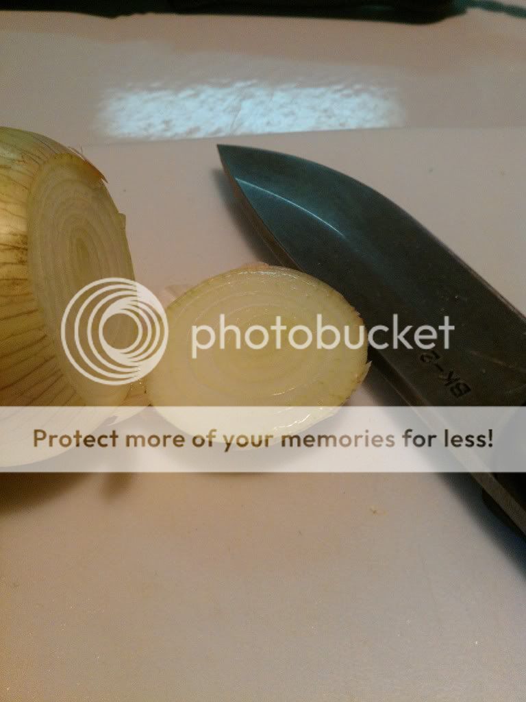

Time for the fat boy. I have actually used the 2 a lot in the kitchen. Some folks are going to tell you "ITS SUCKS ITS LIKE CUTTING STUFF WITH A BRICK..." not true... all misinformation. The issue again is distance between the edge and shoulder. I have softened the shoulders slightly on my 2, and it has a low convex edge. It cuts really well... The only "binding" you are going to have is in harder foods like sweet potatoes and carrots. But carrots can be easily popped with a wrist flick. More onion genocide. Did not get more photos of the 2 because to me... it passed this test long ago.
