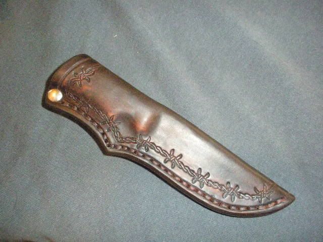

These are pics of the my first knife sheath I ever made ( for an Esee3) , a week ago:

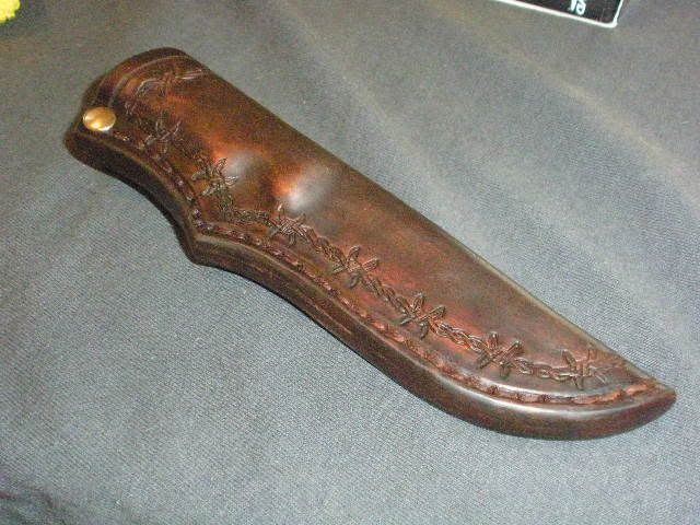

Here is the sheath before I fixed it:
Sure it looks good in the pic, but I just didn't like the finish.

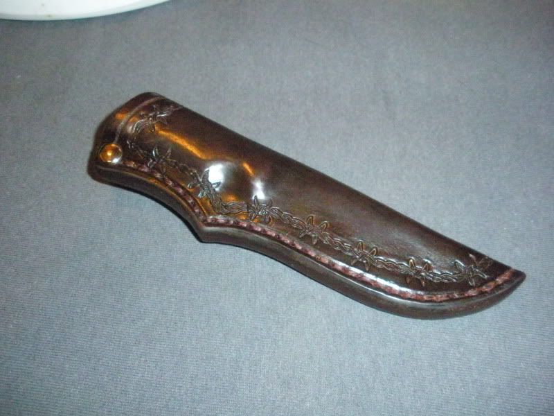

Here is the updated 'antiqued' finish.
