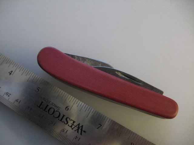

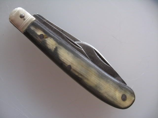

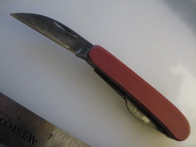

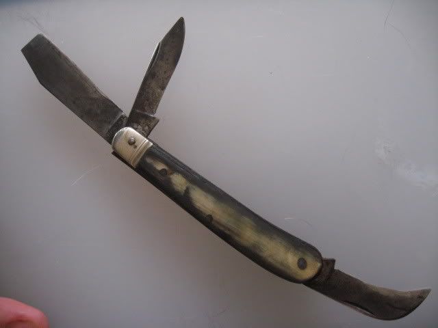

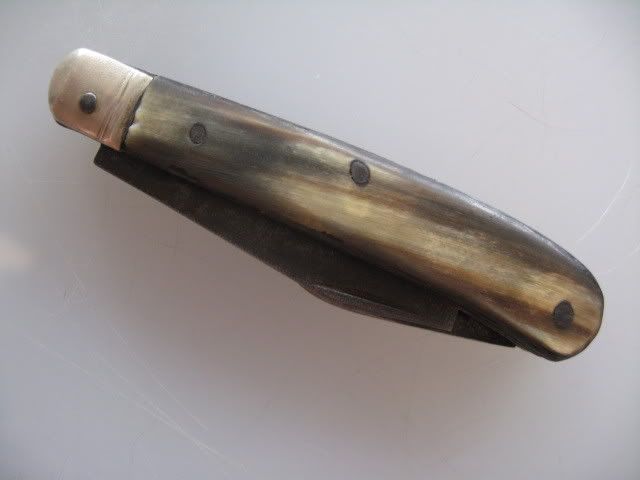

This is a Kuhn knife I picked up for $5 at a local Antique show (guy wouldn't budge to $4). Never heard of Kuhn before and don't know anything about it. Liked the hook blade, wanted a Wharncliffe blade with constant curve to it as a main blade. First time modifying a slipjoint, first time working with Micarta (left it unpolished on purpose for more grip), first time making a nail nick- slipped with the Dremmel (damn legs). Hidden pins, white liner, red micarta (Canadian colours). Only thing I did wrong was not clamp down the master pin enough so there is a bit of wobble to the blade but still walks and talks well. Now just have to work a bit more on the hawksbill blade.
What do you guys like/ dislike about it??
