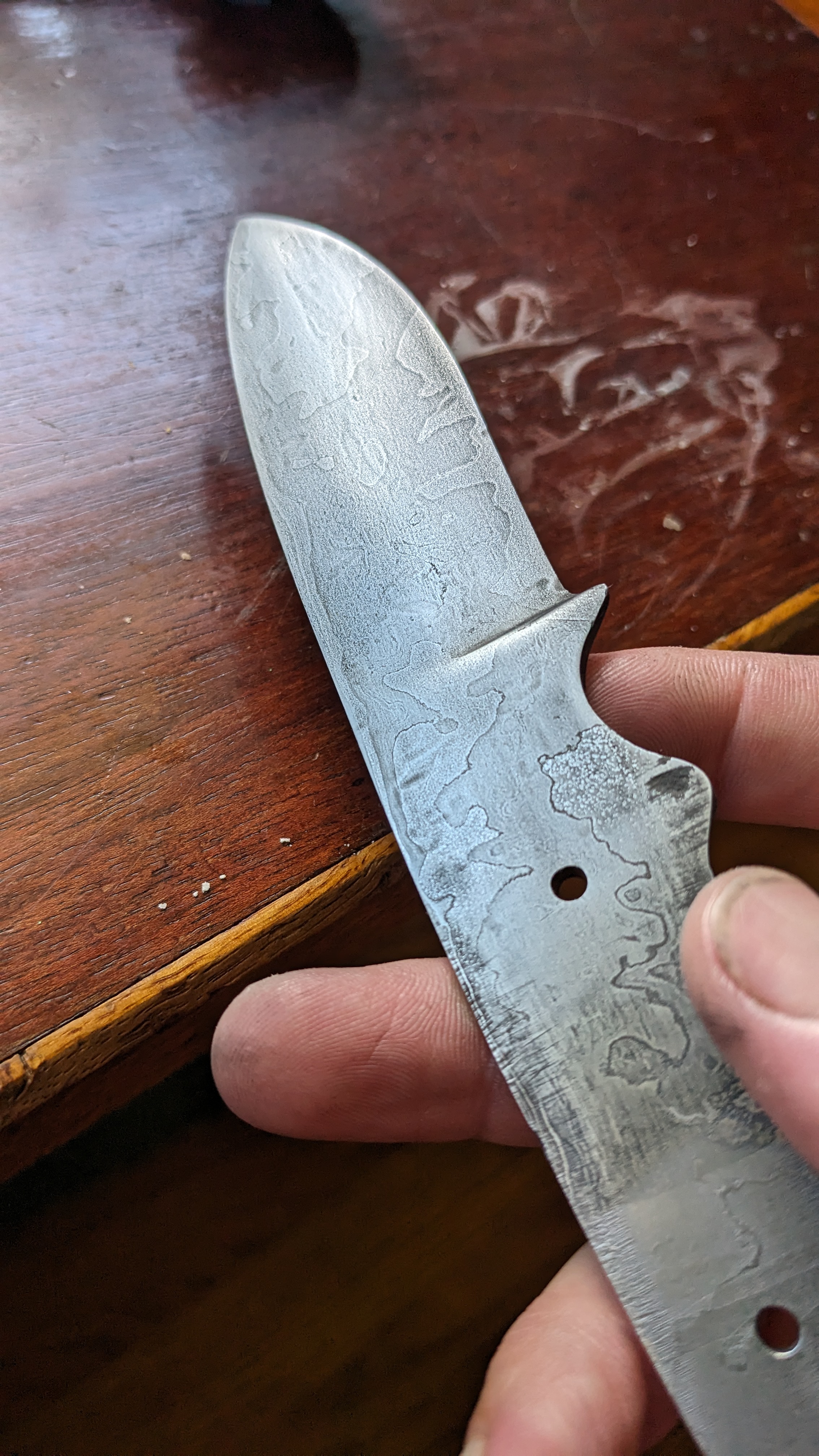

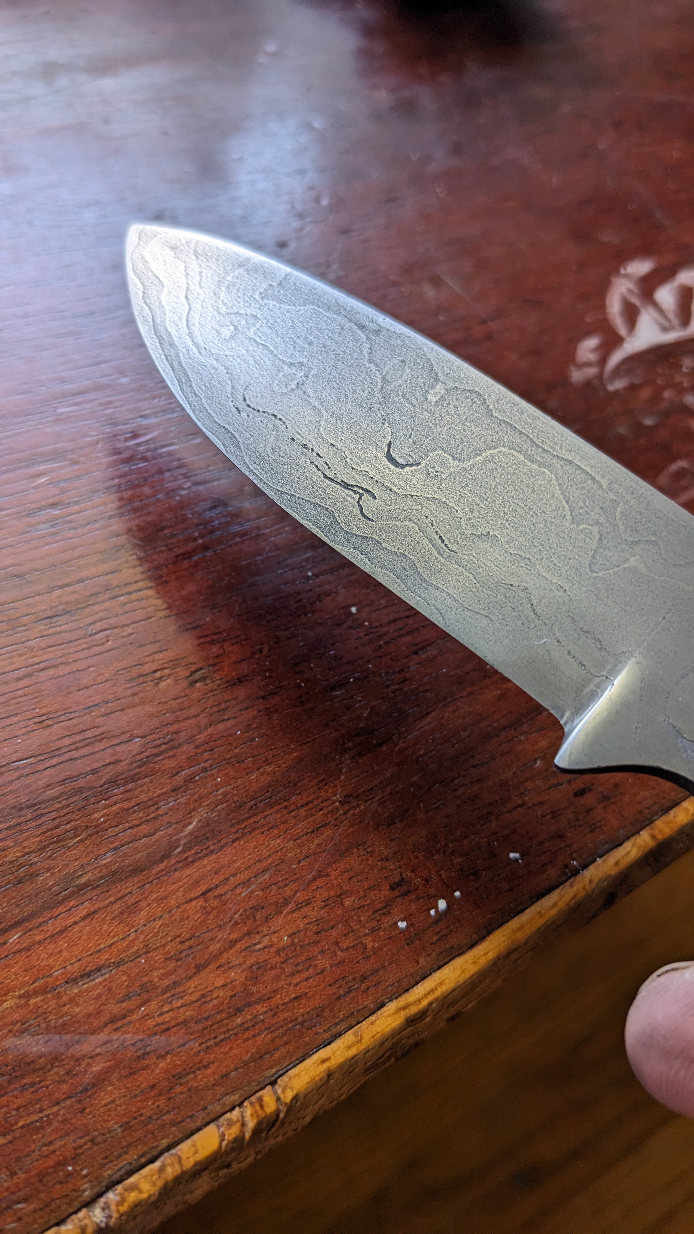

I've recently started making knives as a hobby and my latest attempt was a Damascus steel blade out of 1084 and 15N20 . I realize that I failed to get solid welds in a few spots, but my real question is why can't I get any real contrast in my steel layers? I initially tried etching after hand sanding to 400 grit. That attempt came with little to no contrast and lots of visible sanding marks. I resanded up to 1000 grit and then etched again. The finish looks a lot better, but it seems like both steels are etching equally. When I pull the blade out of the ferric chloride, it is all dark, with no difference between the steels. I've tried coffee etching as well, with the same result. Is this a problem with my process? I've also had the thought that the steel bars I order off of Amazon to make my billet aren't actually the alloys that were advertised and there isn't enough difference in the nickel content of two. Thanks in advance for any help or advice!

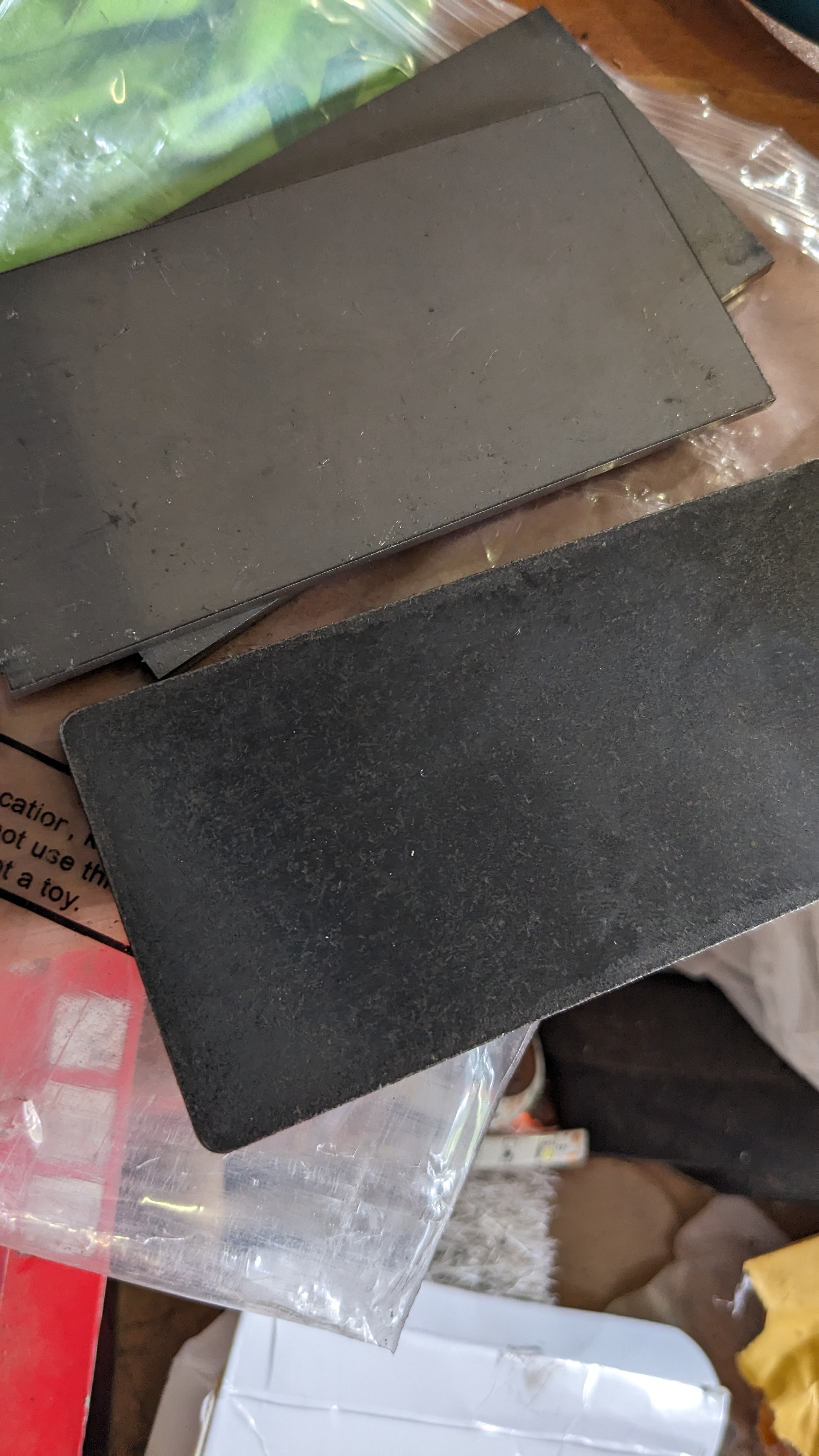

Order your steel from a well know supplier - Alpha Knife Supply is a good source with reasonable prices. I'd never really consider steels ordered from Amazon. I've read on a 15N20 steel where comments said no way could it be 15N20 since they had the same experience with both alloys being the same after etching. That person said he had lots of experience with etching Damascus and should have known better than order from fleabay or Amazon for steel. You might get good steel depending on supplier, but you never know.
Looking at some of the reviews on Amazon, one 10 pak has a 4.8 star rating with 33 folks giving reviews. Looks like lots of them received free steel for their reviews.

There was a batch not too long ago from amazon or ebay that was not the steel it was supposed to be. I can't remember the online seller, but there was a thread on this forum IIRC about it. Is your acid diluted fully and decarb ground off the blade after heat treating?
Found the thread: https://www.bladeforums.com/threads/san-mai-etching-question.1916086/#post-21776683

Taz, thanks for that link. The pictures of the San mai look exactly like mine after etching -all one color. I went back to look at my Amazon order, and it's a different seller than the one mentioned in the thread you sent, but since I ordered, a review had been posted complaining of the same issue I'm dealing with due to a lack of nickel content. Pretty annoying to have put in the effort of hand hammering a Damascus billet and not get the patterning to show. Even with the flaws in my forge welds I was proud of myself as a first attempt and would have liked the Damascus to show. Lesson learned on using reliable suppliers.

The trick to etching two steels that are closer in contrast is to take it to a higher finish going into the etch and using a more diluted etchant for a longer period of time. It should look more like cream soda than root beer.
But I think your problem is more likely to be elevated temperatures when forging and again when austenitizing. Care must be taken to normalize, anneal, harden and temper at the correct temperatures.

The color of the bars from the supplier mean nothing as to what they will etch like. It is a combination of a surface treatment to prevent rust and the oxides from rolling the bars out.
The steel looks like it etched just fine. The issue you are having is that there is no contrast. Contrast is a dicey thing in carbon steel. It is rare that you get black and silver contrast. The sanding can remove the darker color almost immediately.

That grainy surface is not a 1000 grit finish. Hopefully it wasn't over worked and overheated.
Take it down to a perfect 400 grit and then re-etch.
After a good etch for 10 minutes, with repeated rinse off and back into the tank every two minutes, take the blade out, rinse only in running water - but don't wipe it off. Place in a pot of water with a teaspoon of TSP or baking soda and boil for 15-30 minutes. Rinse well and dry off. After that you can wipe the blade down with oil.
Next, wrap some 800 -1000 grit paper around a hard wooden block or piece of aluminum and sand the high spots back to shiny. Try not to touch the low spots.

That grainy surface is not 1000 grit finish.
Honestly, I think the graininess is from over etching. I tried at the low dilution for several cycles, and then again at higher concentrations of ferric chloride. That's when the graininess started showing up.

I went back through my grits and re-etched per Stacy's instructions. Again ended up with no differentiation between the layers. I'm going to go with bad steel as my cause. I've ordered some 1084 and 15N20 from Alpha Knife Supply and will try again. I'll report back on how things go with steel from a more reliable source.

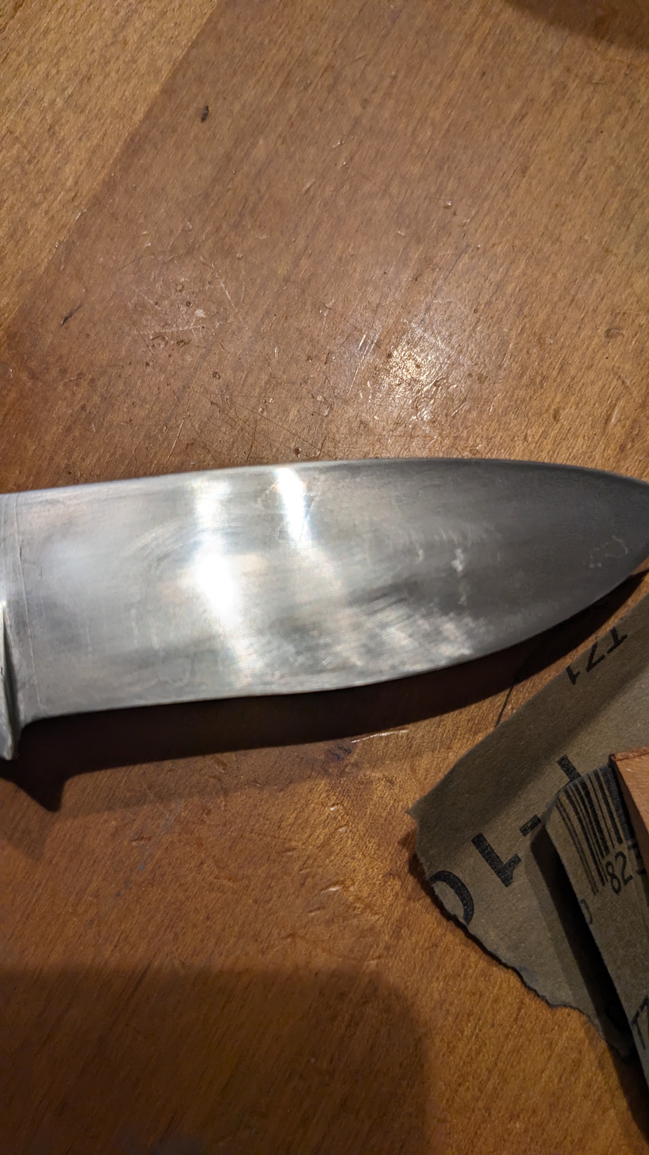

This picture is after resanding, etching for ten minutes with rinses every two minutes, and carefully sanding with 1000 grit on a block. At no point did the different layers remotely differentiate themselves.
That blade is awful shiny. You might be over sanding.
Try etching , Tsp rinse or spraying with windex with ammonia, cold water rinse then a very very light rub with 4 ought steel wool.
