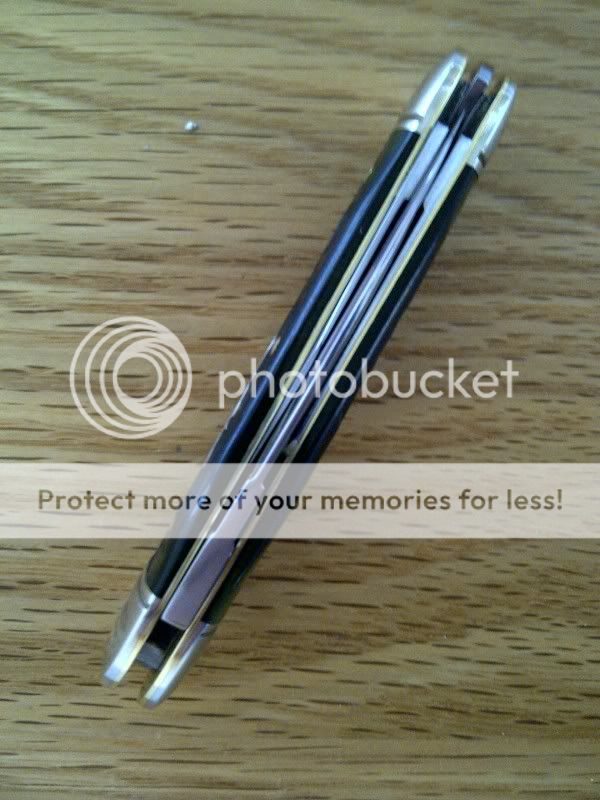

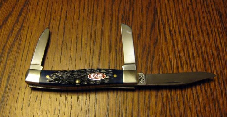

It seems that I can't avoid getting blade rub marks on my recently purchased multi blade traditionals. It's particularly bad on knives that have 2 blades on one spring. I've attached two pics (sorry for the quality) of a case stockman I've had for about 2 months, and already there's a lot of blade rub marks on it. Is this normal? I don't feel like I see a lot of pictures on here with this type of marking on it. About 15 years ago I had a Camillus stockman which I used for years, and I don't remember seeing any marks like this, but that knife had 3 springs instead of two. Is that the difference?
Well, I have two Case Stockman, til now. Everyon of them has blade rub. At the same places on the blade as yours. So I think, that´s normal. I wouldn´t worry about that. Case does a hand-finishing on their knives (I think).
Kind regards
Andi
More or less usual on Stockman CASE knives, not on their Humpback pattern though. Frequent on Whittlers as well, very likely on most production patterns needing crinking ,looks worse on stainless knives rather than carbon with patina. Don't mind it too much provided it doesn't compromise opening/smoothness.
Hi,
In a production knife it's often hard to get the krink just right on every knife. Krink refers to the bends put in the blades to get them to clear when closed when you have more blades than springs. Like on your Case Stockman. This is why 3 spingers like your old Camillus or Bucks don't have this problem most of the time. Each blade is straight.
There can also be a bit of flex in each blade as you open them that can cause rubbing to.
I mostly don't worry about it very much. It's often just a part of the beast and seldom affects usage.
dalee
Blade rub is fairly common. I think some of it is due to the user pushing the blade against another when opening it. Some of it is a lack of fine tuning and sometimes it's a mistake. I had to send back a stockman that slipped through QC -- it had a sheepfoot that was supposed to be krinked but wasn't. If you post a well shot with the blades closed (see photo below), a problem would be easier to spot.
The knife on the far left has some rub between the spey and sheepfoot blades. This is a problem with fine tuning and not uncommon in my opinion. The other two knives don't rub. I didn't take a photo of the knife that I had to send back.
edit:
Here's the same knife (right) shown next to another knife of the same pattern that was better finely tuned (left).
