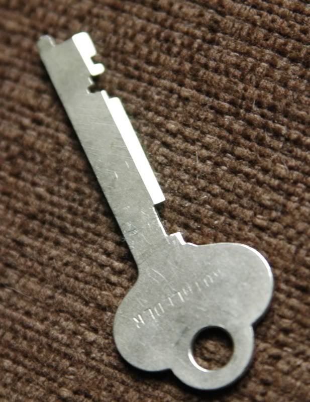

Here's another reason to become proficient at free hand sharpening. My wife started a sewing project that she needed to finish in time for her business trip. Well as things went she still had more sewing to do and wasn't finished a couple of hours before her flight. She had a layover and wanted to do some sewing while she waited. Quick, she asked, what could she take through airport security that would allow her to cut some very strong thread? Knife knut to the rescue, I found this old key and within about 10 minutes on an extra course DMT hone it was sharp and then followed with a few minutes on a fine DMT it was literally shaving hair :D
Not sure about edge retention but she said it worked perfectly for her needs :thumbup:
Great, now you're going to get all of us into finding random objects to sharpen....:D
Impressive work on that key, theonew!:eek:
Back to the original point, learning to sharpen freehand is a valuable skill. Its hard to pack a sharpening kit (generally) if you plan on spending a week hiking. There are occasions where taking the time to pull out a Lansky set (or similar) to resharpen is a hassle, like on the job or in an airport terminal to sharpen a key.;)
