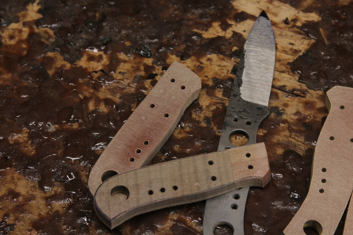

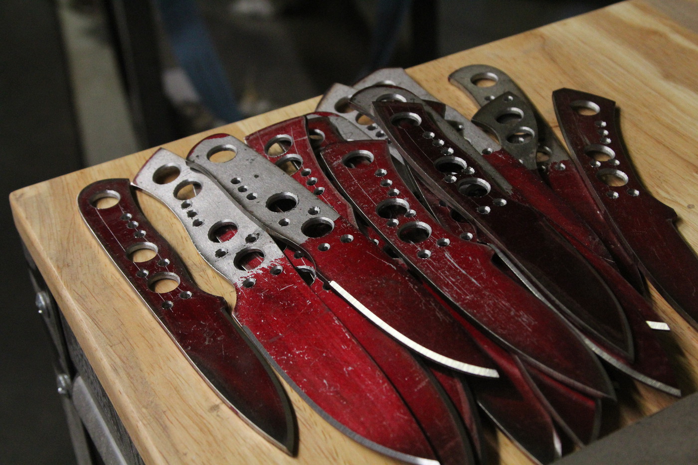

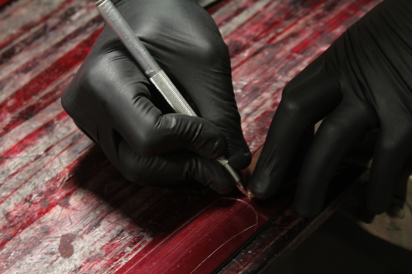

Here, Kyle is scribing the patterns on to the steel. My best guess is that he will start profiling these out Friday morning.

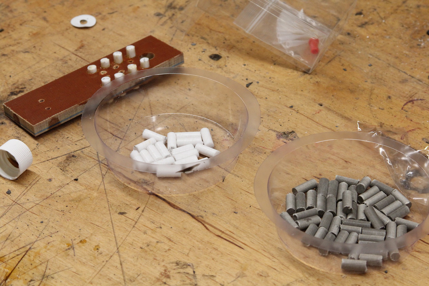

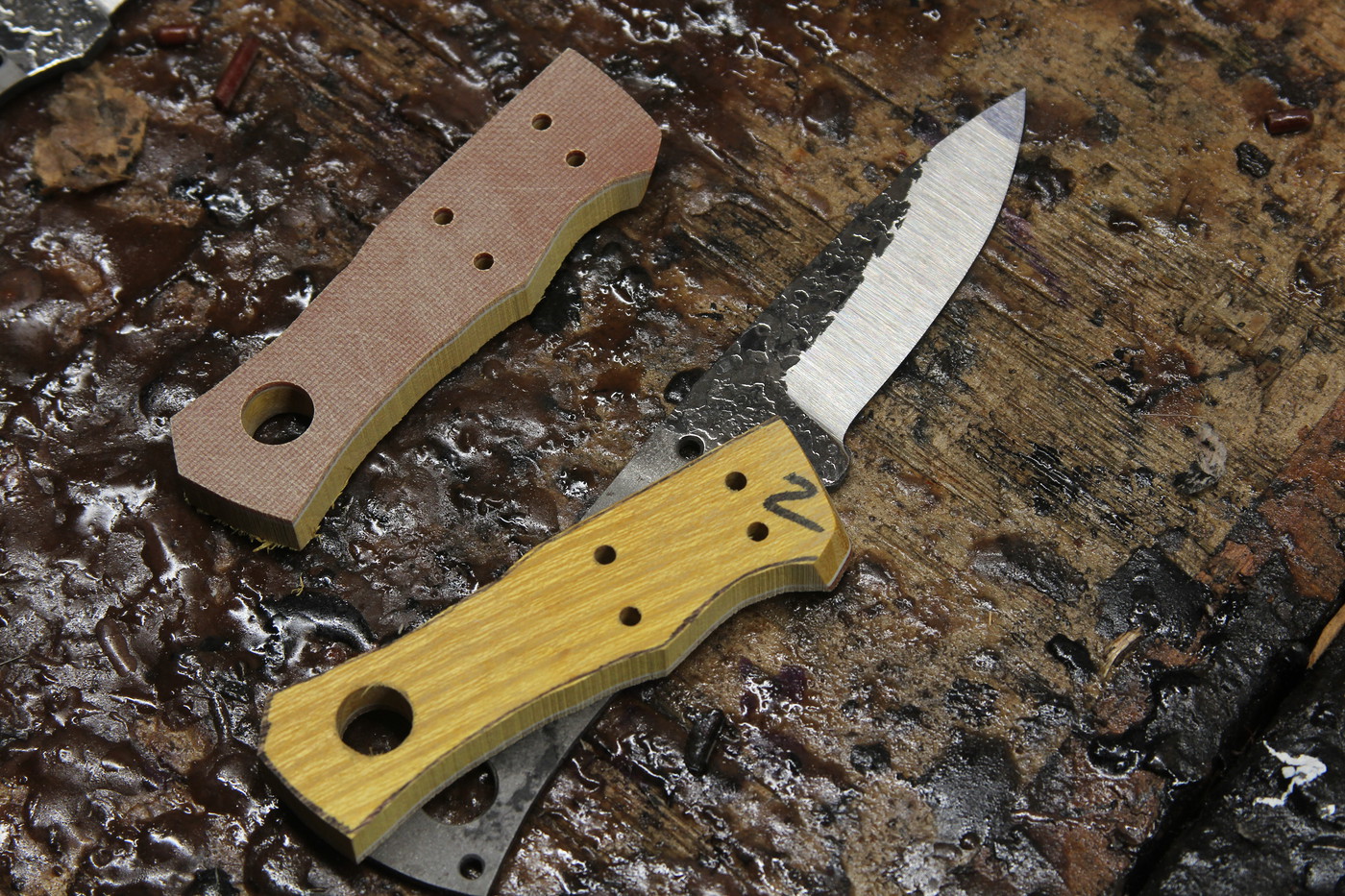

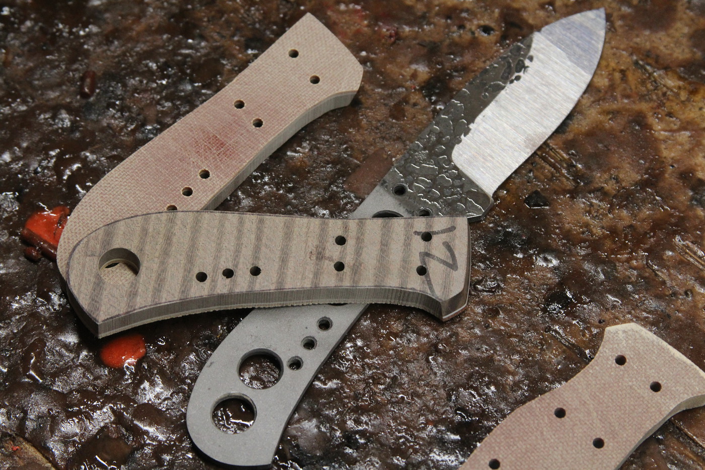

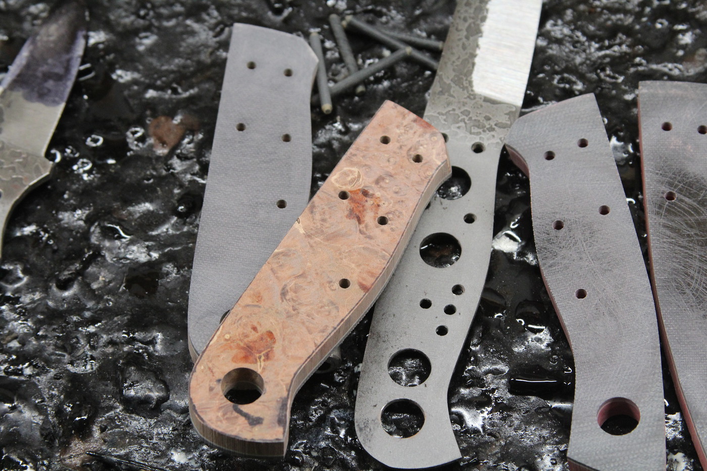

The morning after glue-up Allen cleans up the scales. The next step is Andy shaping them

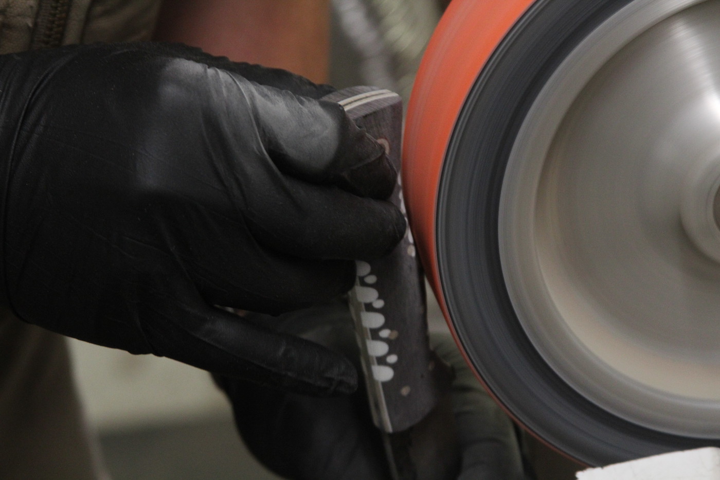

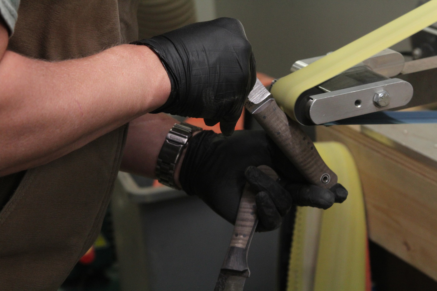

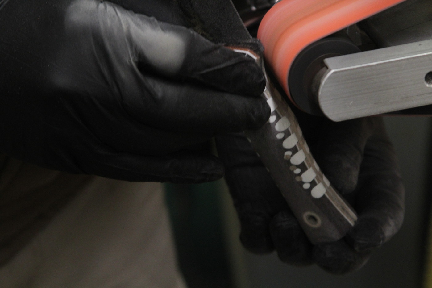

Don’t try this at home!

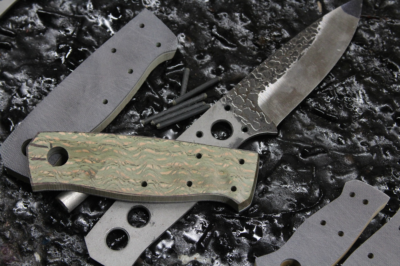

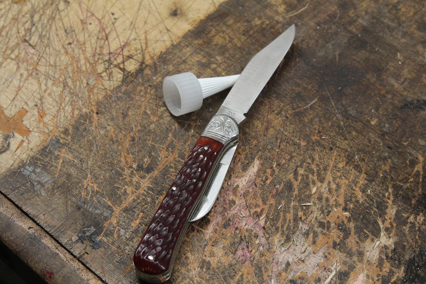

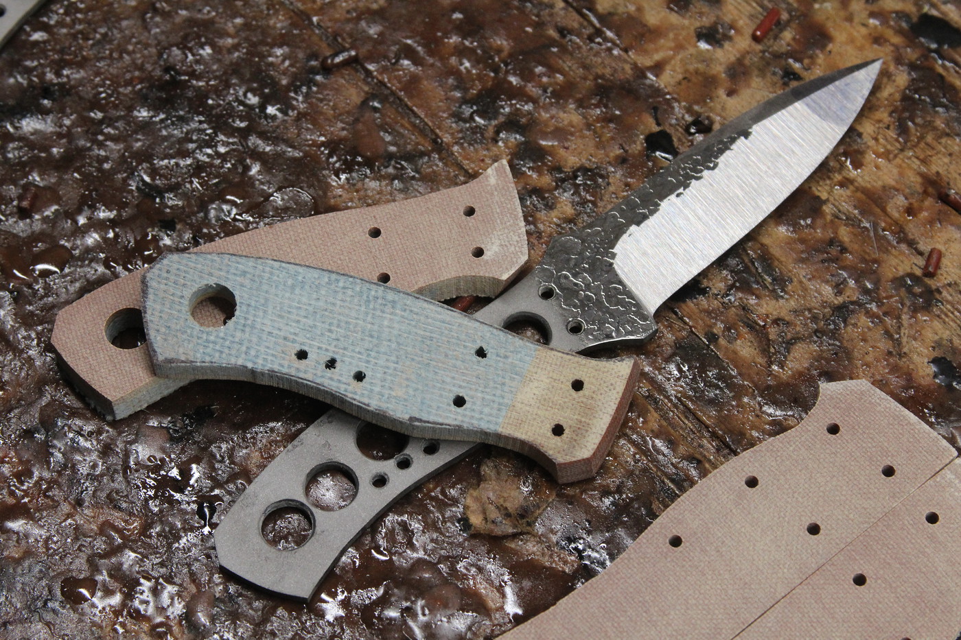

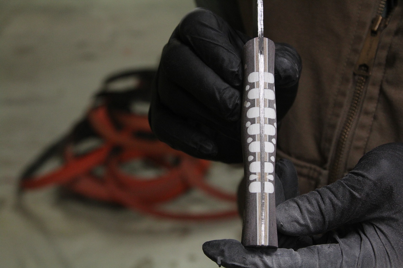

Andy’s project this week

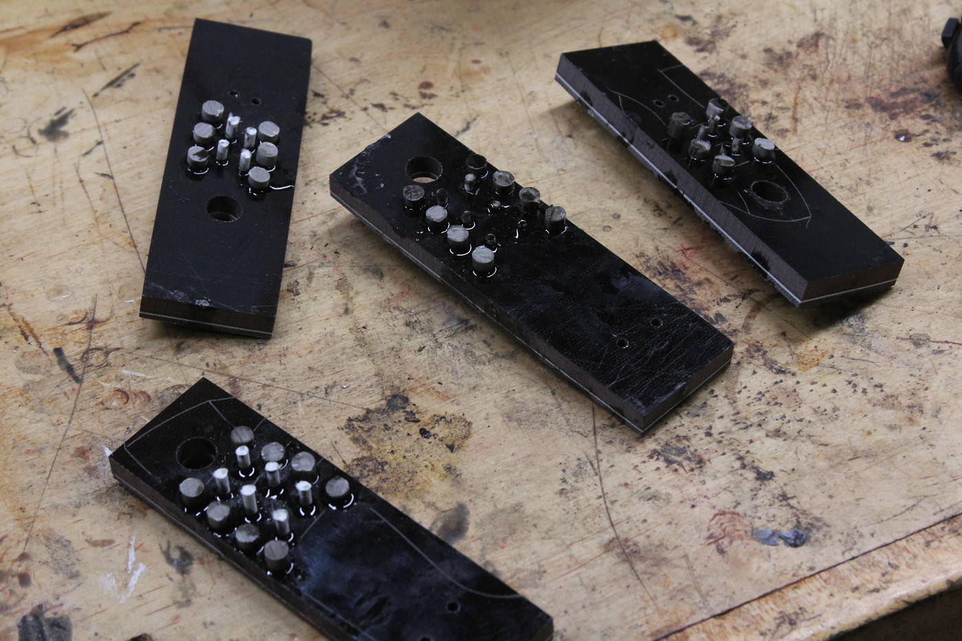

Ivy supervises Cody during the glue-up’s.

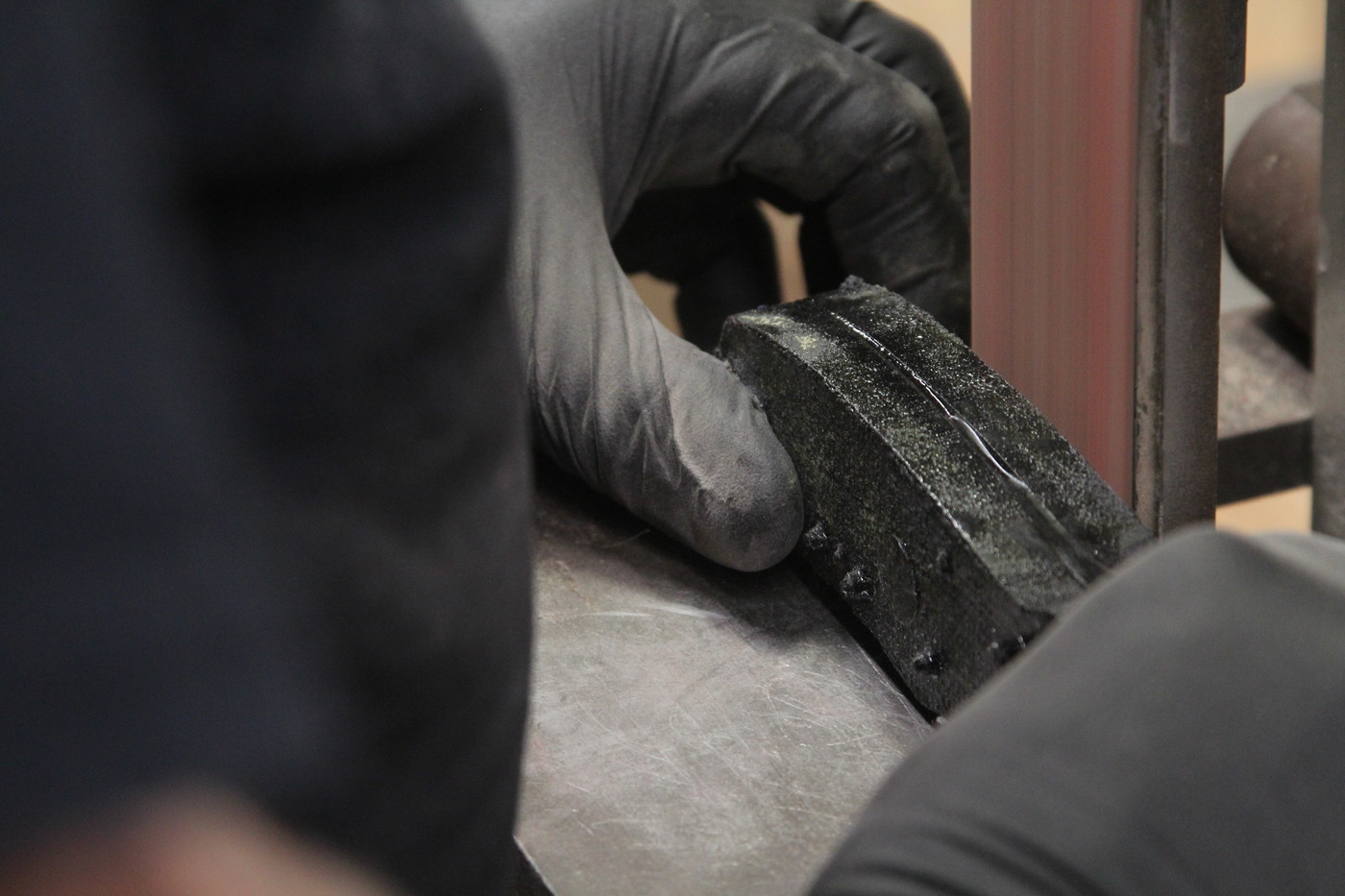

YES! I think that ever time I see someone holding a knife to a wheel. Or when he's holding two at a time it might be, "That crazy ... " :D
I do believe that one is going to turn out pretty darned cool! :thumbsup::thumbsup:
Her look kind of reminds me on Pawn Stars when Pops is watching Chumlee

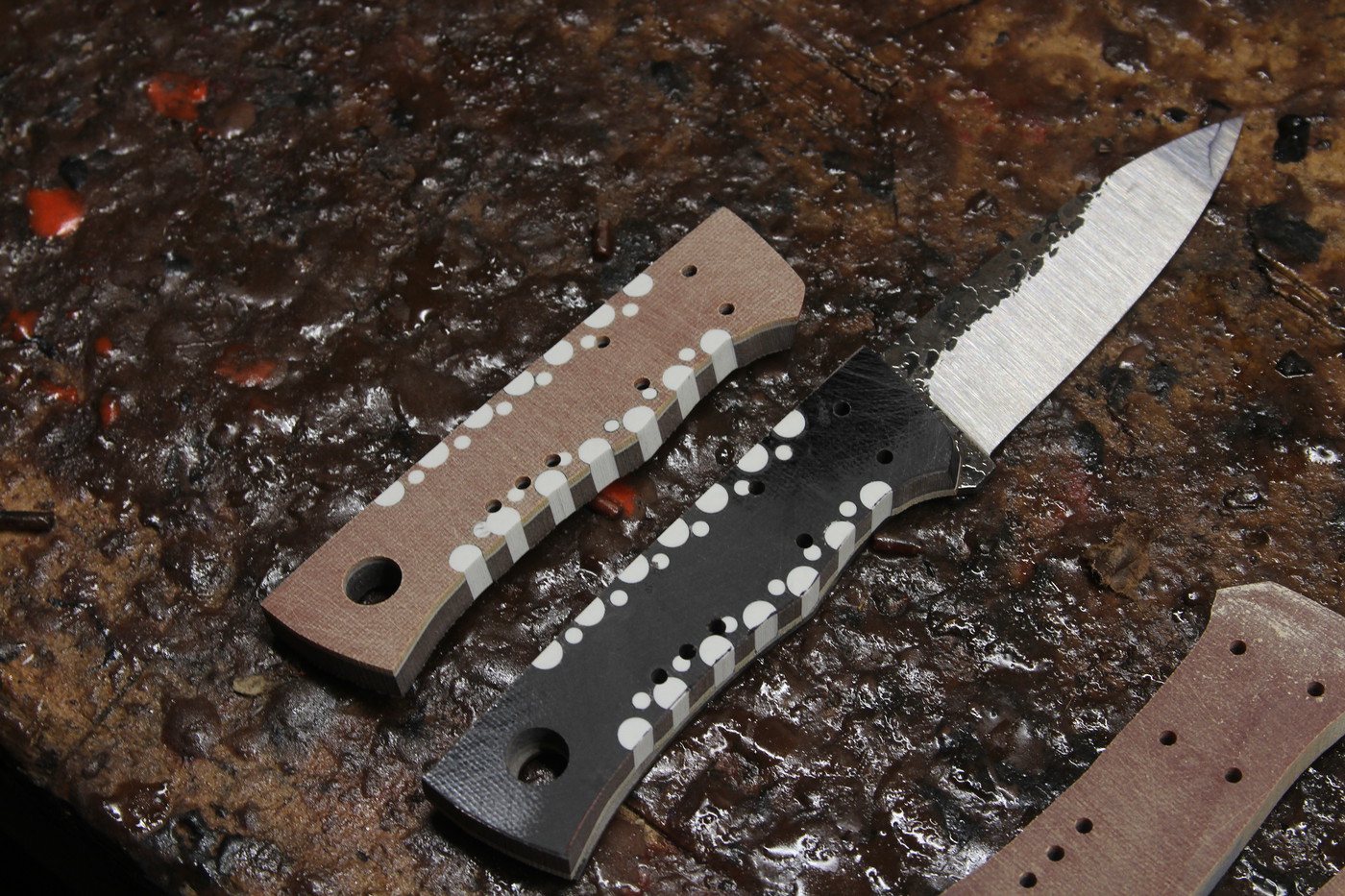

I too am digging the more symmetrical pin layout. Still think it looks like fish scales and would make a cool redfish pattern on one of the Production blade blanks after getting reground.

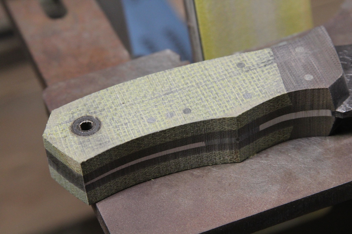

lots of grinding to be done today.

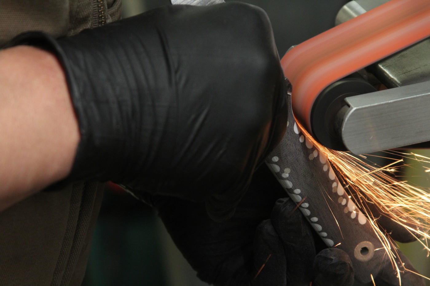

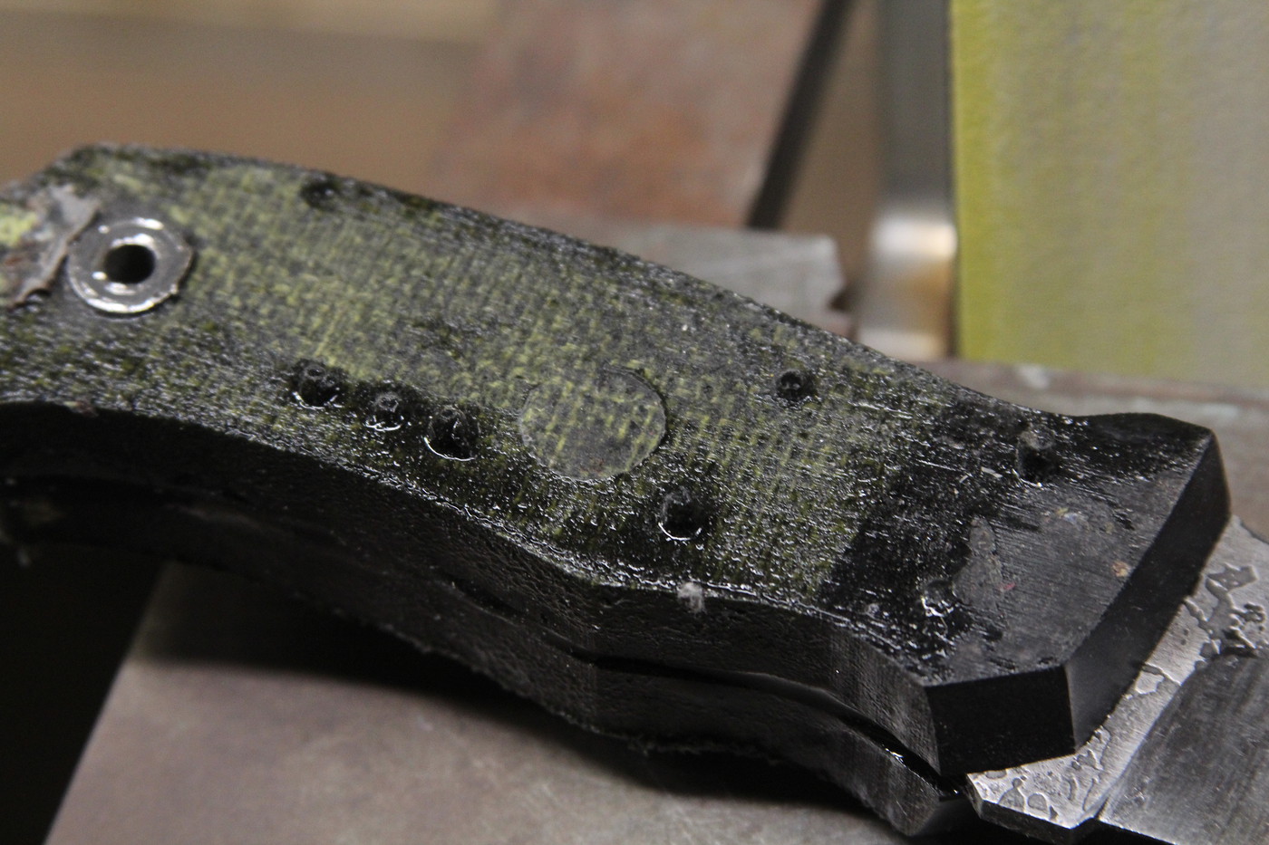

The first step to grinding the bevels is grinding a 45 degree angle.
Allen is doing the pre-heat treat grinds.

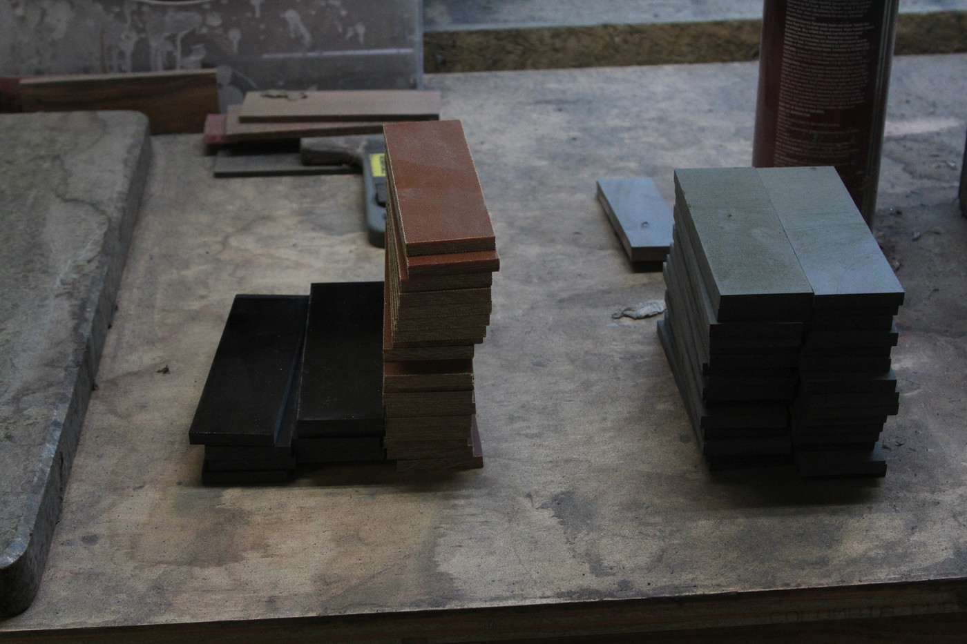

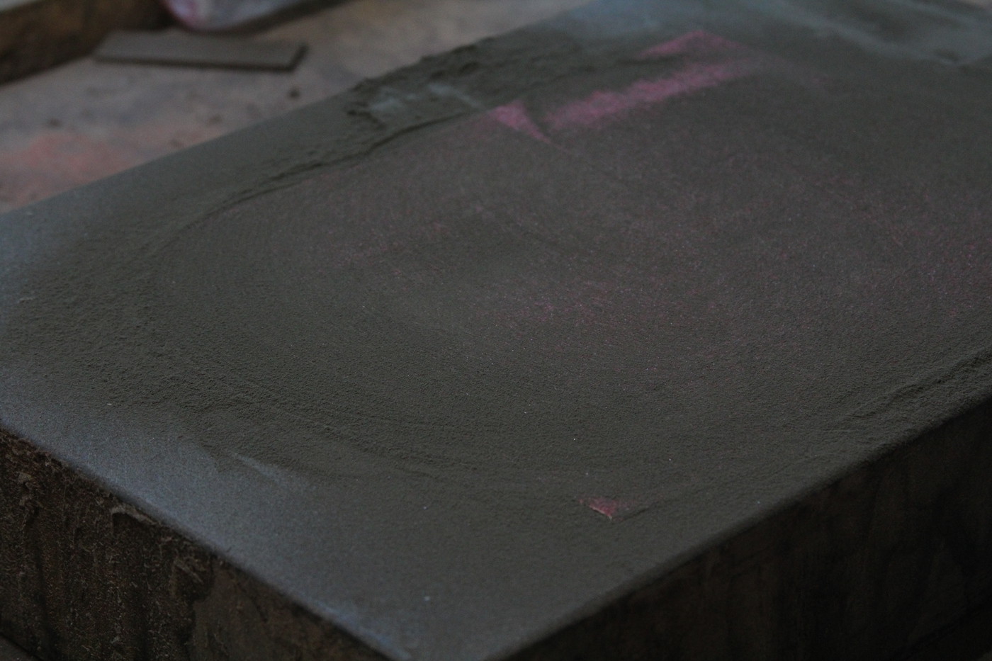

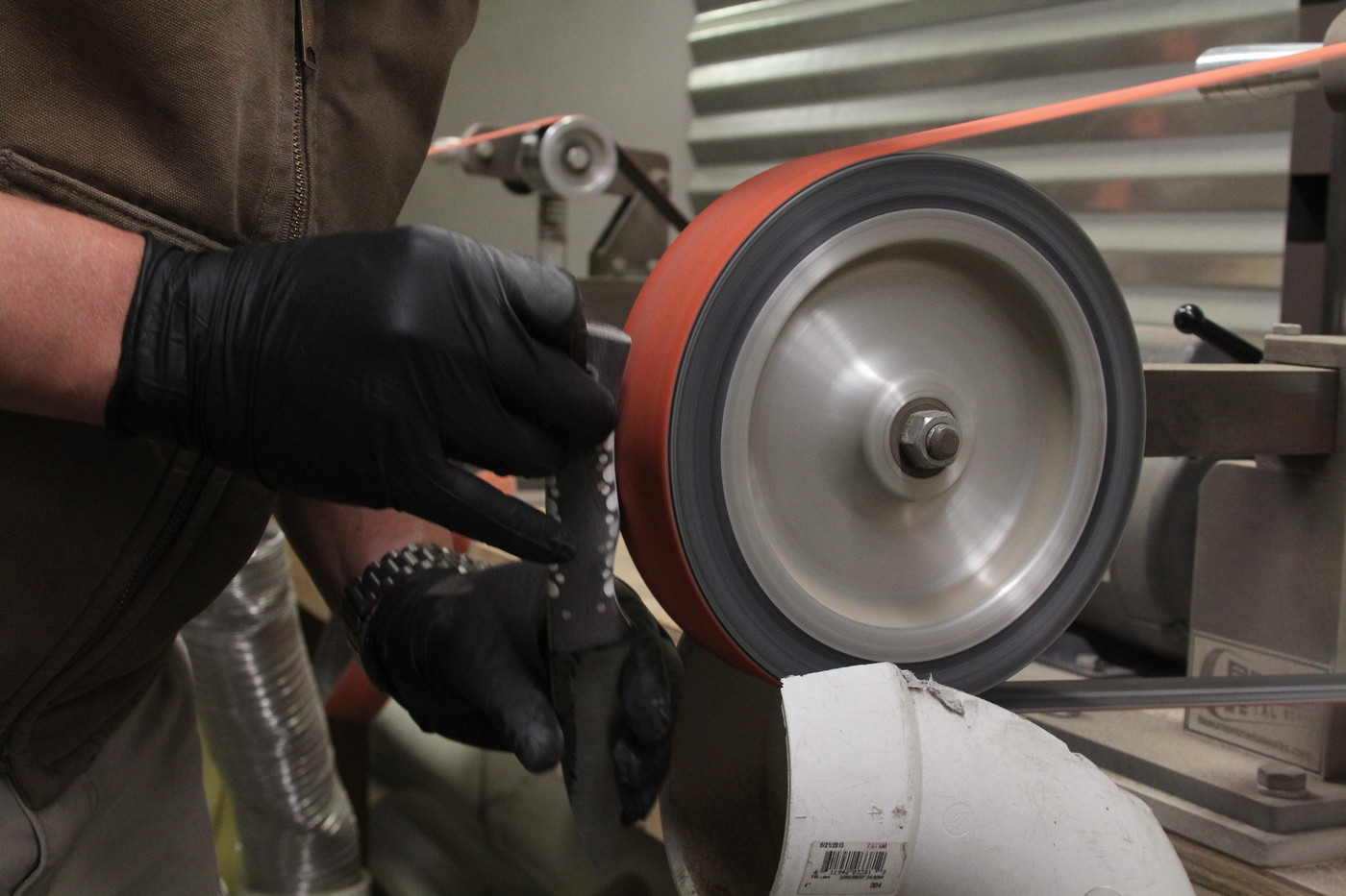

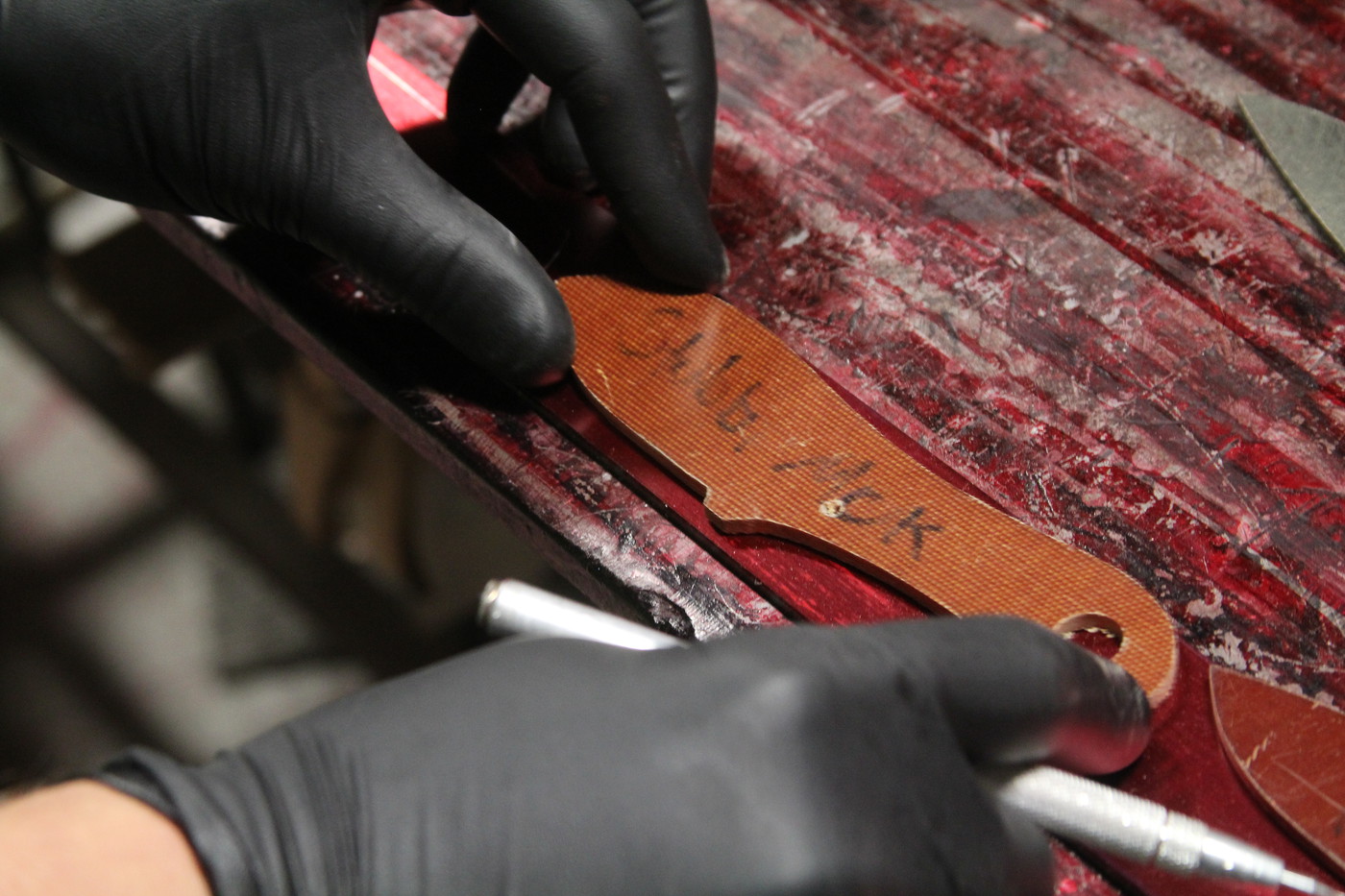

One of the most important steps. Making sure the scales are flat. They will get flattened again just before they are glued on.
There is 60grit sandpaper under there somewhere. Always clock/counter clockwise. The most important thing to remember is consistent pressure over the whole scale.

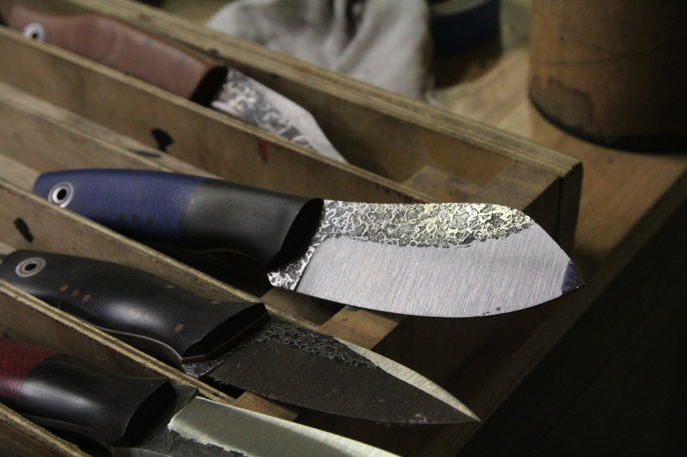

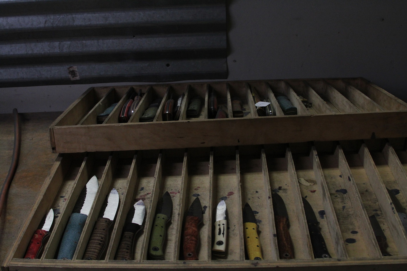

Bottom tray, 5th from the left. What model and is it evergreen shadetree?
The shadetree looks it might be emerald (lighter than evergreen), although it's hard to be sure from the picture's distance/lighting.
