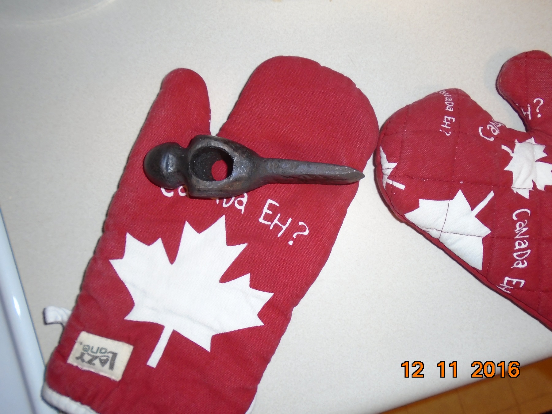

Almost 4 years ago, I came across a large ball peen hammer in a forgotten corner of my dad's basement.
Well, on November 12th, it finally began life as an entirely new sort of tool. :)

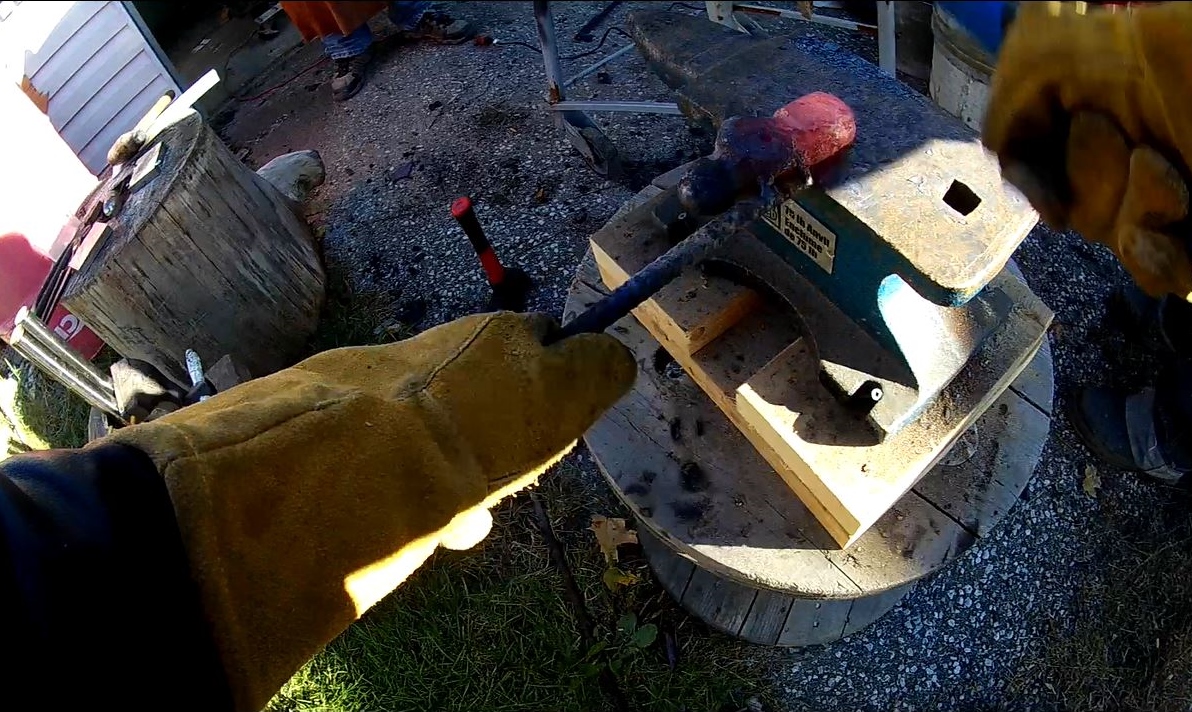

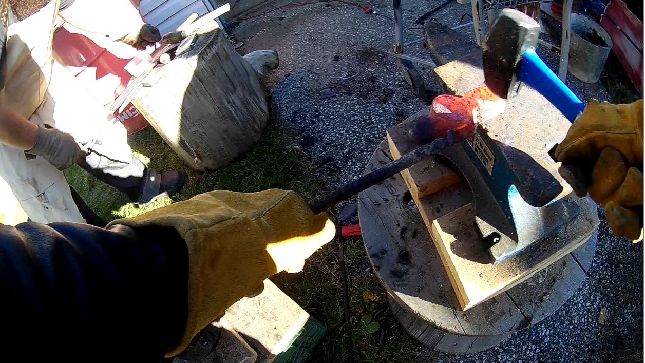

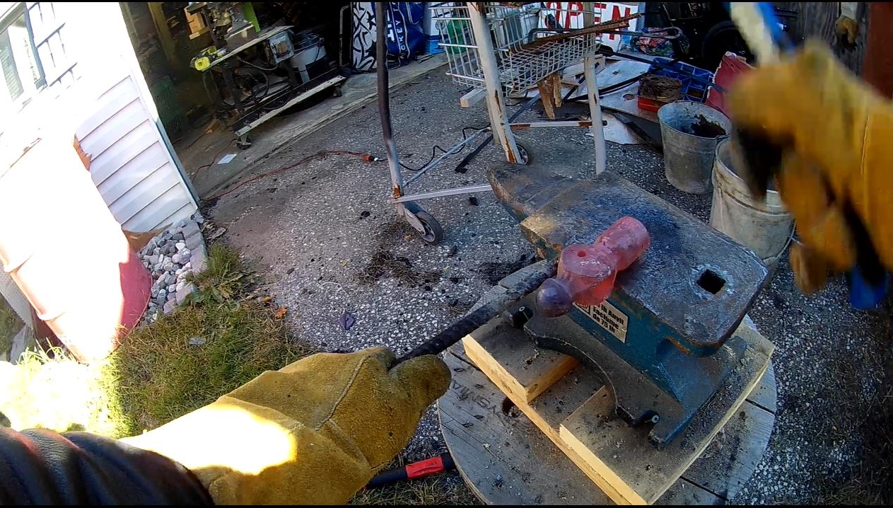

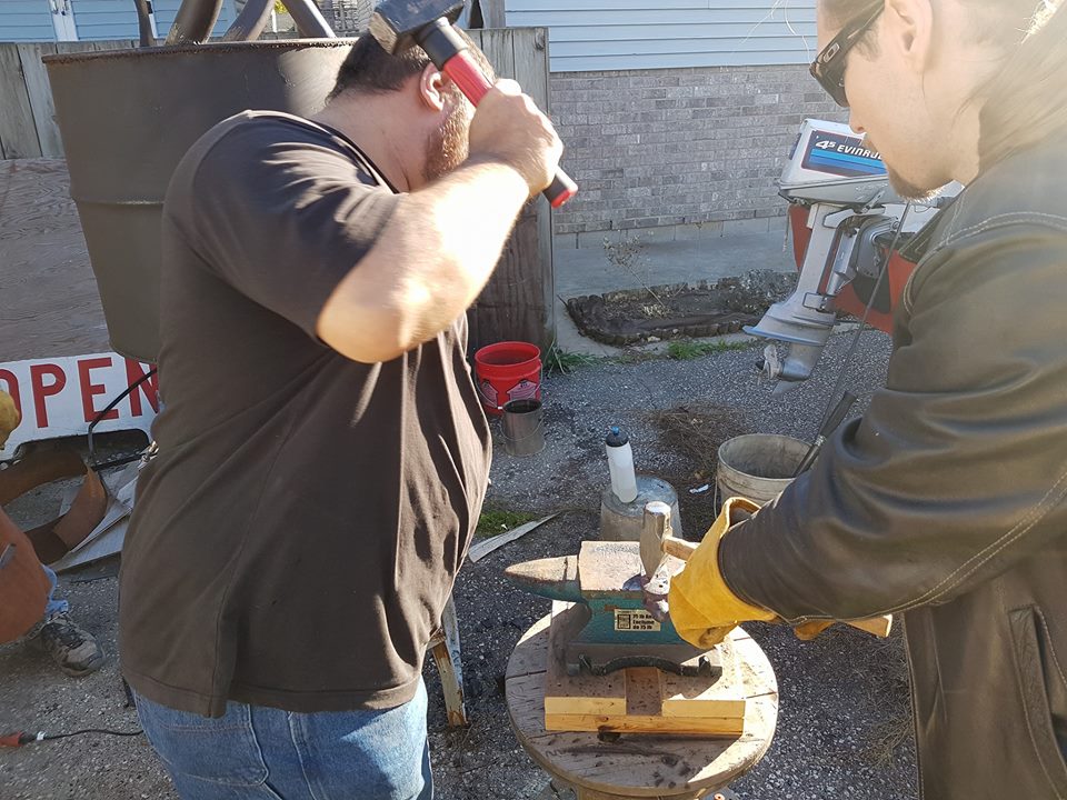

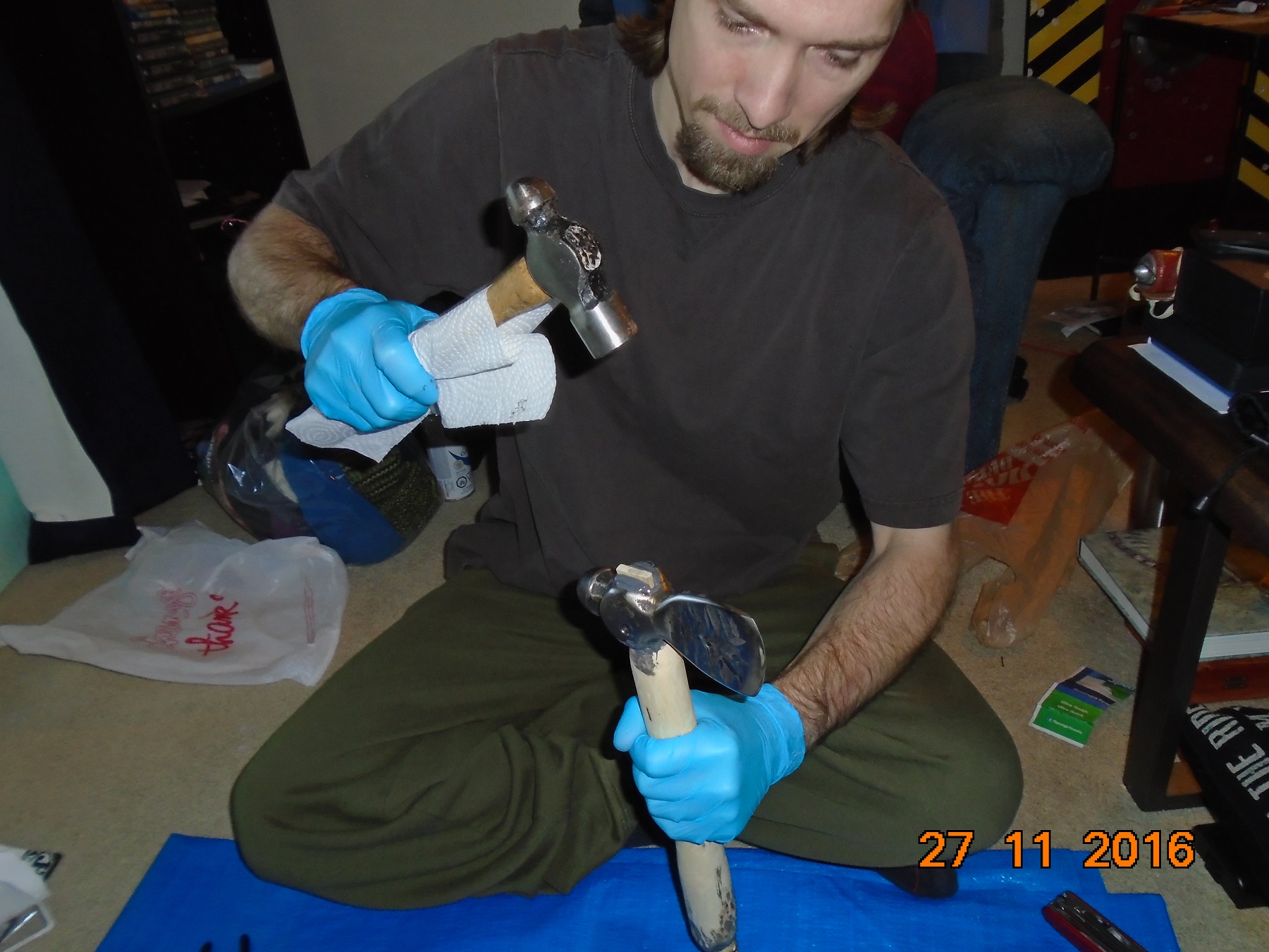

Working together makes things go easier. Here we are hitting a hammer with a hammer with a hammer (according to internet lore, we should both be dead now):
Looking more axe-like now...

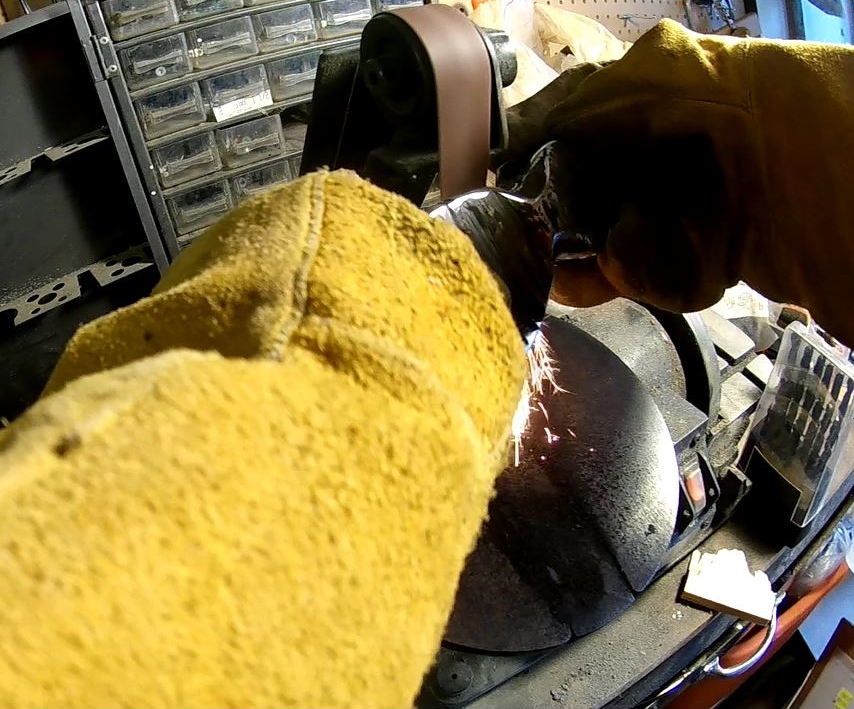

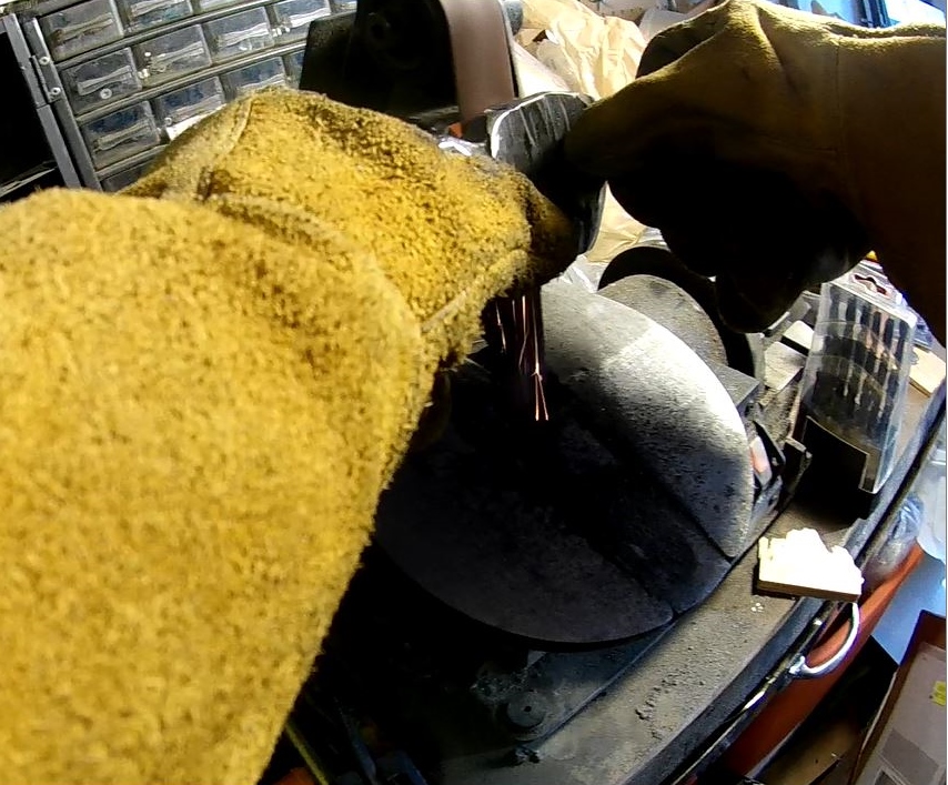

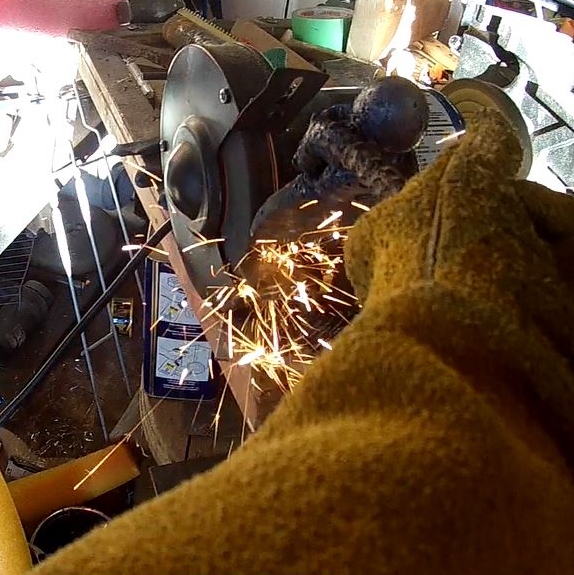

Grinding:

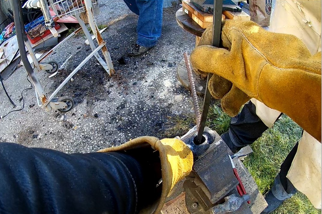

Drifting:

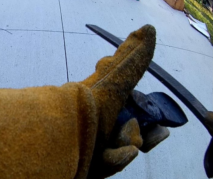

Filing:
More grinding:

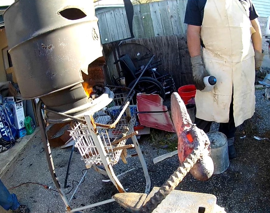

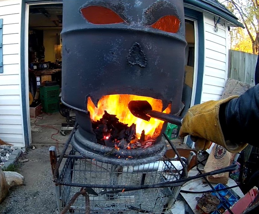

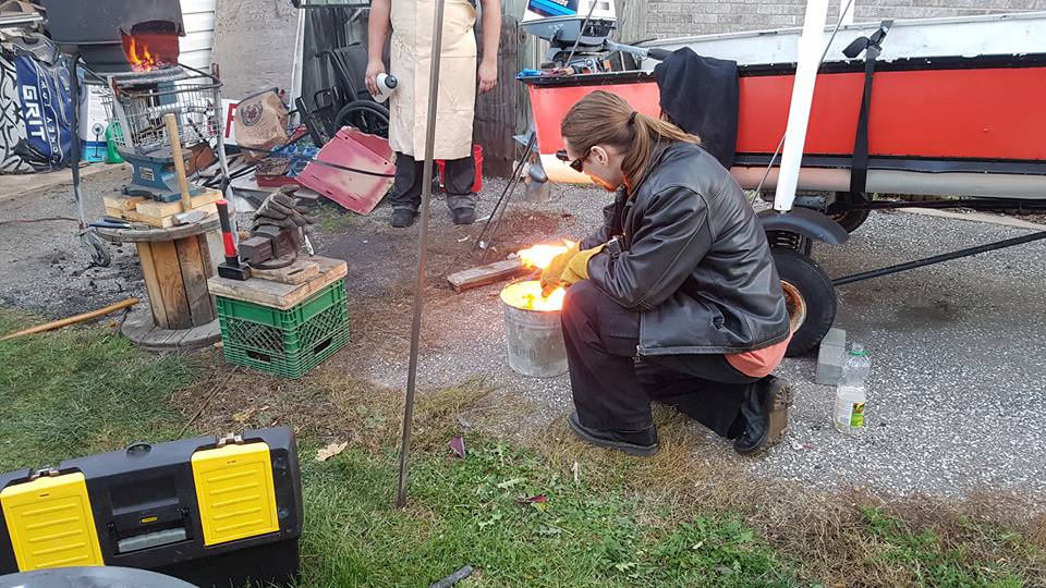

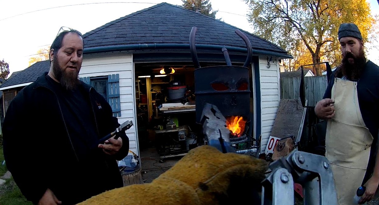

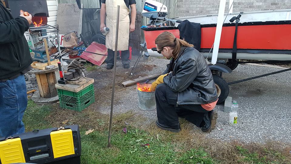

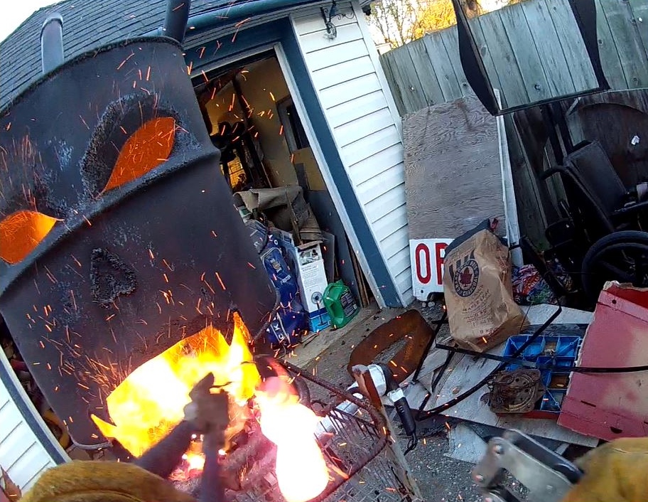

Stoking the forge in preparation of heat treat:

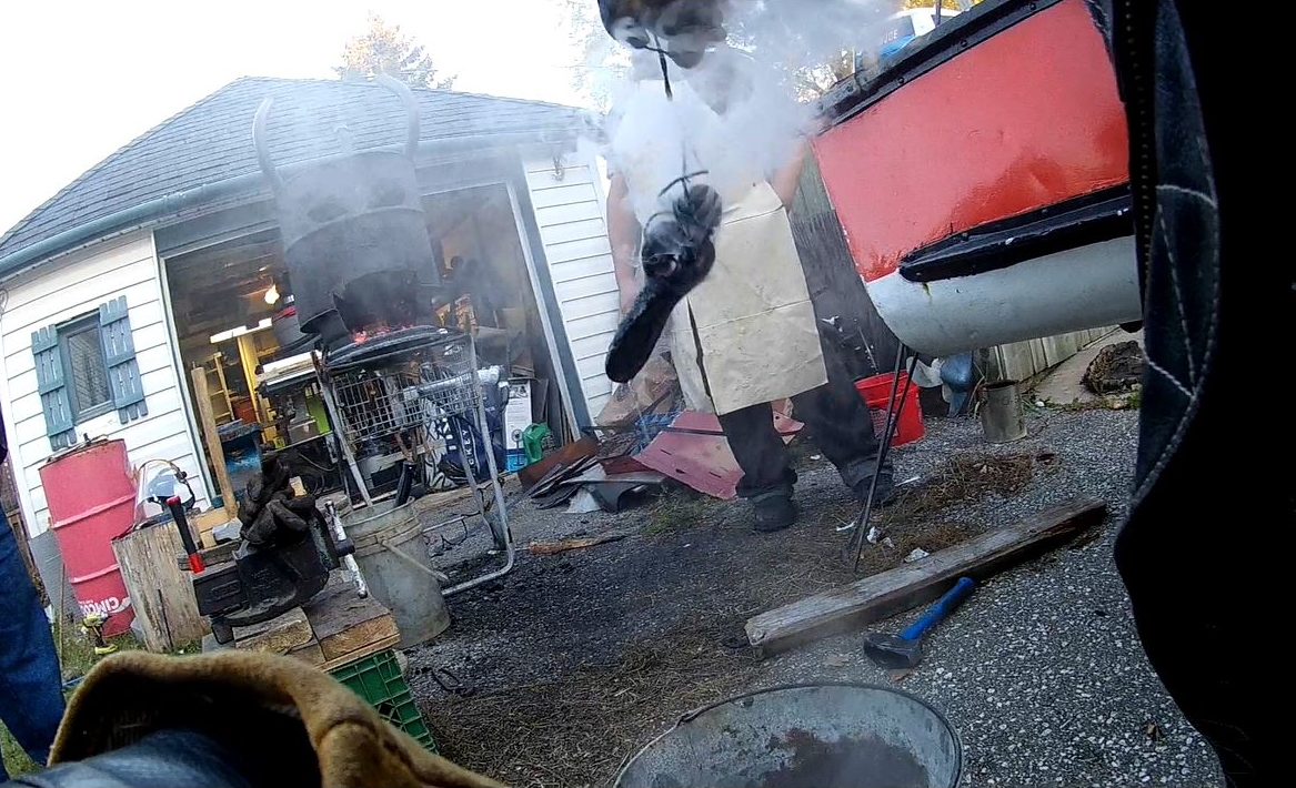

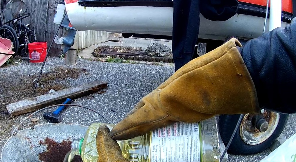

Quenching oil:
Got my magnet and channel-lock pliers ready:
Seems to be hot enough! :eek:

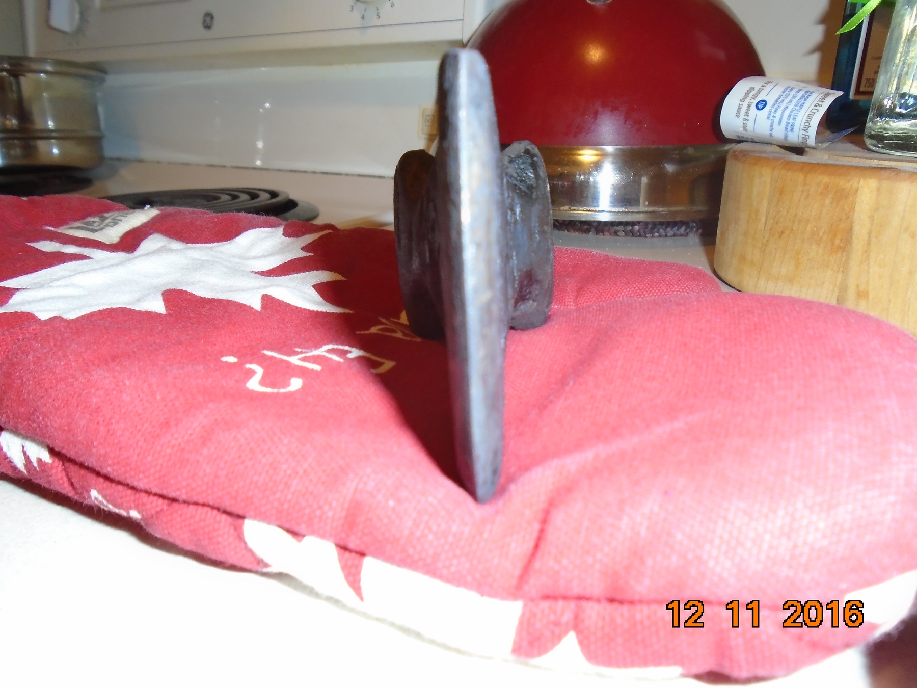

After tempering:
This crappy picture is of me channeling the power of the Super Moon into the eye of the axe, focused through an amethyst crystal ball...because why the hell not?

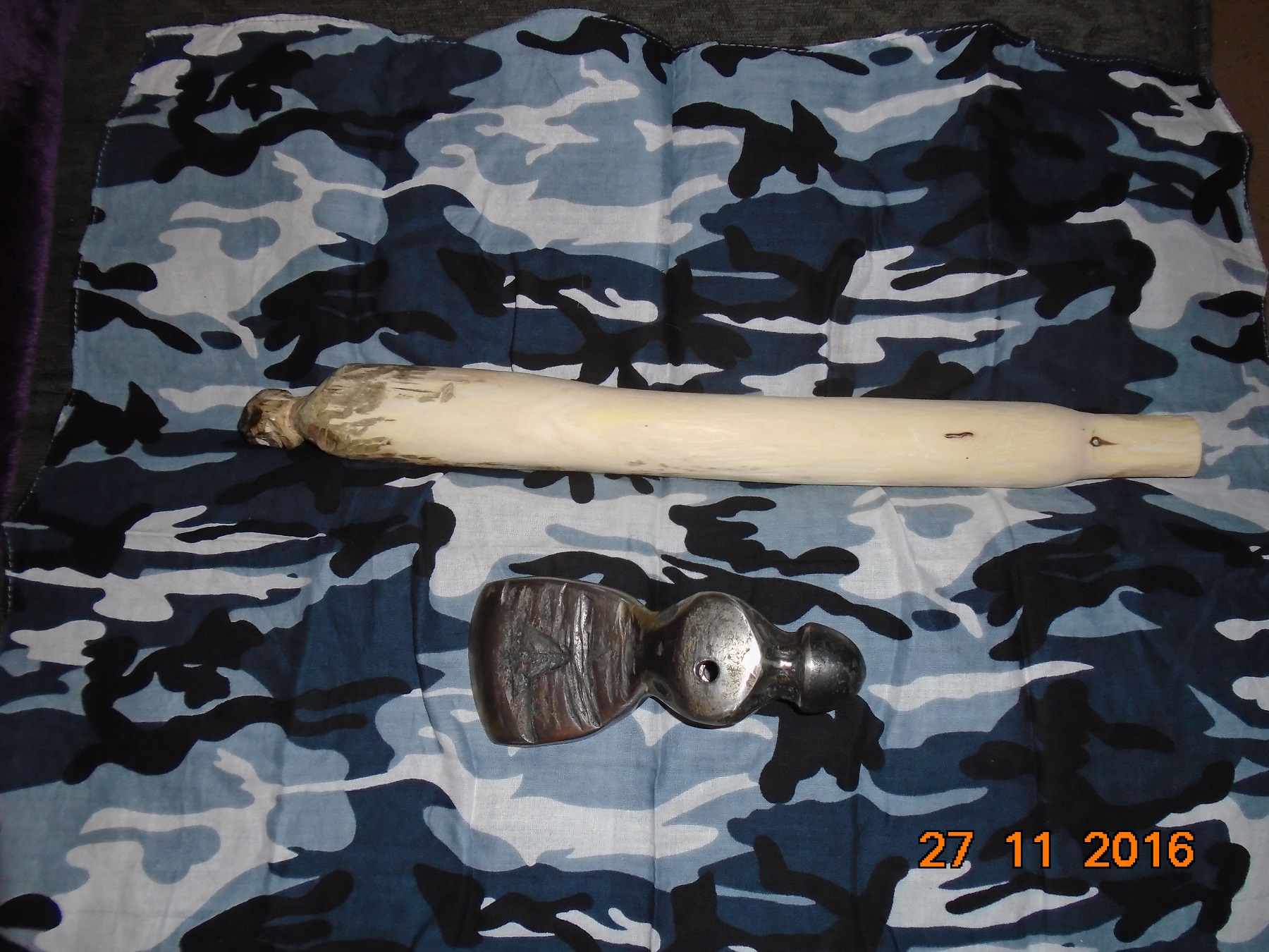

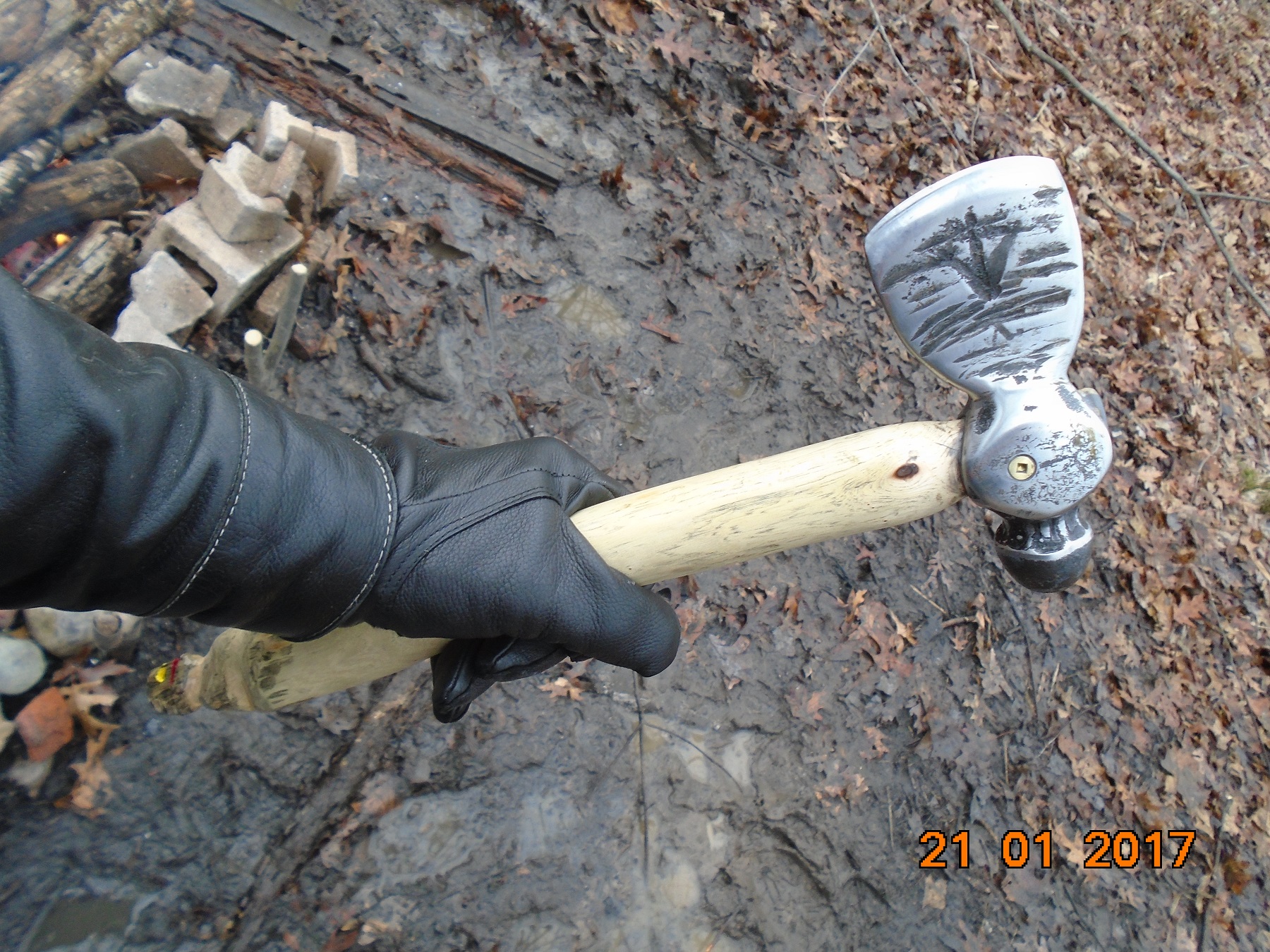

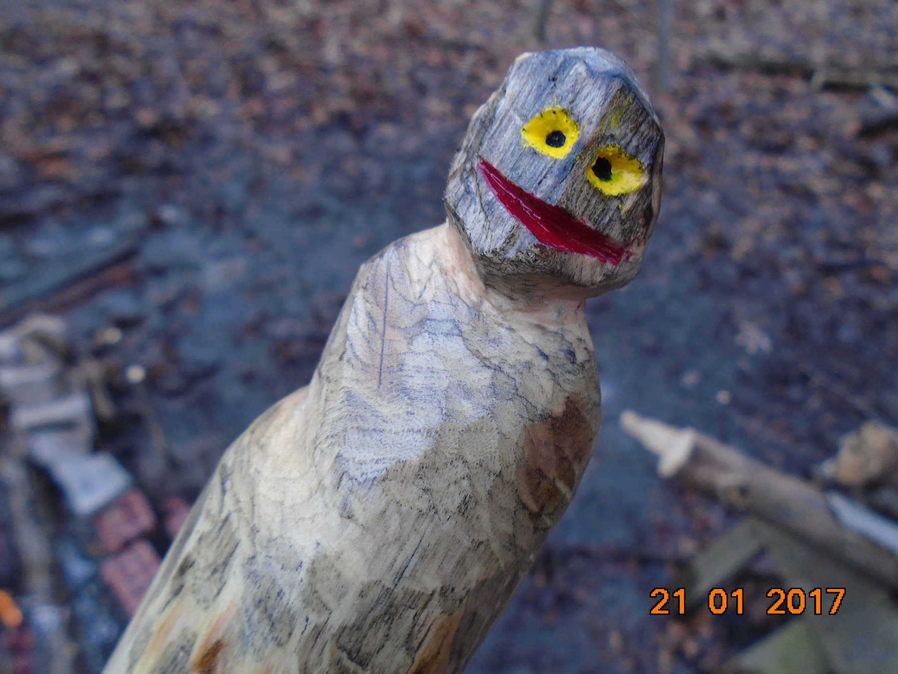

I had bought a 14" engineer's hammer handle for it, but after I carved it to fit the eye, I saw that it had a slight warp. Not good.

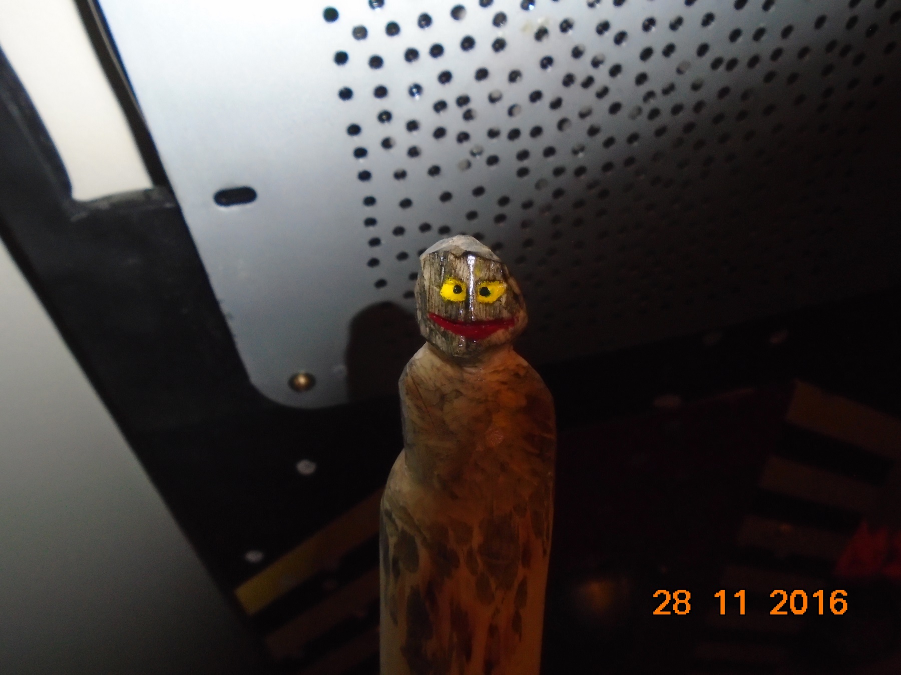

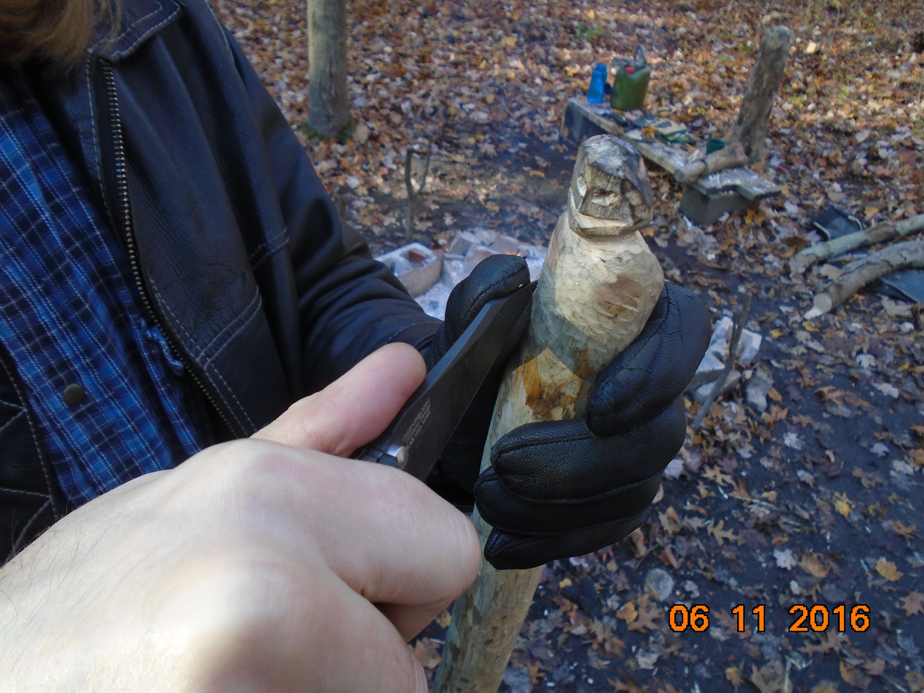

So, remember this face I carved into a walking stick I made last woods outing?
I made it into the handle for the axe. :thumbup:

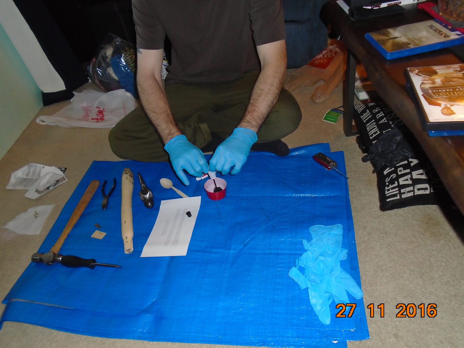

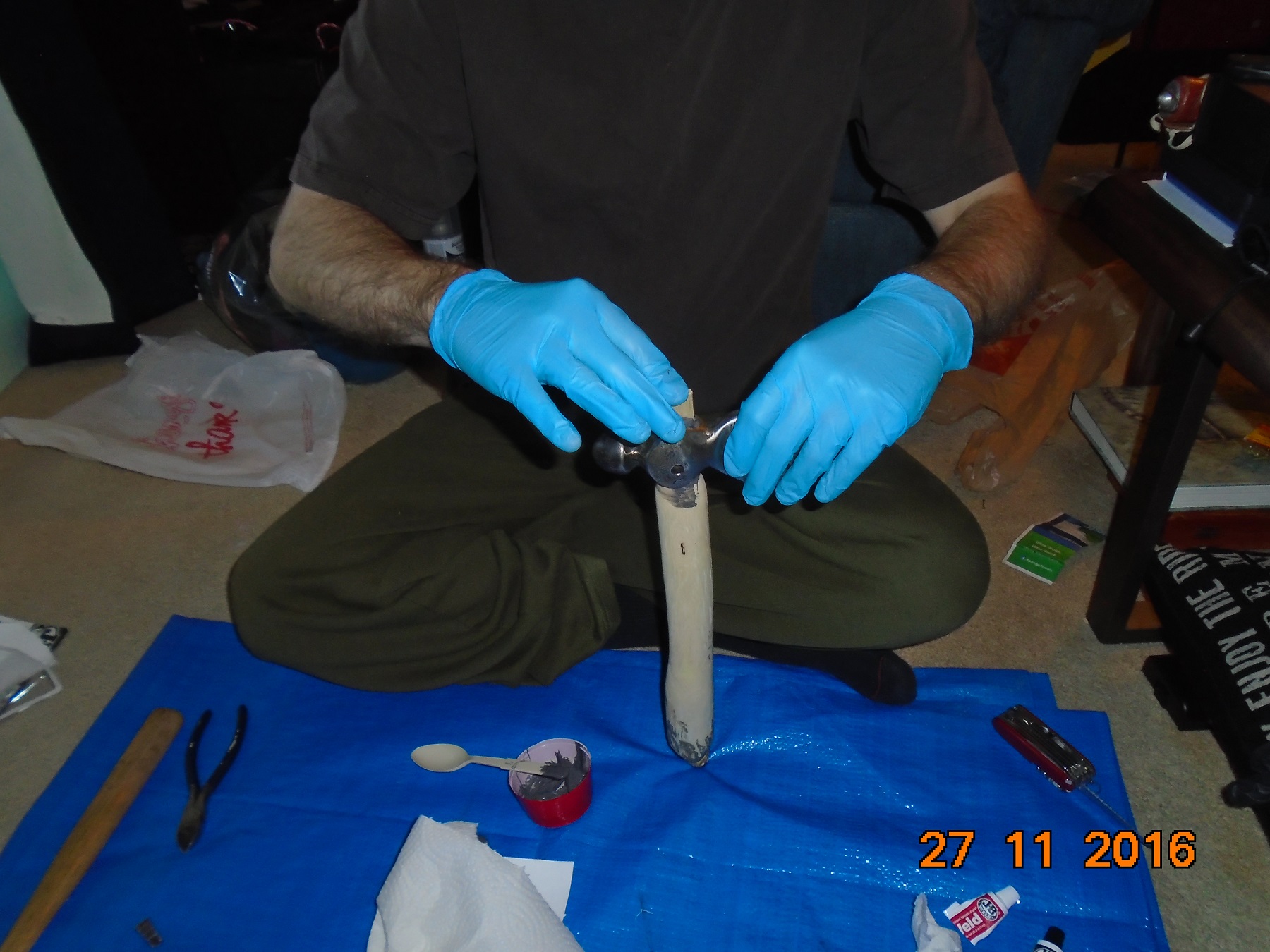

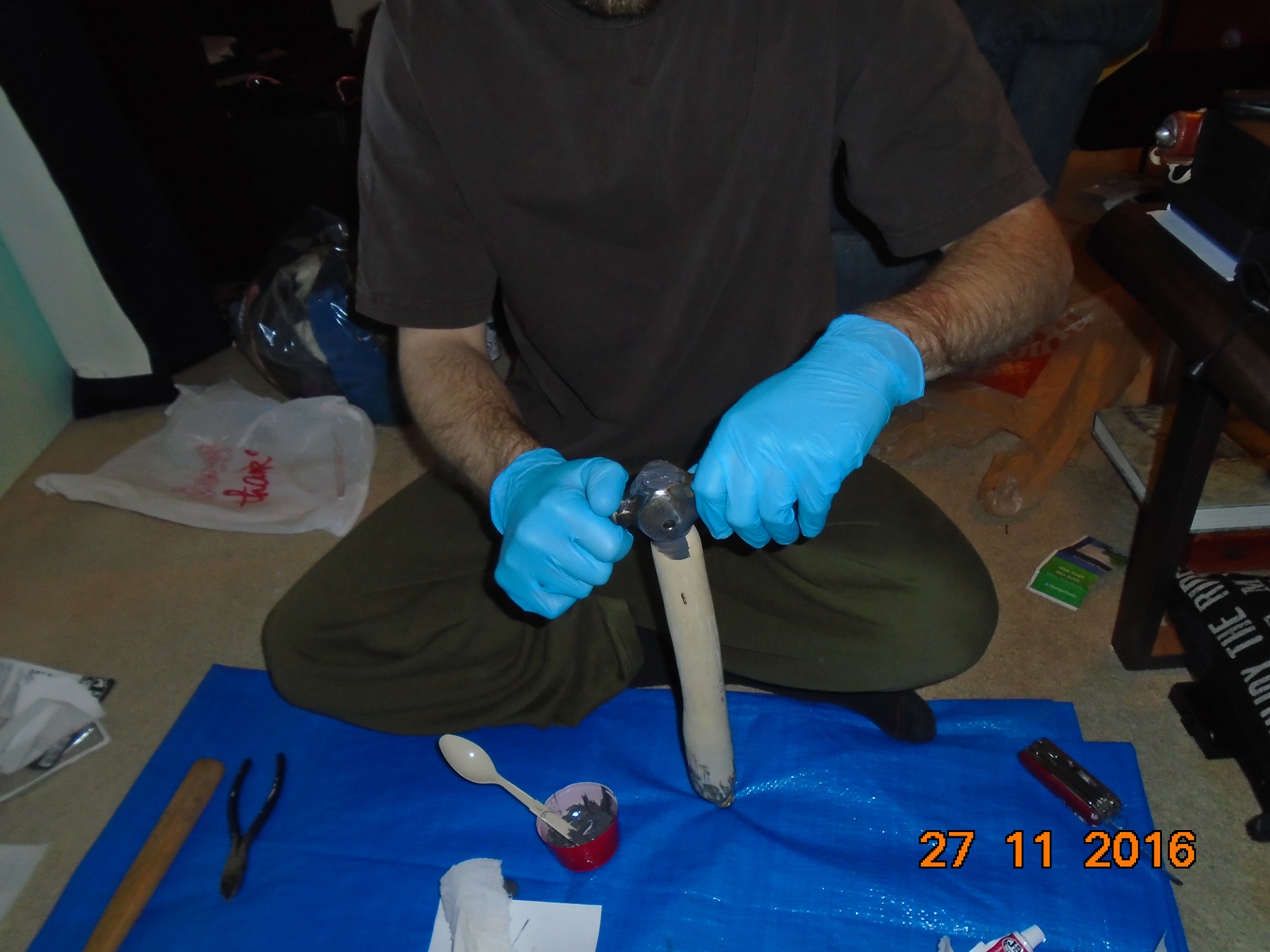

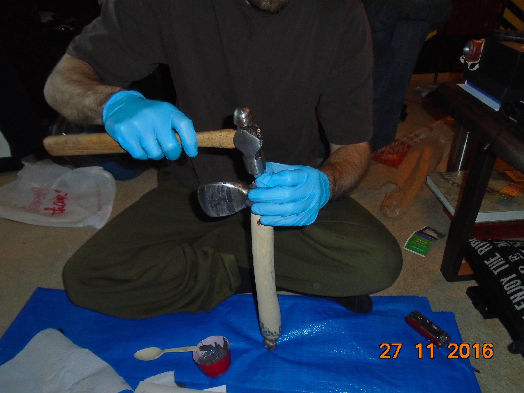

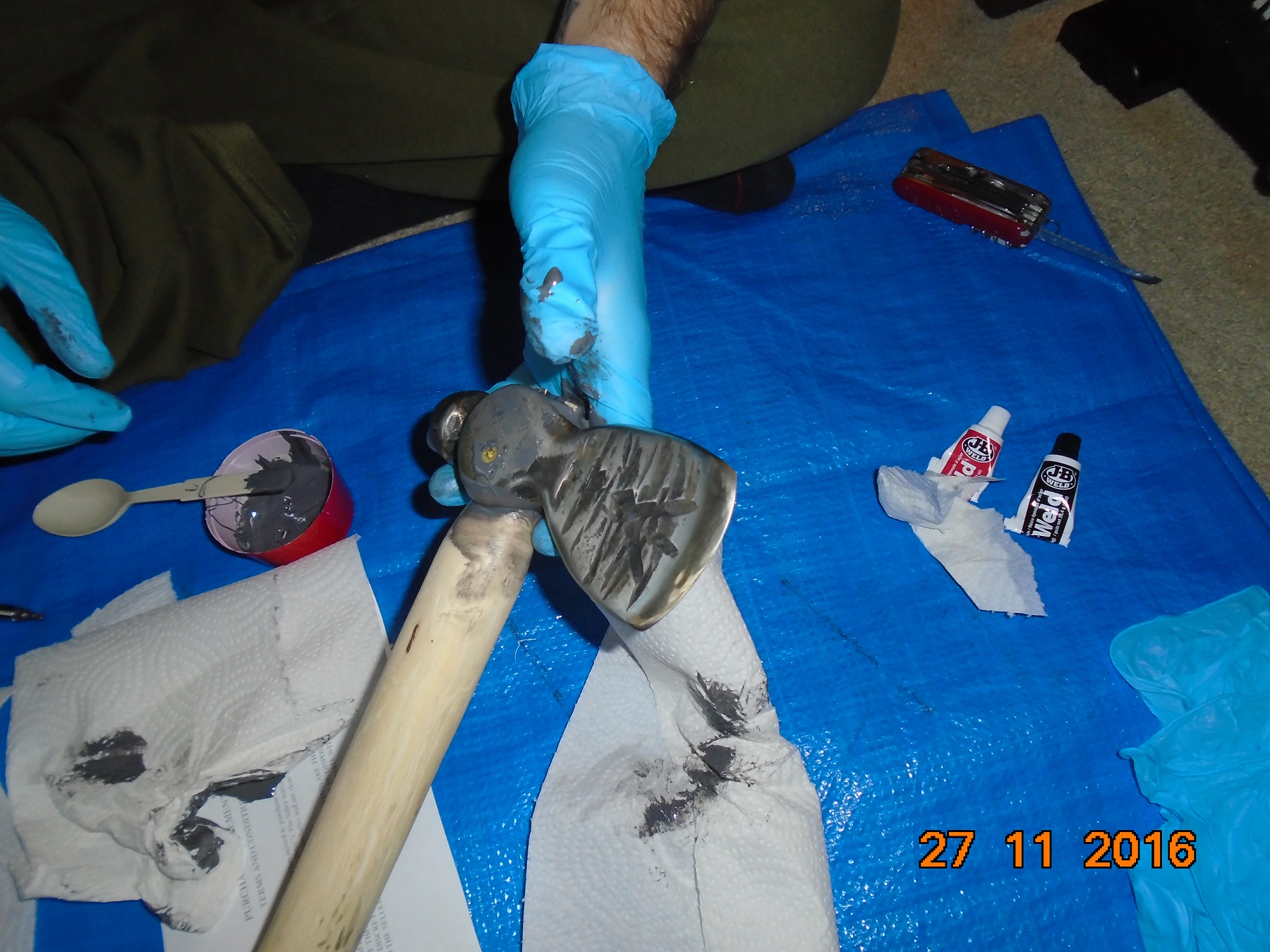

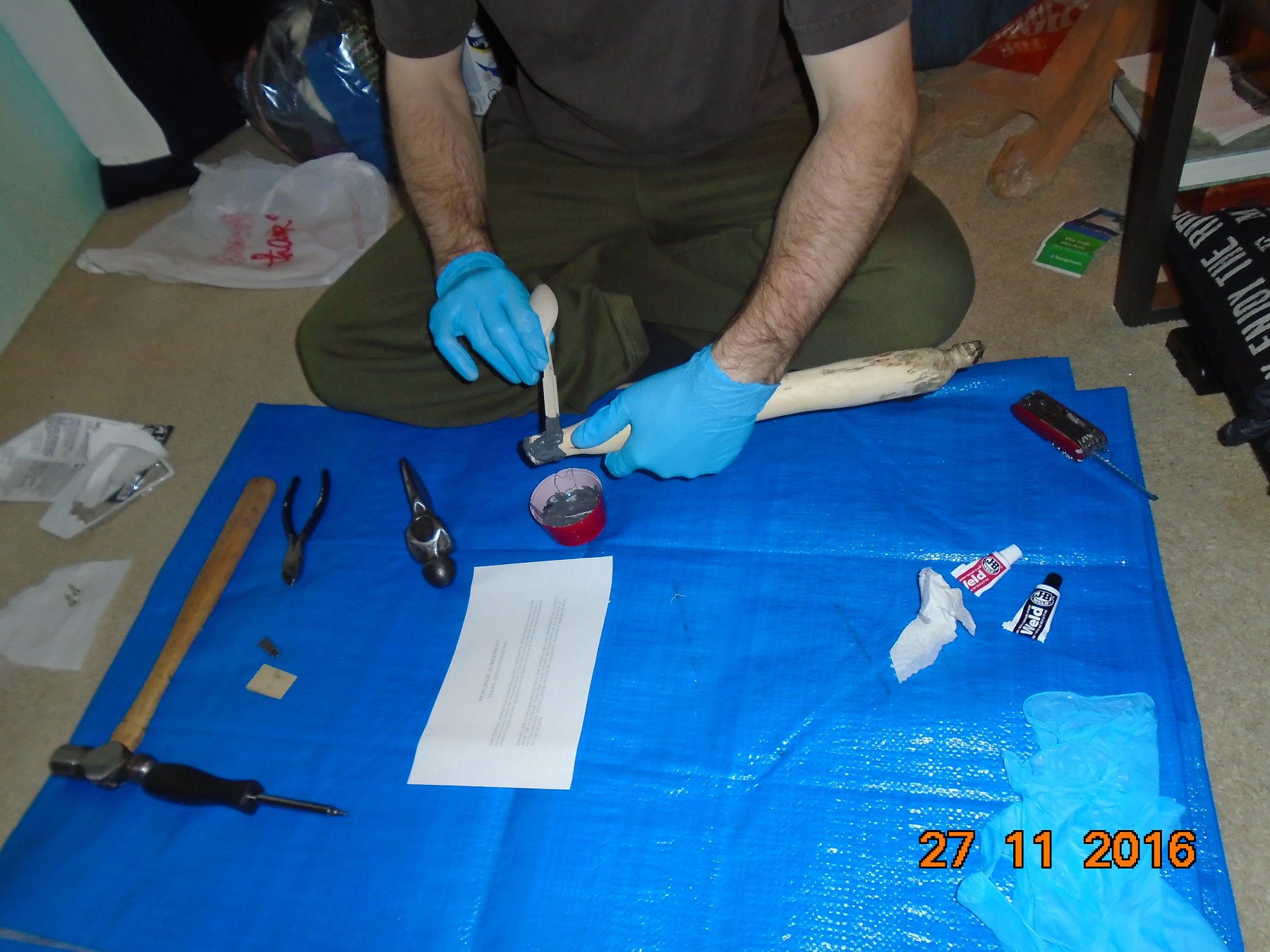

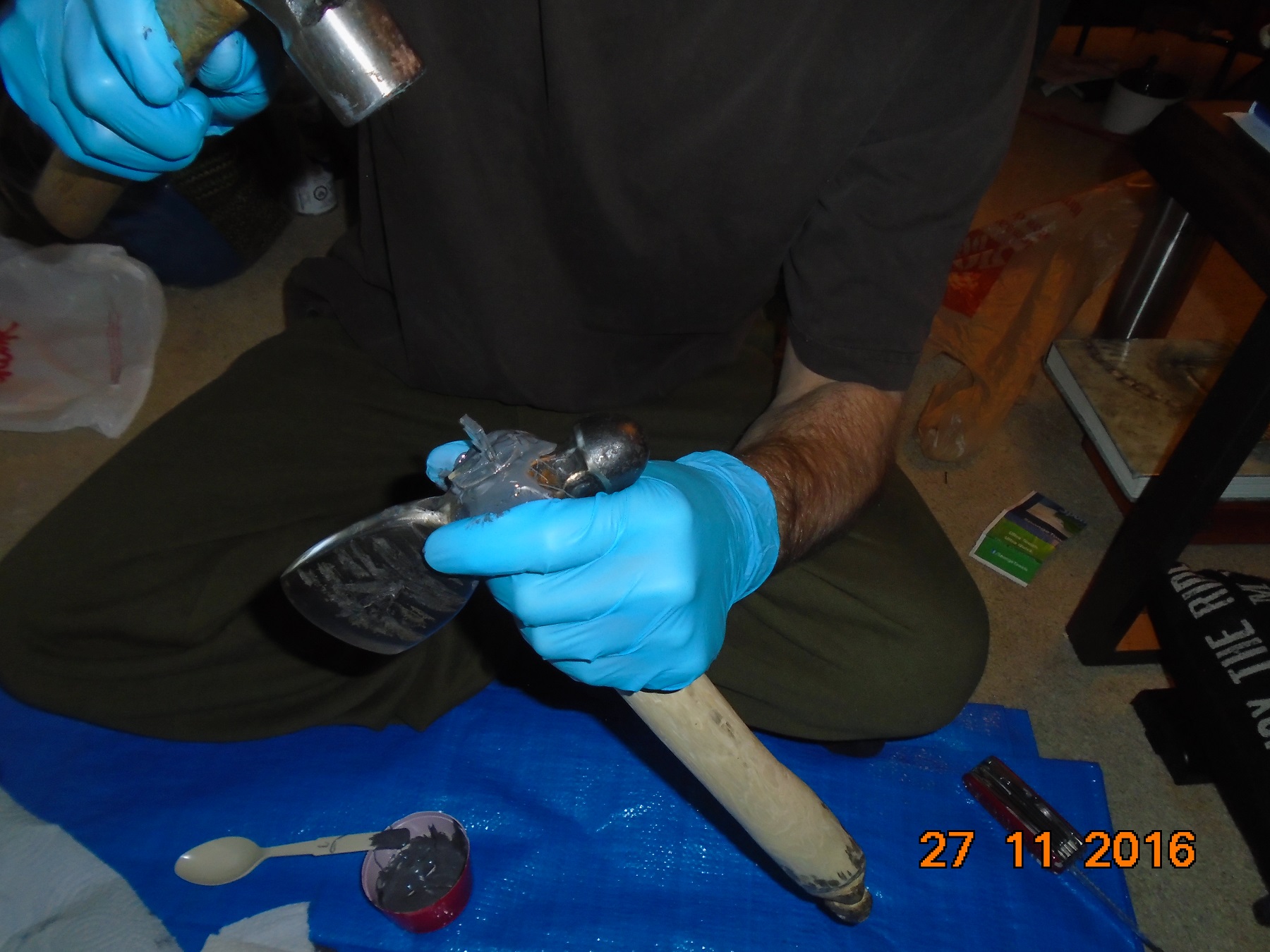

Assembly time!
JB Weld, wooden and metal wedges, and 2 brass screws; should be solid.

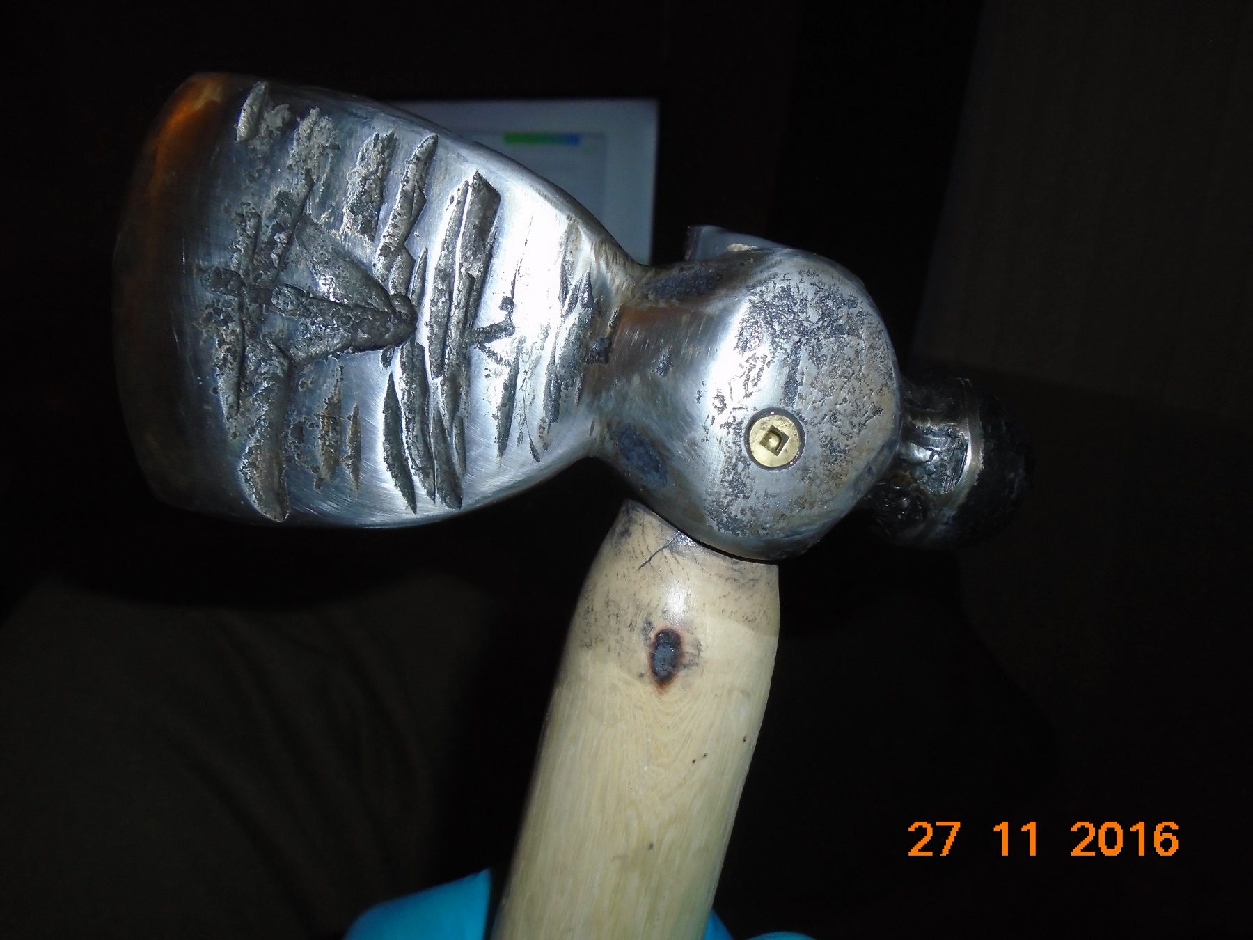

Painted the face:

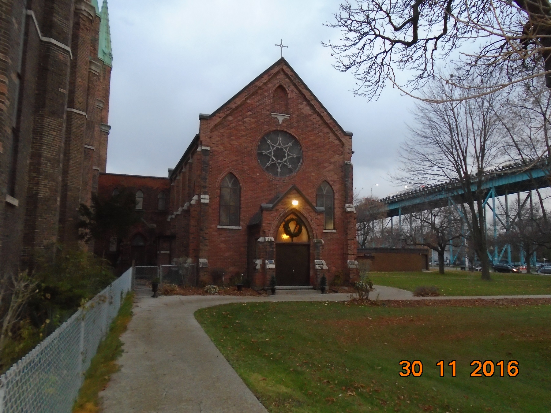

I went to a very historic church here, and got the axe blessed in the Rosary Chapel (the main church building is closed pending $9000000 in repairs):

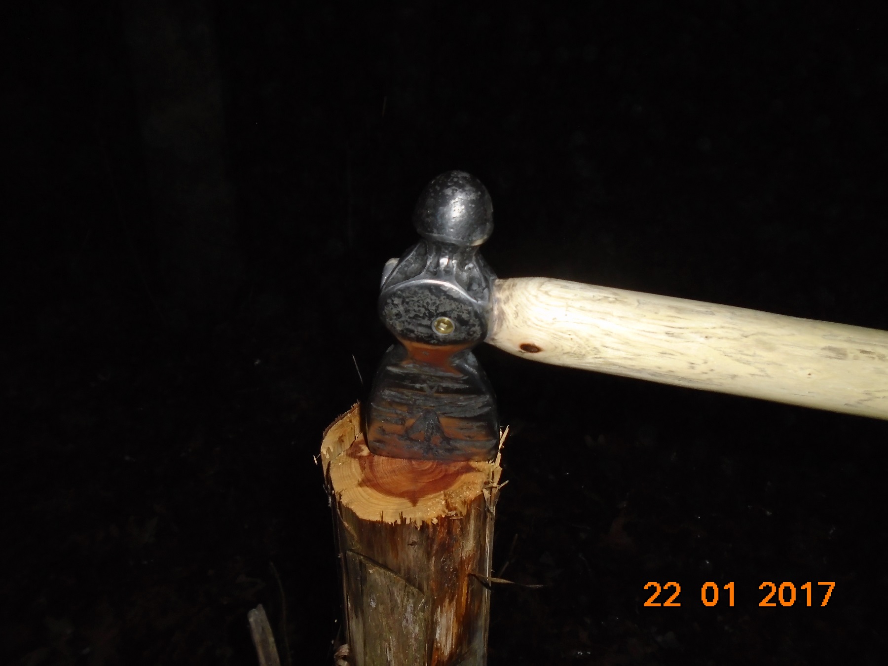

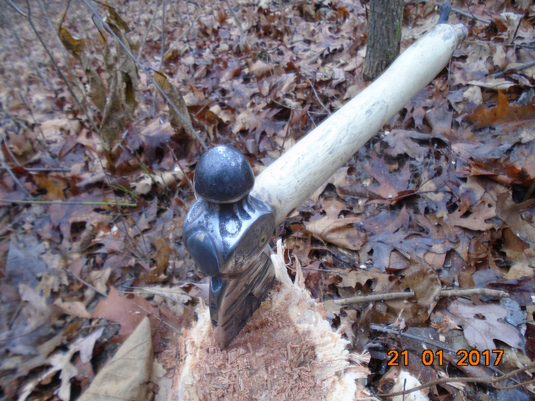

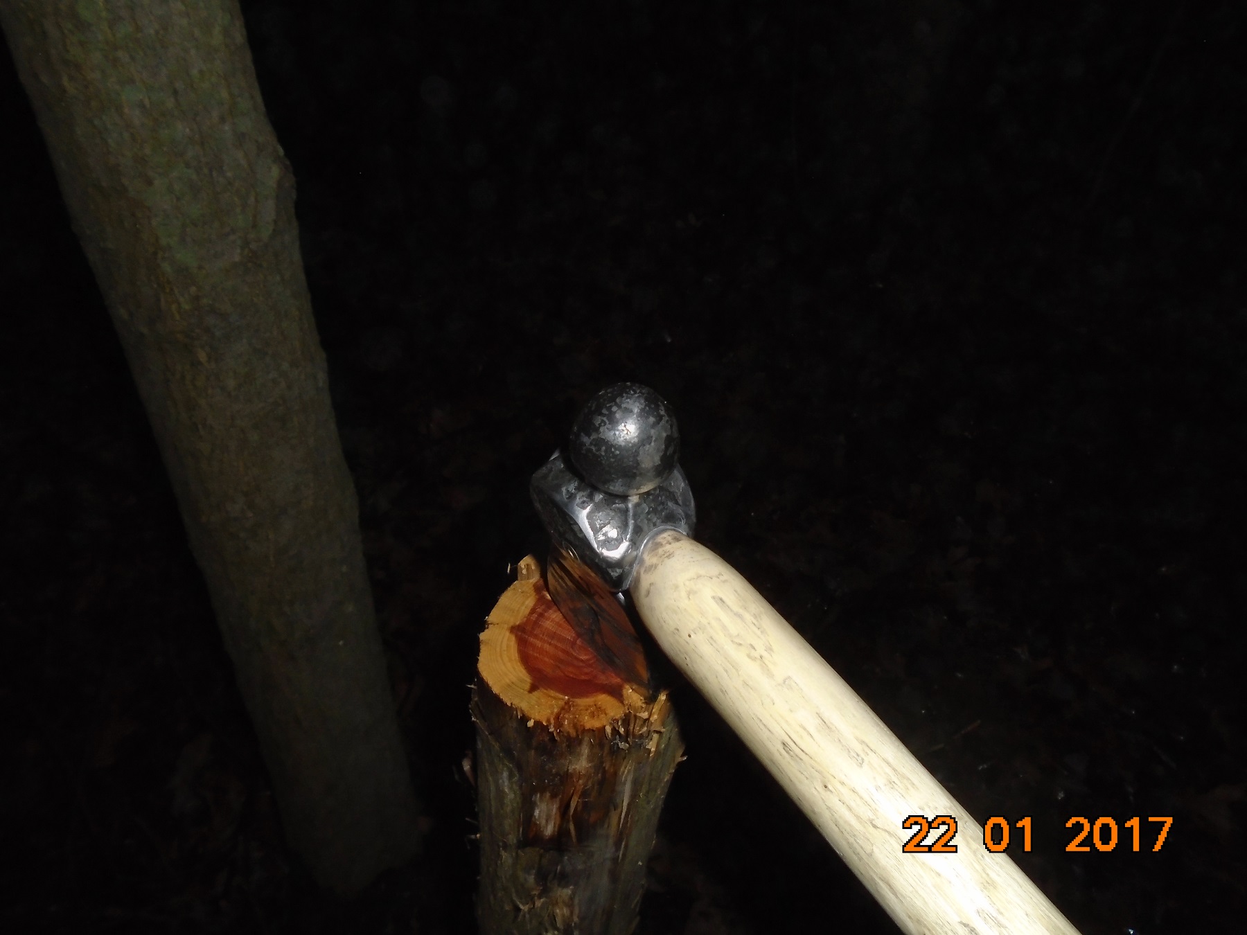

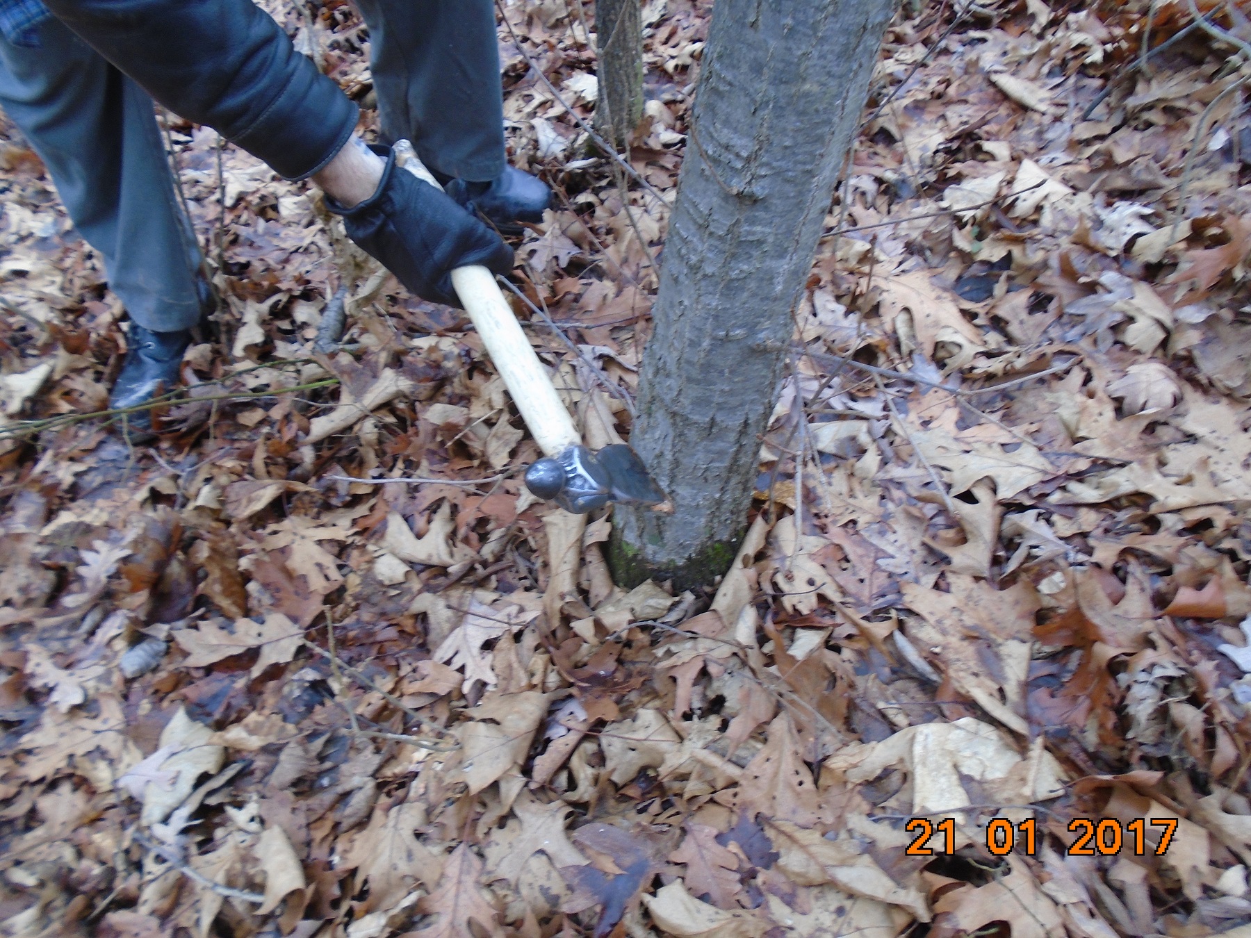

But does it work?
Seems like it.

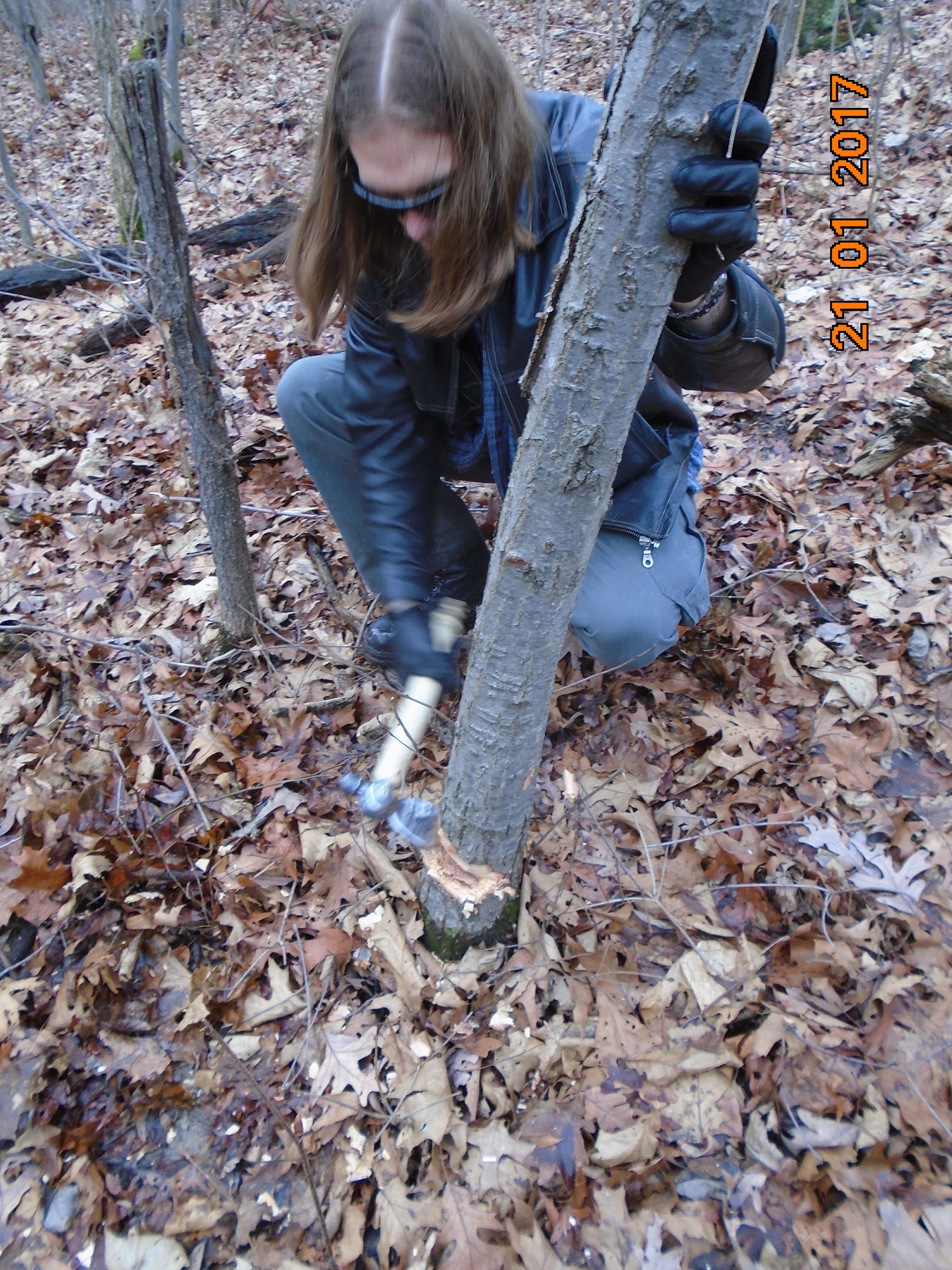

I chopped down this dead tree that had seasoned into a damn tough piece of wood:
Lookin good!
Really cool!

I was amazed at how much effort and time it took to move that much steel.
This is the first thing I forged where it started as a large "lump" of material. Prior efforts involved bar stock, which was a lot easier.
Each time is a learning experience though. :thumbup:
Glad to have an actual forge to use this time, rather than the improvised ones used for prior projects.

Checked out the edge, and it held up pretty well.
It will require a bit of touching up (looks like I hit a very small stone that was in the bark of that dead tree), but nothing major. :)
