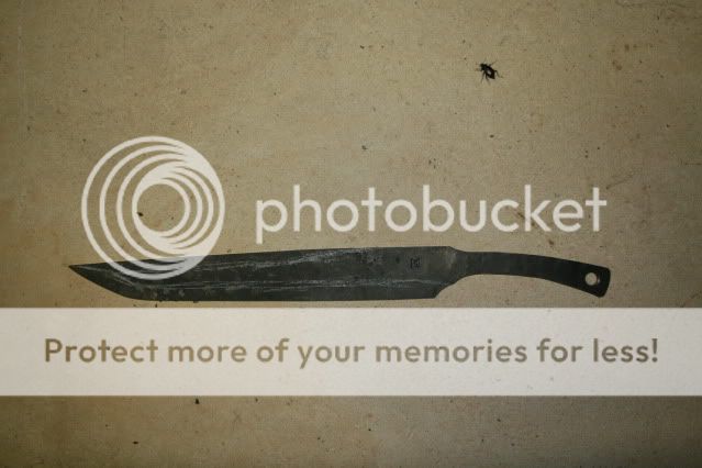

After an overnight vinegar soak to eat the scale off and stock removing primarily by hand filing, I had this:

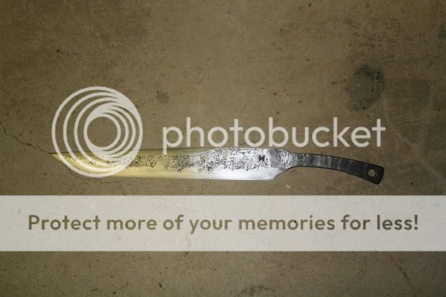

Heat treatment was my standard triple normalization, triple hardening, triple tempering process I use with 5160. After cleanup, it looked much the same as before.

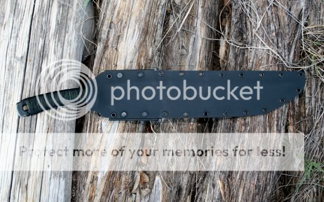

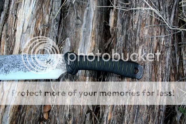

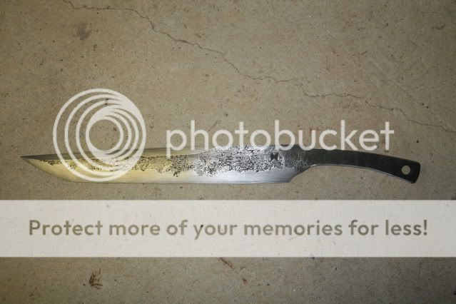

And then came the handle wrap and sharpening. Two layers of paracord, with olive drab for the underlay and black for the overlay, and a three-strand Turk's head knot all impregnated with Minwax Wood Hardener. Kydex sheath with two MOLLE locks slightly offset to slant the handle a bit more forward while worn.
The olive drab doesn't show up nearly as much as the neon colors. Subtle.
